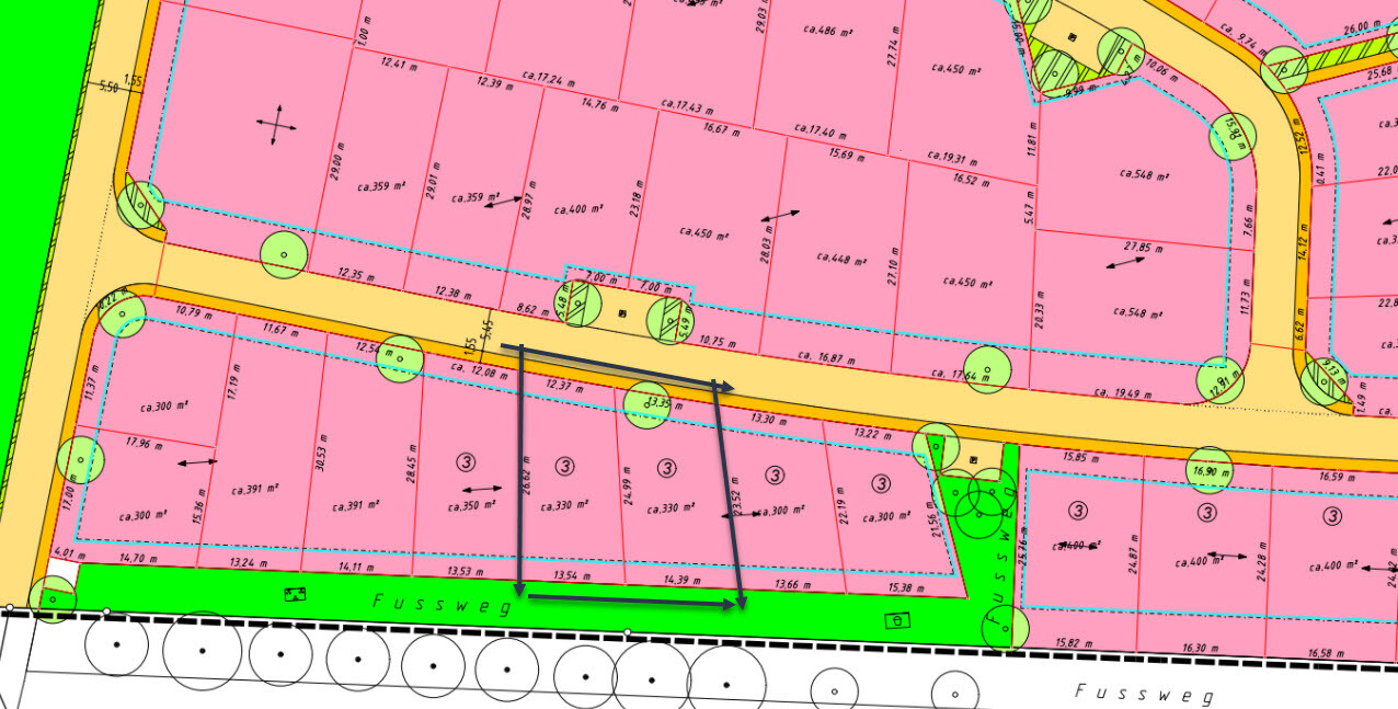

finally, we have reached an important step… the plot is signed for.
We want to build with an architect and already have some ideas about what we like and what we don’t.
We definitely want to give the architect the opportunity to apply their expertise regarding the floor plan… maybe they can convince us.
But if not, we are currently (almost) quite happy with this self-drawn floor plan.
A few key facts…
Plot size: 660 sqm (about 7100 sq ft), floor area ratio 0.4, no slope, approximately 26m x 25m (85 ft x 82 ft)
Longest building side allowed: max. 15m (about 49 ft)
L-shaped bungalow with covered terrace (southwest side)
We want to build with a basement. This should have windows with natural daylight behind the garage on the east side. There will be 2–3 living rooms down there (playroom, hobby room, later for the kids or grandparents if necessary).
The roof will not be converted into a living space — 20-22° (degrees) pitch, hip roof, for aesthetic reasons.
We know that a basement is more expensive than a second floor, etc. The budget is roughly 650,000–700,000 (currency).

Iotafreak6 Apr 2021 15:52Development Plan/Restrictions
Plot size 660 sqm (7,104 sq ft)
Slope No
Site coverage ratio 0.4
Floor area ratio
Building envelope, building line and boundary flexible, continuous building envelope
Edge development according to LBVO
Number of parking spaces 2
Number of storeys
Roof type hip roof, saddle roof, shed roof
Architectural style
Orientation south
Maximum heights/limits ridge height 6.5 m (21 ft 4 in)
Additional requirements
Architectural style, roof type, building type / angled bungalow, hipped roof
Basement, floors with basement
Number of occupants, age 4 / 36, 35, 4, 0.5
Space requirements on ground floor 4 rooms
Office: family use or home office? Family use
Guests per year 4
Open or closed architecture, open
Traditional or modern construction, modern for us
Open kitchen, kitchen island open kitchen, no kitchen island
Number of dining seats 6
Fireplace yes
Music/stereo wall no
Balcony, roof terrace, terrace
Garage, carport, double garage
Utility garden, greenhouse no
Other wishes/special features/daily routine, including reasons why certain things should or should not be included, see opening post
Designed by: Us
- Planner from a construction company No
- Architect planned Yes
- Do-it-yourself hardly at all
What do you like most? Why? see opening post
What do you dislike? Why? see opening post
Price estimate according to architect/planner: 650-700K
Personal price limit for house, including equipment: 700K
Preferred heating technology: gas boiler, underfloor heating
If you have to give up, which details/extensions
- Can be omitted: walk-in closet
- Cannot be omitted: covered terrace and all other rooms. The rest goes into the basement
Why does the design look the way it does now? For example:
Standard design from planner? No, inspiration from Vita Haus by Weiss
Which wishes were implemented by the architect? So far only our own drawings
A mix of many examples from various magazines? No, rather house visits
What makes it particularly good or bad in your eyes? Unknown
What is the most important/fundamental question about the floor plan in 130 characters? see opening post
