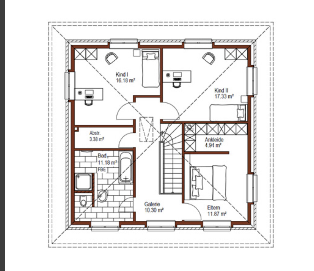

Boundary construction for the carport. This varies regionally...state building codes, local building regulations, written specifications or explanations...but you’re not building anyway Square, husband’s ideal concept.
Exterior dimensions 10.115m x 10.115m (33.2ft x 33.2ft). That was also the house he liked in the catalog.
However, the floor plan is somewhat different.
How would you orient this house? So I can get an idea.
If you want to join the floor plan discussion, it would be useful to complete the questionnaire.
For me, the floor plan would be quite unpleasant, but it may suit you and your requirements and be considered good.

By the way, one might wonder why a 17-meter (56 feet) deep plot is being developed with a 10-meter (33 feet) large house.
I would keep the hedge on the north side.
Just a thought.
