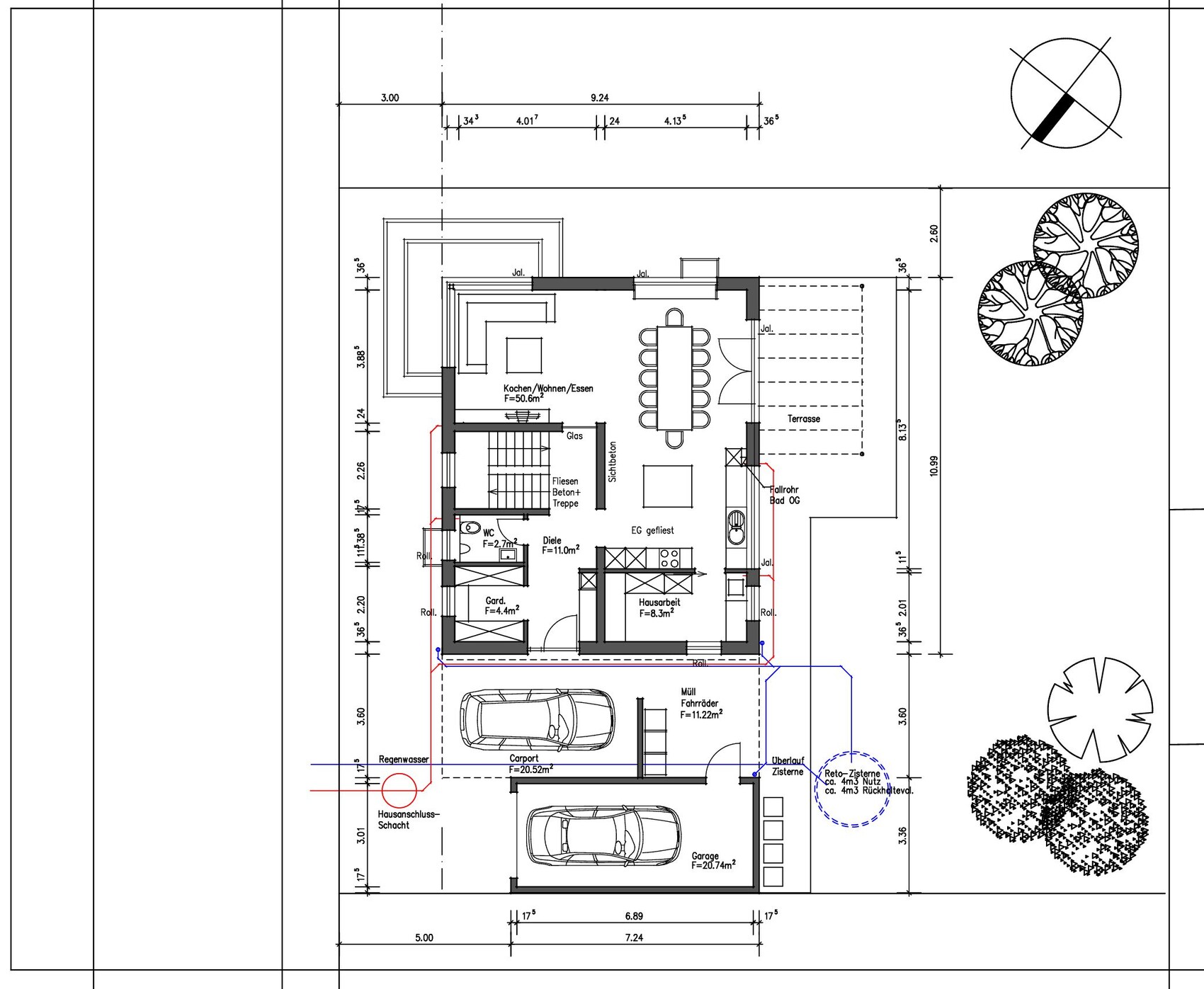

After following this forum for quite a while, our own project is becoming more concrete. We have secured a plot of land and have spoken with various general contractors and an architect. So far, my wife and I like the architect’s design best. It is still a draft plan, but it already feels very "right" for us.
Therefore, I would appreciate your feedback. Are there any critical points we might be overlooking? What could be solved more cleverly?
I hope I have included everything needed. If not, I’m happy to provide more information. Unfortunately, the basement is still the old version; it has now been mirrored and the light shafts have been slightly changed. You can see this on the ground floor plan.
Looking forward to your feedback!
Thank you very much! mini

mini_g! schrieb:
We asked the architect, and there wouldn't be any noise from the upper floor heard on the ground floor. But we were more concerned about the kids' bathroom.
For me, it's not about noise now, but about where to plan the drainage. Okay, in my case, there is a riser shaft hidden in the wall next to the stairwell. The kitchen is located below the bathroom, and you don’t hear anything.

22 Nov 2019 10:50
The path to the front door would be too narrow if a car is parked there.

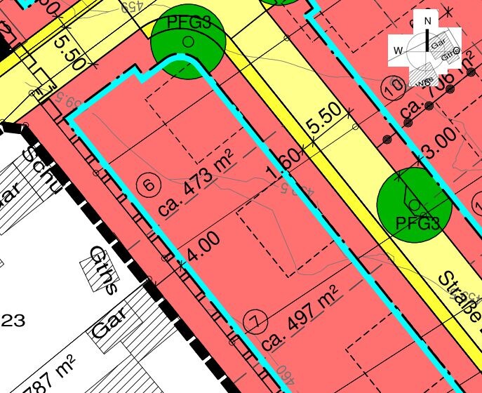

Could you share a site plan including the plot and street?
Sorry, everyone. The basement situation is unfortunate, but there’s no other way. In our opinion, the architect is doing a great job, and we want to give feedback after the next revision round. Otherwise, it would be too much back and forth.
I’ll try to upload the site plan and a self-mirrored basement plan shortly.
Thanks! mini

I already have a preliminary drainage plan, which I am going to revise. The wastewater pipes will partially run around the house.
The shafts are located once between the kitchen and the garden, and once near the entrance area. In my opinion, these can be well concealed or even integrated as room dividers.
hanse987 schrieb:
For me, the path to the front door would be too narrow if a car is parked there.
We share that concern. According to the architect, the carport could possibly be made 10 cm (4 inches) wider once the final land survey is completed and the setback distances are precisely calculated. We definitely want to take advantage of that if possible.
My sister has a similar design with a width of 3.50 m (11.5 feet). However, that carport is smaller and does not include space for bicycles and trash bins. There, the car is always parked in front of the carport, which we actually want to avoid. Our goal is to have enough space so that bicycles and trash bins can still be accessed beside the parked car.
Thank you! mini_g!
mini_g!
22 Nov 2019 11:58

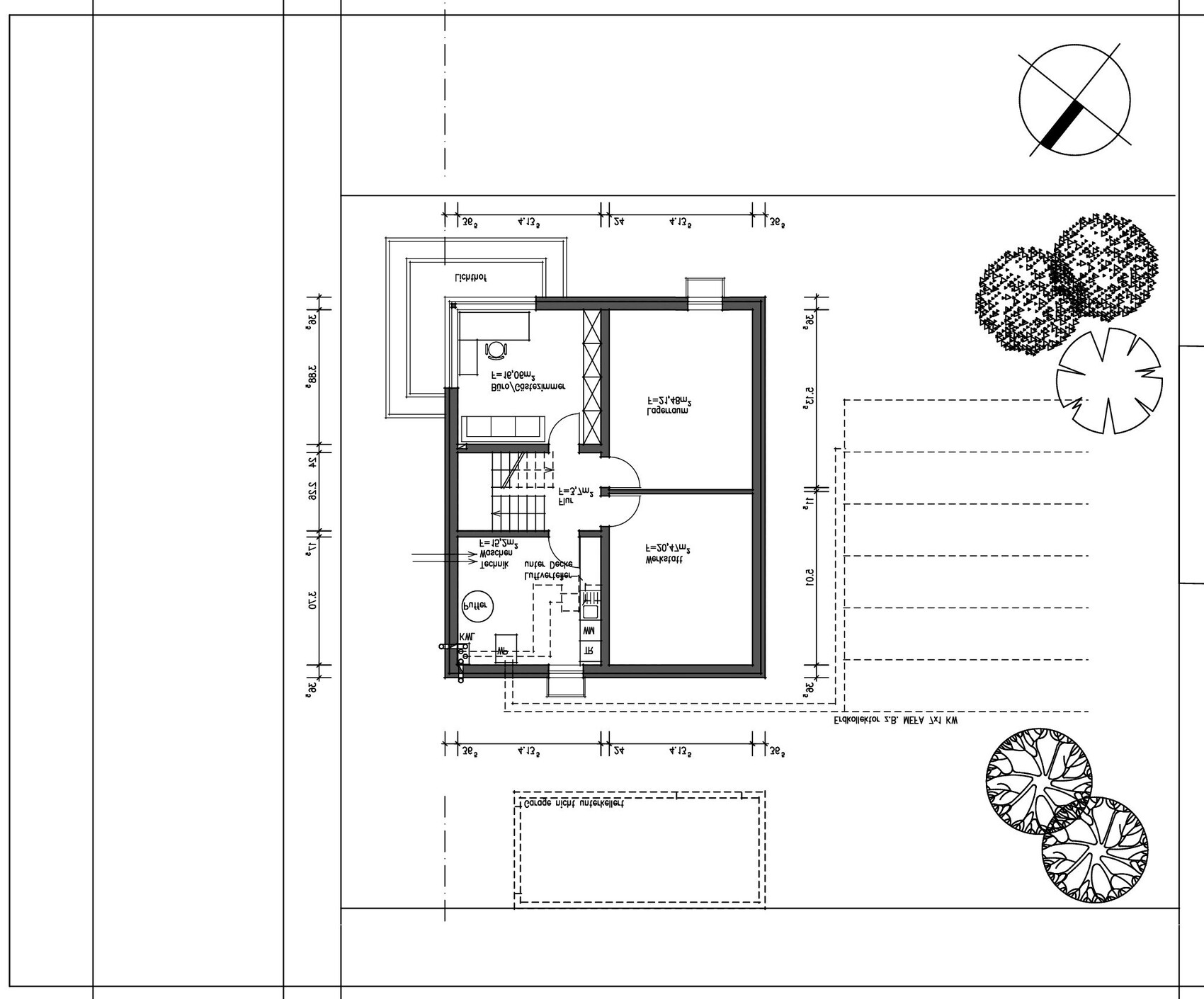

So, attached is the site plan, it is plot No. 7. The plan is oriented to north; I have added the north arrow.
I mirrored the basement plan myself once, but the north arrow is correct and not mirrored. The light well for the utility room has been moved toward the street, and I shifted the light well for the basement room using Paint...
In the drainage plan, the cistern has been moved into the garden. This was probably not avoidable due to the position of the inspection chamber for the sewer.
Best regards! mini_g!
