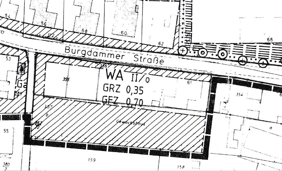

Our notary appointment is set, and I received the measurements of the plot yesterday.
My husband and I each prefer a different house type.
He favors a townhouse-style villa, while I prefer a gable roof with an elevated knee wall.
I’m attaching the measurements and the development plan, and I would appreciate your opinions on which house type would make the most sense, especially regarding the size, so that there is still a nice garden left.
Next Monday and Friday, we have two appointments with general contractors recommended by our circle of friends.
I want to be well prepared for the meetings, so nothing is “pushed” on me, and above all, to approach this process with realistic expectations!
I’m really looking forward to your recommendations!
Thank you
Plot size 389 sqm (4187 sq ft)
Sloping terrain
Floor area ratio (FAR) 0.35
Total floor space ratio 0.70
Edge development
Number of parking spaces
Roof type: not specified
Architectural style: not specified
Orientation: not specified

11ant9 Jan 2019 19:49
face26 schrieb:
Is the dashed line on the development plan not a building limit?
You seem to have noticed more than I did. I’m attaching a zoomed-in section from the PDF in the sales listing here:
Site plan: Plot on Burgdammer Straße with WA II/0, GRZ 0.35, GFZ 0.70

9 Jan 2019 20:27
face26 schrieb:
Is the dashed line on the site plan not a building boundary? At least, isn’t it described like that in the legend as well?
Yes, it is a building boundary, but
the plot is entirely within the buildable zone, except apparently in the north and west.

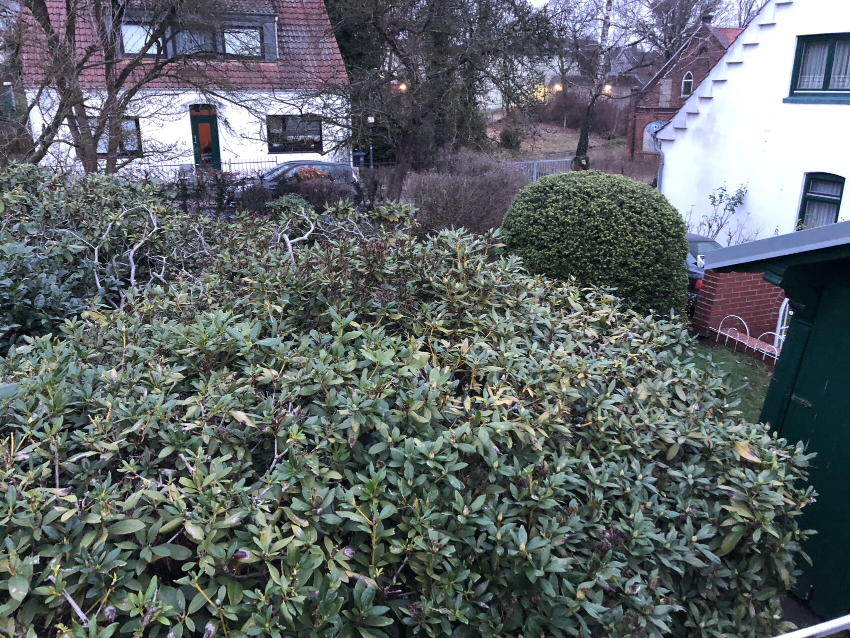

Yaso2.010 Jan 2019 16:44
RomeoZwo schrieb:
I just checked it out on Google Maps, and on the eastern side of the house, there is practically a full floor offset (due to the various extensions, it might be slightly less).
I took a picture before it got dark.
There is a staircase going up to the extensions. So, they are already positioned higher than the main building itself.
Where "our" boundary begins, it is almost level, or follows the slight incline of the street.
Parked Audi in front of a well-maintained garden fence, hedge, and stone steps next to the house.
Foreground of green leaves, a round spherical hedge in the garden, white houses in the background.
