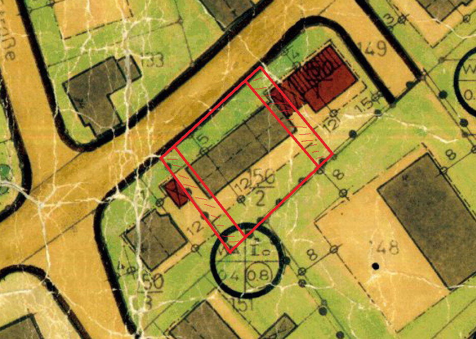

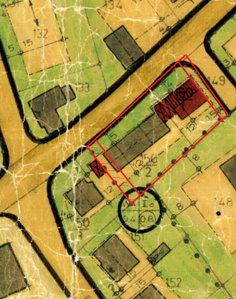

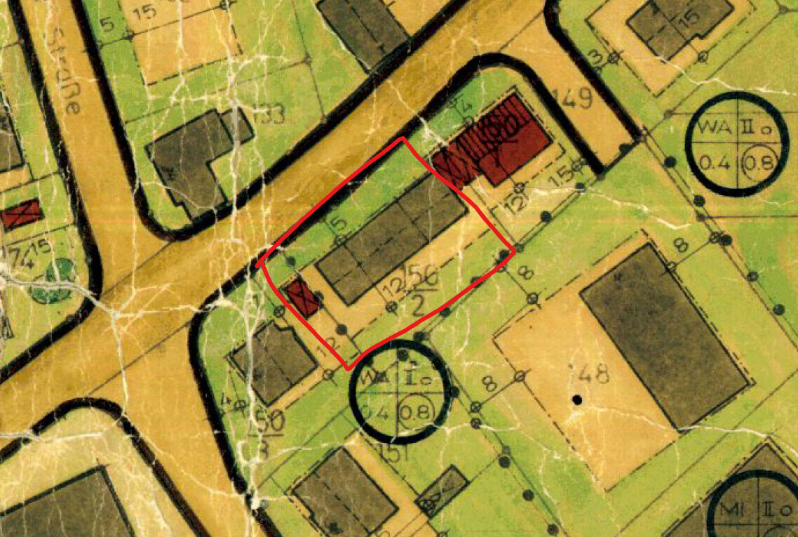

I have the following question.
My parents are going to transfer a plot of land to my sister and me, which directly borders their property.
I have marked this plot in red in the following development plan.
The plot and house northeast of the red boundary belong to my parents.
Currently, there are two garages and an old workshop on the plot. Once these are demolished, my sister and I want to build a semi-detached house there.
As I understand it now, there are building setback lines of 3 meters (10 feet) on both sides of the plot that must be observed (also in front and at the back, but these are not relevant to the question and therefore not marked). If a semi-detached house is built in the middle, a garage may be placed on one of the two setback lines, but the other side must remain free.
But how would this change if my parents’ plot were enlarged?
Would one of the building setback lines then no longer apply? Is that possible?
Basti

basti108822 Jan 2024 11:55Hello everyone,
Here are some details to help you better understand my thoughts.
Plot Dimensions
Unfortunately, I don’t yet have precise measurements from a surveyor for the plot. However, we have measured the width ourselves and found it to be approximately 25m (82 feet), with a depth of about 23m (75 feet) at the deepest point.
Assumption About Building on the Boundary
In an initial conversation with Bien-Zenker nearly two years ago (the project with the company has since been discontinued), we were told that for a semi-detached house, only one building boundary can be built on, not both sides. Given the advisor’s competence, though, I suspect this information might have been incorrect… Who should I contact to find out what is allowed and what is not? Would I get this information from the building authority / planning office?

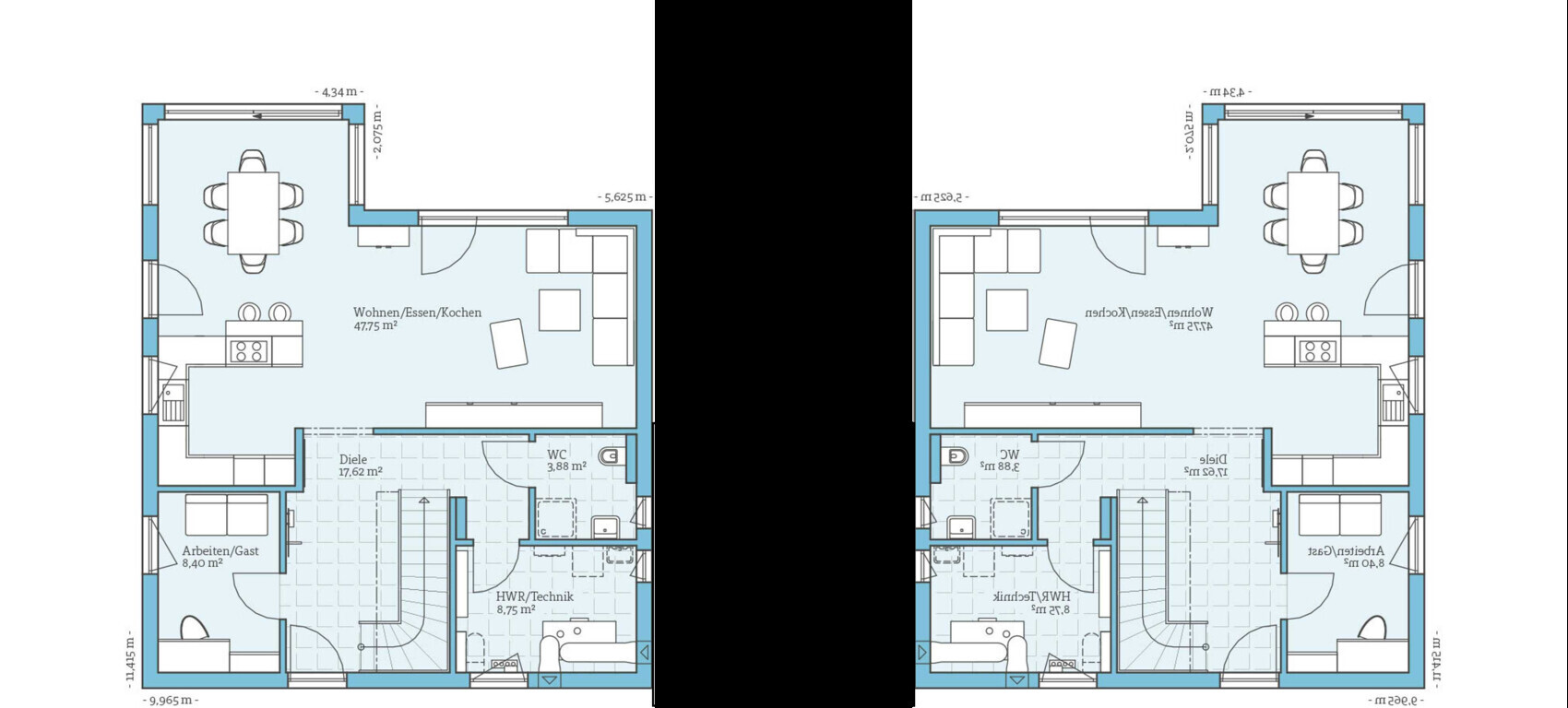

At the moment, we have fallen for a design from Hanse Haus. We might simply build two units based on this design, mirroring the second one, so that the final layout looks like this:
Together, the two halves would have a width of almost 20 meters. However, fitting a garage or carport on either side would become quite tight. But as I said, this is just an initial idea.

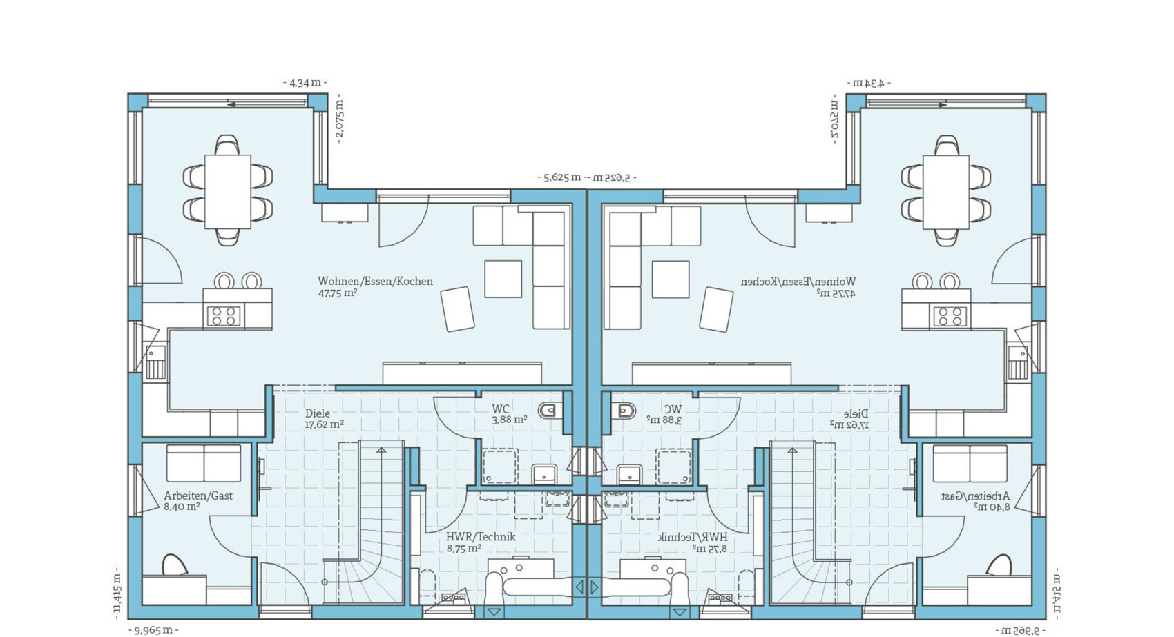

WilderSueden22 Jan 2024 12:03You can’t just take a floor plan for a detached house and simply join them together. In a semi-detached house, you lose the windows on one side, which affects the rooms. Try connecting the upper floors as a test and tell me where the light in the bedroom and bathroom is supposed to come from.
Besides that, I wouldn’t place the bay windows on the outside of a semi-detached house. That forces you to put your terraces right next to each other, leaving you with no privacy at all.
basti108822 Jan 2024 12:06WilderSueden schrieb:
You can’t just take a floor plan for a detached house and simply join them together. With a semi-detached house, you lose the windows on one side, which affects the rooms. Try connecting the upper floors for a test and tell me where the light in the bedroom and bathroom is supposed to come from.
Besides that, I wouldn’t put bay windows on the outside walls in a semi-detached house. That forces you to place your patios right next to each other, leaving zero privacy. I understand that you still need to consider the windows.
I was initially only concerned with the shape and size.
In the end, the bay windows are a matter of taste. Either one party has their garden open to the parents, or they open onto each other.
basti108822 Jan 2024 12:13W
WilderSueden22 Jan 2024 13:41The problem is that it’s not just about the windows. If you remove windows from one side, some floor plans can no longer be used. That’s why floor plans for semi-detached houses are somewhat different. Additionally, there is the issue of orientation. Yvonne already mentioned this in #20. With two identical halves, you will clearly end up with one more attractive side and one less attractive side. A semi-detached house doesn’t mean that both halves have to be the same. However, you can only carry out the planning process once you have gathered the requirements and then discuss specific house designs. If you start throwing around detailed floor plans right away, you skip important planning steps.

We would possibly just build this twice and mirror the second house, so that in the end we have the following floor plan. That won’t work.
basti1088 schrieb:
I was mainly referring to the shape and size. That doesn’t work either.
