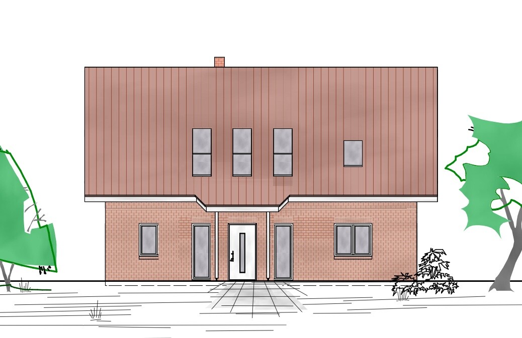

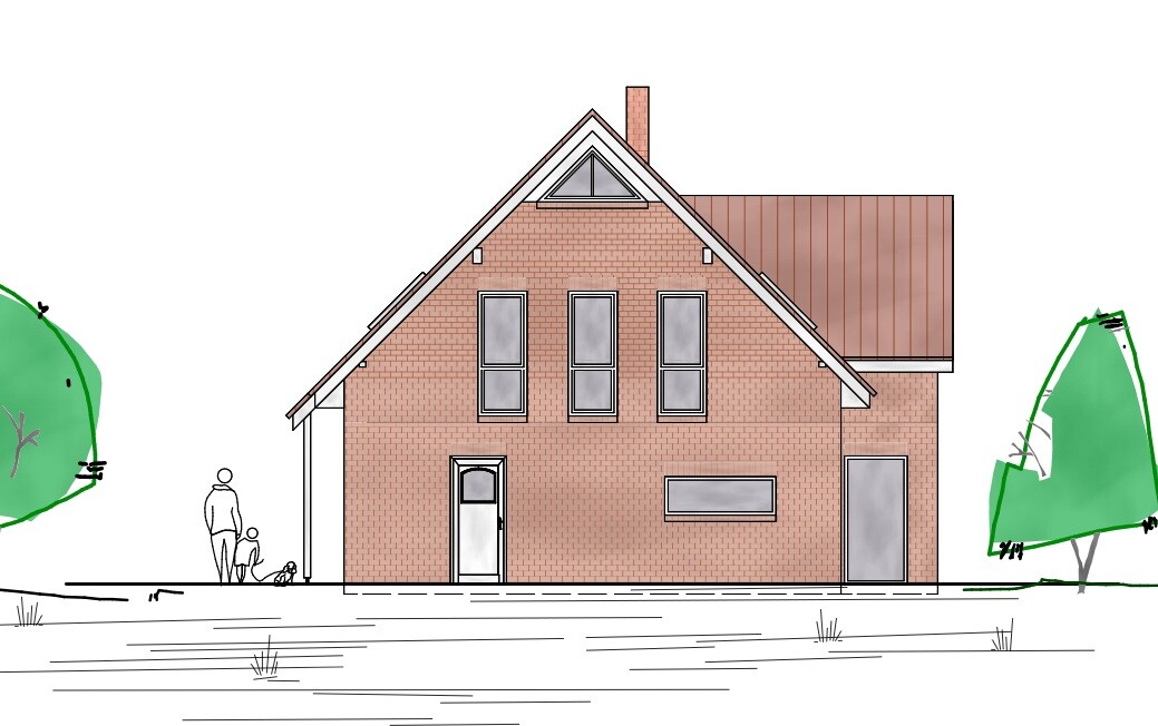

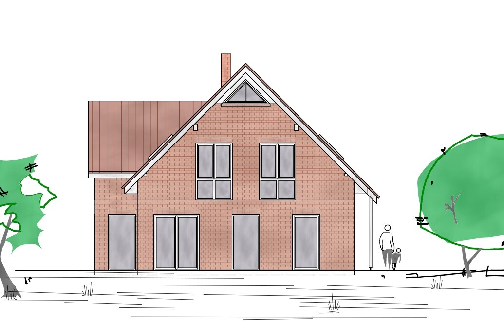

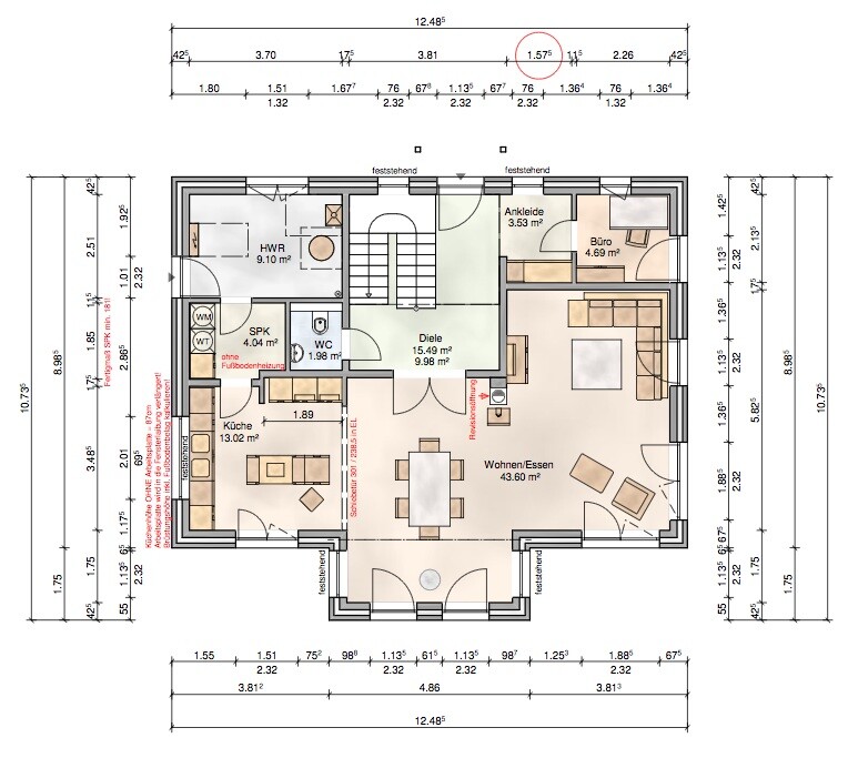

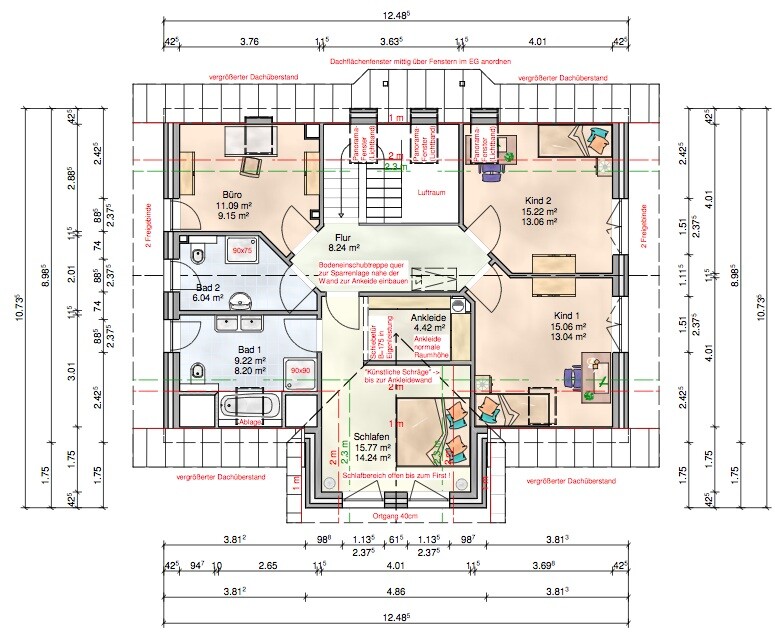

we are a young family from Hamburg who recently bought a plot of just under 650 sqm (about 7000 sq ft) in Hamburg (see site plan).
We have designed our future home ourselves after visiting many show homes, but we are still uncertain about a few points and would like to get your opinion on them:
1. Criticism of the floor plan and the house’s position on the plot is welcome
2. We would ideally like a basement. However, since groundwater starts at about 1.30 m (4 feet) depth and according to the soil report a closed water retention system plus a waterproof bathtub structure (white tank) would be required, the cost for a basement would come to about 80,000-90,000 euros. That’s really too expensive, isn’t it?
3. We have considered that since we do not have a basement, we could better use the utility room by moving the heating system, hot water tank and ventilation system from the utility room to the attic. What do you think of this?
This is our first post, but we have already read a lot in the forum and found many good tips. Now we would appreciate some suggestions.
Thank you very much for your help.
Floor plan of a single-family house: kitchen, living/dining, utility room, WC, hallway, office.
Attic floor plan: office, bedroom, bathroom, walk-in closet, 2 children’s rooms, corridor, stairs
Two-storey house with red tiled roof, brick walls and central entrance.
Two-storey red brick house with large windows, tree on the right, adult with child next to it.
Brick house with brown roof, central gable facade, large glass fronts; family in front
Red brick house with gable roof, left door, three upper floor windows, tree on the left, people in front.

I noticed the following:
- Interior toilet
- Many 45° corners
- 4.5 m² (48 sq ft) office ?!
- Path to the kitchen is quite long – or if you don’t go through the utility room, the route to the pantry is way too long
- Very limited space for the walk-in closet
- Don’t really like the position of the shower in the children's bathroom
- Children’s bedroom facing north ?!
- Living room facing north ?!
- Utility room etc. facing south, or is the layout mirrored ?!

13 Apr 2015 21:30
Washing machine and dryer in the pantry? Otherwise, nice floor plan. For a dedicated office, this should be sufficient; looking at my own small desk area in the dining room, I have less space. I like the upper floor; for the kids, I would avoid these angled entrances. I just noticed you still have a large office. Is that intended as a guest room or a third bedroom? Then it would be smaller than the others. 15 sq m (160 sq ft) is okay for a children's room.

13 Apr 2015 22:54
Wow, you reply quickly.
So:
A guest toilet without a window was more important to us than an office without a window.
The office is small and more of a backup in case we have three children (two are planned), and the office on the upper floor would then be used as a third bedroom. We can also imagine converting the guest toilet on the ground floor into the office.
The many 45° angles on the upper floor were necessary for the doors due to space constraints; unfortunately, we couldn’t come up with another solution.
The walk-in closet offers significantly more floor space than we currently have, although bigger is always better.
The bathrooms are not fully furnished yet; we plan to take care of that in the next few days.
The roof must be parallel to the street. Flipping the house is possible, but the neighboring lot’s development to the south is quite close. When we stood on the site, we found the current orientation somewhat better.

13 Apr 2015 23:22
If the children want to take a bath later or do not want to use the small shower, they always have to walk through the bedroom...
