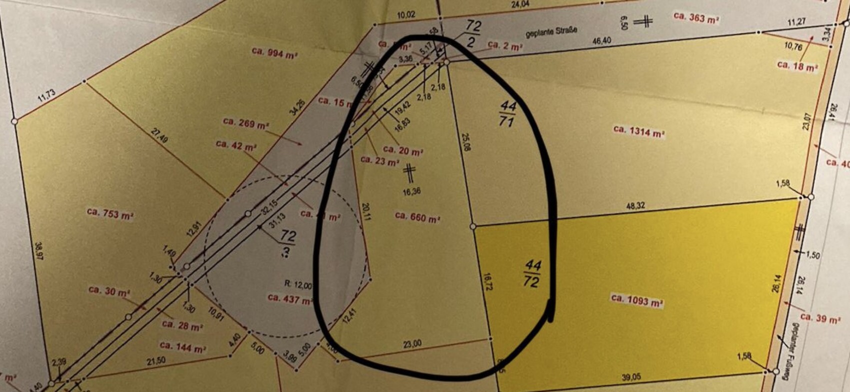

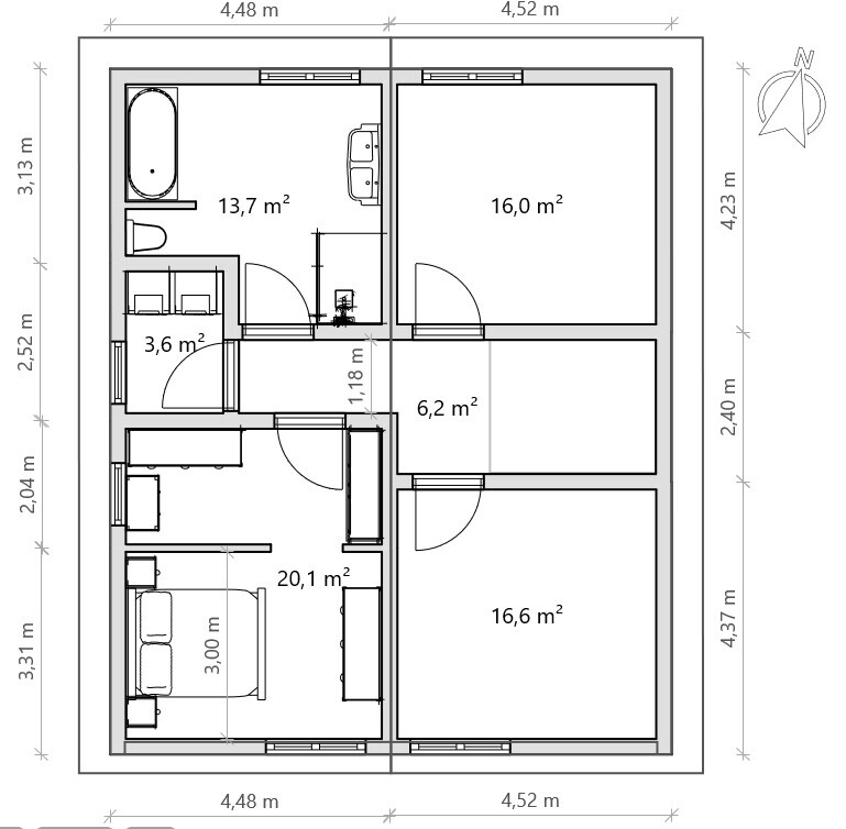

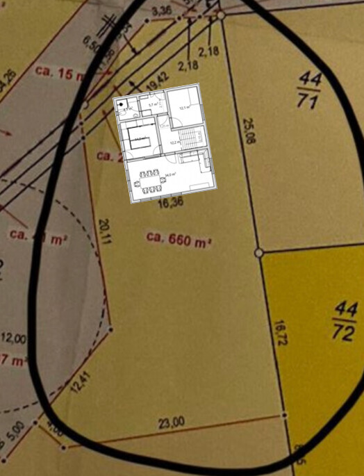

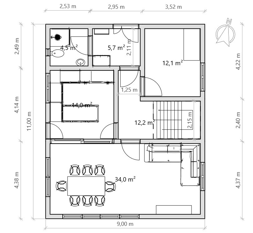

We are just at the very beginning of our housebuilding journey. So far, we have gathered information, visited houses, and mainly thought about the requirements we have for our future home. We have tried to incorporate this in the attached floor plan. Not everything is perfect down to the last detail yet; it is mostly about the basic layout and such. We already own the plot (see photo, north is at the top). The house should be positioned as far northeast as possible.

- Basement stairs unfortunately not in the vestibule
- Bathroom on upper floor not clearly divided into wet and dry areas

hanghaus20232 Jan 2025 20:07Here is the site plan. Without a building permit / planning permission, it is difficult to provide proper advice.
The budget is too low for approximately 170m2 (1830 sq ft). Is a basement really planned? If so, you are easily short by 150,000.
If you remove the basement and reduce the size to 130m2 (1400 sq ft), then it might just fit.

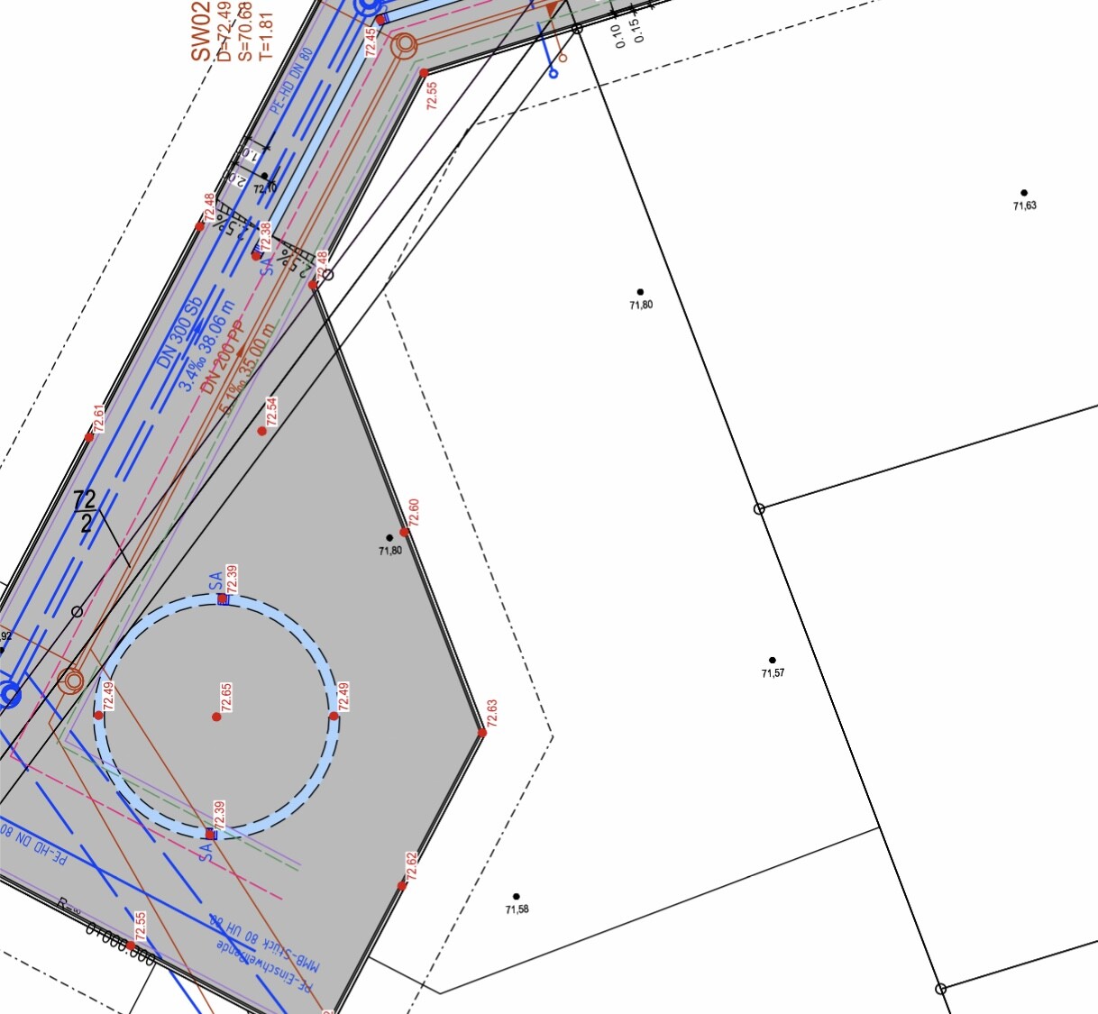

hanghaus20232 Jan 2025 20:12Please show the heights within the building envelope and on the property.

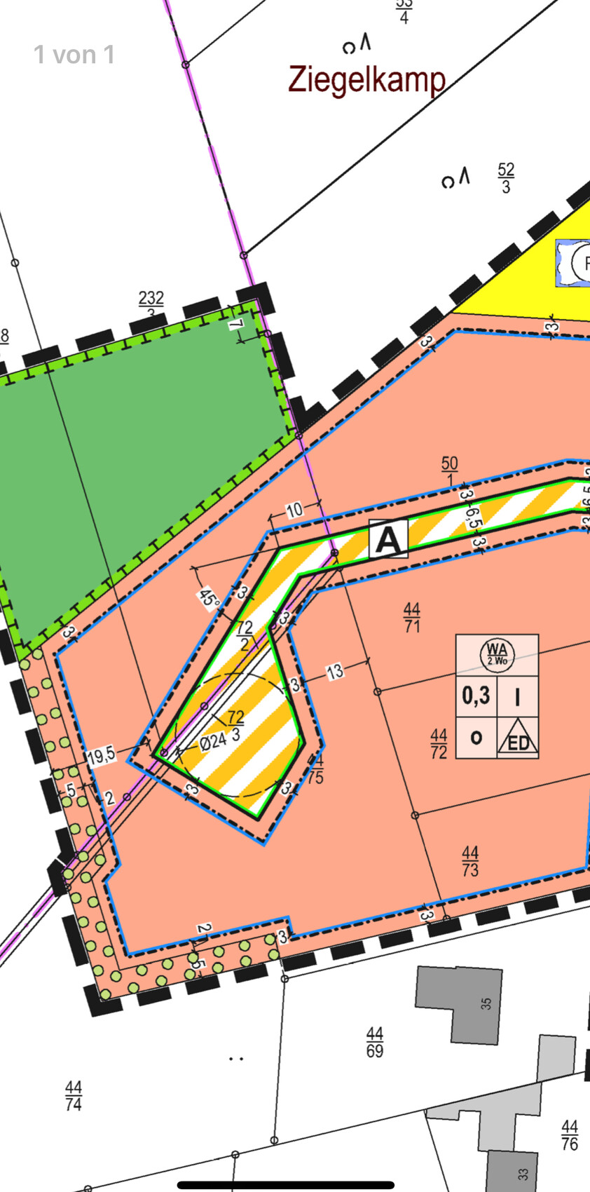

Could you please show the building envelope and the zoning plan? What is that to the north? Are the three lines an overhead power line? With 16m (52.5 feet), the lot is quite narrow. That leaves little space on a 660 m² (7,104 sq ft) lot.
Hi
Hi & thanks for the quick reply!
The three lines at the top indicate a division into small parcels. These have now all been merged into one lot of 719 m² (7,736 sq ft). There are no power lines or anything similar.
Attached is the current zoning plan from the city. Unfortunately, some property boundaries are still missing here. This is less important for the planning since the house is intended to be placed toward the north. The blue line shows a 3 m (10 feet) setback from the street, where no construction is allowed. A 3 m (10 feet) distance must also be maintained from the neighboring lots, which results in a building envelope 10.36 m (34 feet) wide. So yes, at 16 m (52.5 feet), the lot is definitely rather narrow.

Flowerstone2 Jan 2025 20:18hanghaus2023 schrieb:
Could you please show the heights within the building envelope and on the plot?Here are the measured heights again:Similar topics
