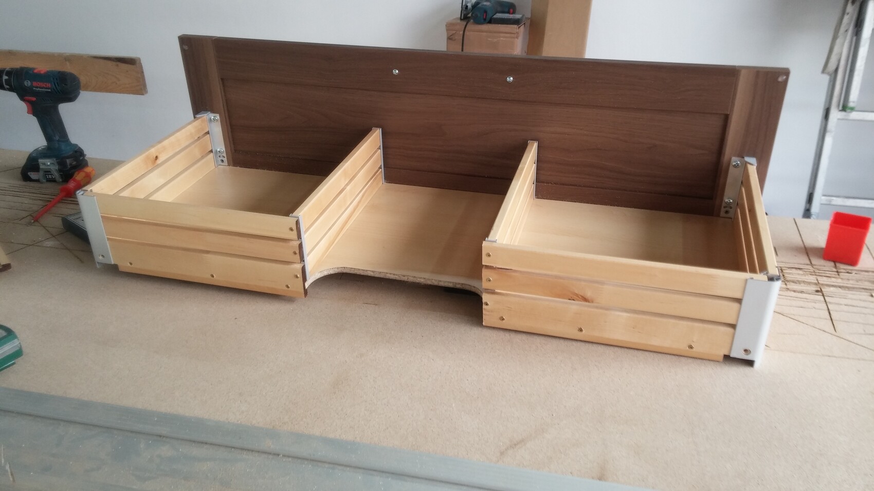

Hi Johnyy,
the problem will be the trap and/or the connections.
Behind the bottom drawer of the GODMORGEN with a width of 100cm (39 inches), you only have 10cm (4 inches) of space. If you shorten the cabinet on the sides, which is basically easy to do, then nothing can be installed in that area—no drain, no angle valve, nothing.
The drawer above is shorter, but you will still have to modify it.
Last week I remodeled my 100cm (39 inches) Godmorgon because I didn’t want to install the IKEA trap with the low-quality drain plate; instead, I chose a push-to-open drain fitting. Overall, with the connection for the overflow, I ended up so low that I had to rebuild it.
(Last cut with the blade. Edge sealing was free)
