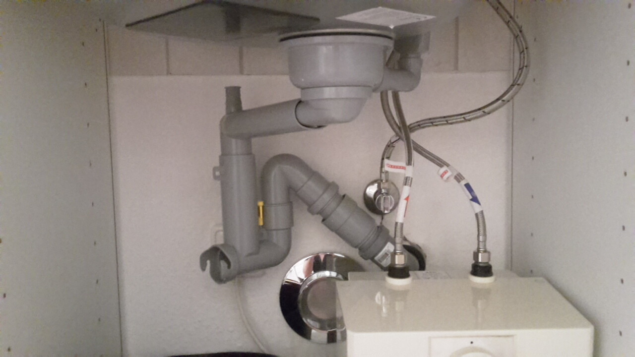

I’m not building a house, but since I couldn’t find a better forum, I hope you can still help me.
Here’s the situation in the kitchen:
- I replaced the sink and the trap
- Since then, the water drains very slowly (a full basin takes 2-3 hours to empty)
- If water is poured directly into the wall drain, it drains normally
- If the trap is not connected to the wall but drains into a bucket, the water also drains normally
- Before the renovation, everything worked perfectly
What am I overlooking?
Thank you very much for your help!
MoeGT schrieb:
Could the 90° elbow possibly be inserted too far into the wall/drain?New idea what the cause might be, but unfortunately no. tomtom79 schrieb:
Or is your wastewater pipe not vented?I can’t judge that as a layperson, but previously the predecessor model of LILLVIKEN was installed without additional venting, and with that, the water always drained without any problems.Thanks very much for your efforts in any case.
