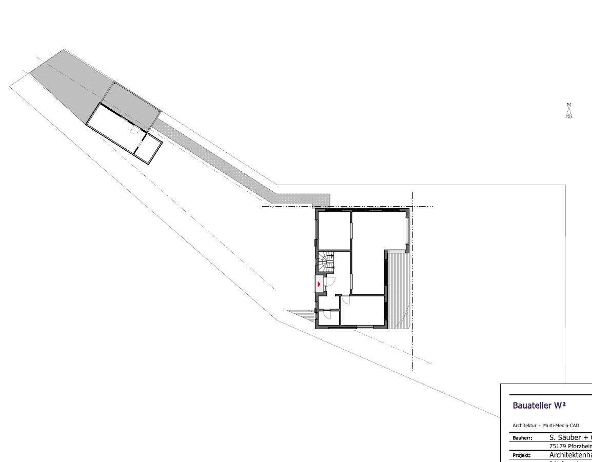

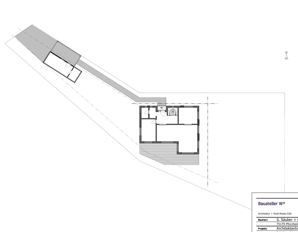

arnonyme
8 Jul 2017 15:35
kaho674 schrieb:
Isn’t the house positioned the wrong way? The cozy corner is at the bottom left of the plan. Or is the plot so narrow that it only fits this way?
Take a look at the overview.
The dashed lines represent the building envelope / building boundary.
Everything is quite tight here. There really isn’t much room for flexibility.
Architectural floor plan of a house with driveway and terrace
kaho6748 Jul 2017 18:31
Oh my goodness. Okay. But honestly, don’t you think your house is facing the wrong way? Setting aside whether it fits within the building envelope or not. Now, just take the house and rotate it. You immediately think—yes, that’s how it should be. That would be ideal.
In my opinion, this has to do with the fact that it wasn’t designed specifically for your plot. To me, it looks more like the architect took a standard design off the shelf and simply placed it there. Maybe rearranged the rooms a bit, and that’s it.
Don’t get me wrong, I think the house is fine. But not for you.
I’m just saying, 800,000 euros.
2D Grundriss eines Hauses mit Treppenhaus und Außenbereich auf Hanggrundstück
arnonyme
8 Jul 2017 19:56
You should consider the house in relation to the plot. Then the 800k is actually almost too little.
But why rotate it?
Living room facing east?
As it is now, it faces south.
If you also include the terrace on the garden side, it looks quite different.
