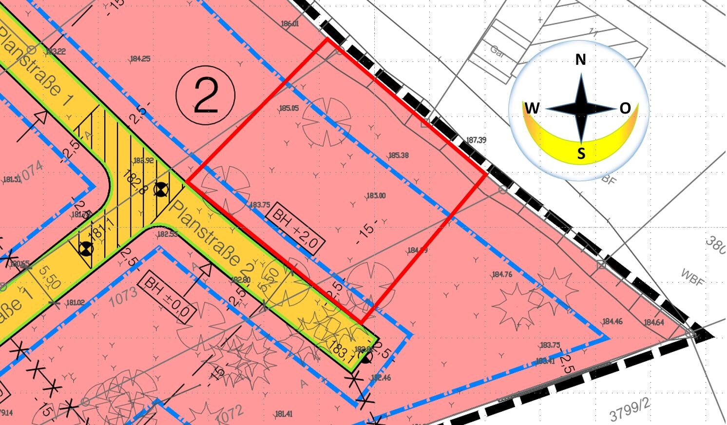

How would you arrange the house, main entrance, and double garage?
What do you think is okay about the current plan and what is not?
I’m really curious to hear your thoughts :-). Thank you very much in advance!
Plot size = 650 sqm (7000 sq ft)
Slope = South, approx. 12.5% incline (rising from the street level)
Floor space index (FSI) = 0.4
Plot ratio = not specified
Building envelope, building line, and boundary = the plot is marked in red in the graphic below; the building line is shown with a blue dash-dot line
Edge construction = garage may be built on the property boundary; the house must have a 2.5 m (8 ft) setback
Number of parking spaces = 2
Number of stories = 3 full floors, i.e. basement + ground floor + upper floor
Roof type = tent roof, hipped roof, gable roof, or offset shed roof
Orientation = see plan below
Maximum height limits = street level is zero reference; max. wall height 9 m (30 ft) and max. ridge height 11 m (36 ft)

nordanney16 Dec 2024 08:47Bau_Rookie schrieb:
How would you arrange the house, main entrance, and double garage?Without floor plans, it’s impossible to say.Some information is missing, such as details about the neighbors and the floor plan.
I doubt that the garage is allowed outside the building line.
Are you planning to build a basement + ground floor + upper floor?
Is the terrace really supposed to be that high?
How did you plan the garden access?
I have the impression that you have not yet been in contact with an architect. In my opinion, this is essential for this plot.
For clarification: the blue line is likely not a building line but a building boundary. A building line requires construction directly on it. Usually, there is only one such line, which defines the boundary along the street. In your case, you have a building area on a sloped plot. The front part facing southeast is flat, then the land rises towards the west and north.
In your drawing, the third dimension does not seem to be considered at all. It would imply that you are placing the garage into the slope, with the basement being open to the southeast, where the entrance would be located.
I don’t think your logic properly accounts for the placement of the garage.
I also don’t believe your ideas are suitable for a sloped site.
Yes, the slope clearly calls for terrain modeling and, at first glance, a partially open basement. However, with the simple room requirements you provided—limited to ground and upper floors—this cannot be properly planned. The basement level is missing entirely.
At this point, I also do not see a city villa, neither from the 2D drawing nor fundamentally.
That said, it can be done with some restrictions.
To put it bluntly, since many details are missing: place the garage as close as possible to the street, and then juggle the space program and the slope so that you can create something affordable.
At this moment, I definitely would not recommend requesting quotes from construction companies before an architect has worked on the design and visited the site.
