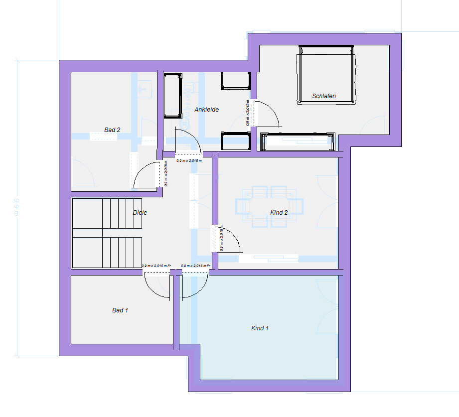

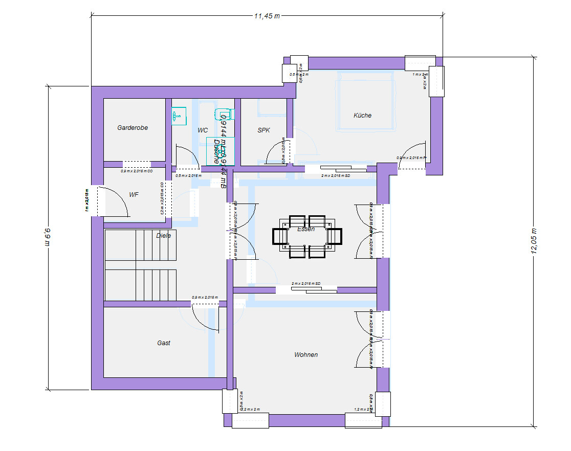

I have to admit, the plot is really tricky. You have to swallow some tough pill.
I’m not an architect, so I’m just tinkering around. After endless trial and error, I only came up with a design that includes 2 kids’ bedrooms, which just fits into the building envelope.
So – humble me – the design might not be as bad as I initially thought.
I’m sharing the alternative 2-kidroom version here anyway for gathering ideas.
I started from the so-called Bauhaus style – where almost anything goes. Whether it can actually be built, I don’t know.
[I should mention that my software is quite outdated and can’t display everything. Although I’m usually not a fan of corner windows, they make sense for this plot to bring sunlight into the rooms. But the program can’t handle that. Also, to be lazy, I always leave out windows that aren’t problematic.)[/I]
Schematic floor plan of a house: kitchen, dining, living, guest room, hallway, wardrobe, toilet.
Floor plan of a house with bedroom, bathroom 1, bathroom 2, hallway, dressing room, child 1 and child 2

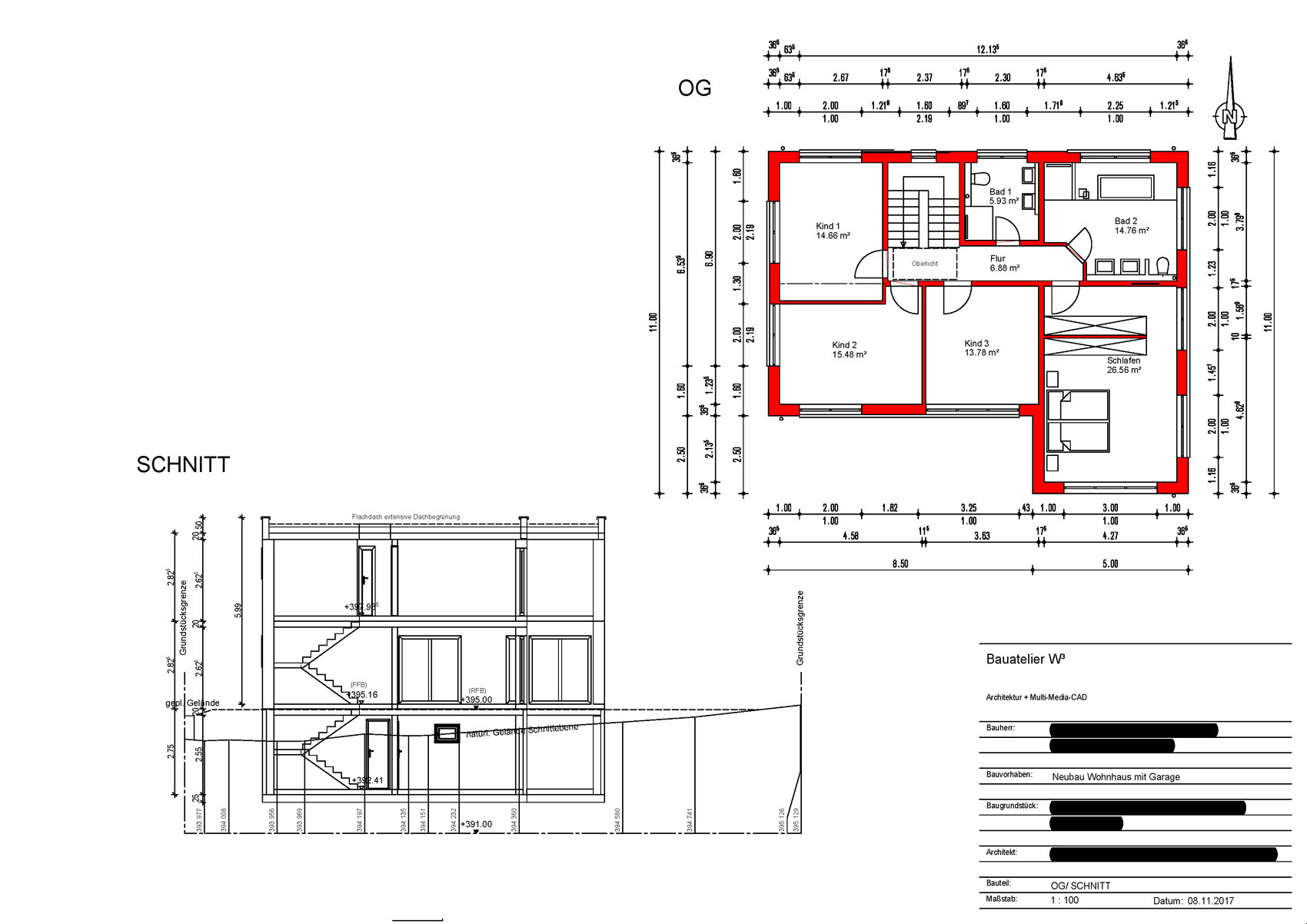

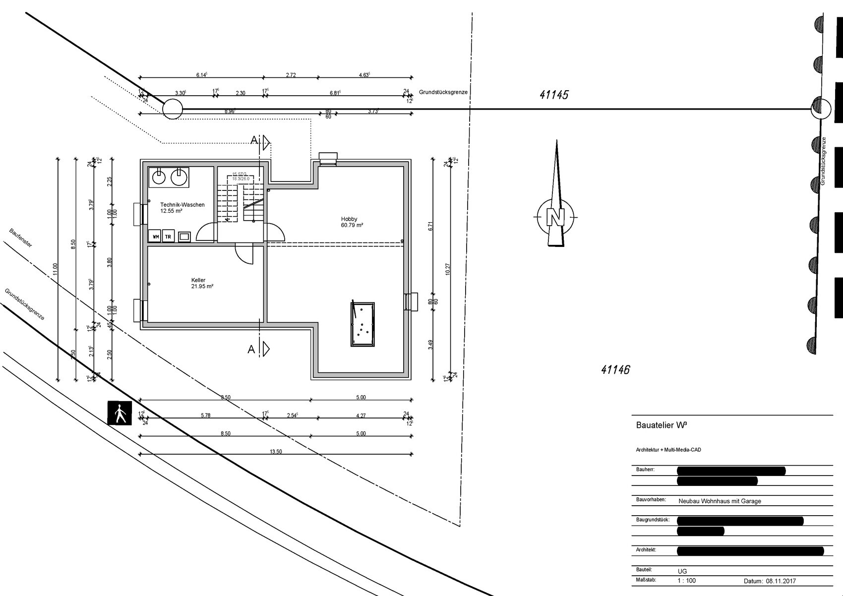

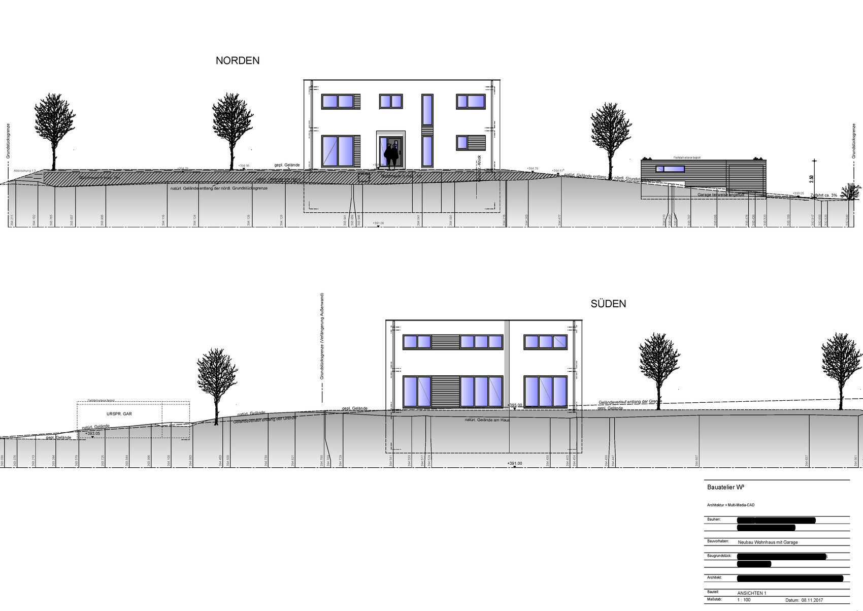

Hello kaho674,
thanks again for your input. We were finally able to implement the ideas after an internal change of architect. Unfortunately, we couldn’t start from scratch, as the city gave us a deadline to submit the plans by next week. We tried to make the best of the ideas.
We actually like your ideas a lot, except for the hallway on the upper floor, which seems quite narrow to me.
Do you think it should be widened?
It is only 105cm (41 inches) wide. Is there a minimum recommended width to avoid feeling too cramped?

Floor plan of a house with basement, technical/laundry room, hobby room, staircase and dimension lines
Upper floor plan: Children 1-3, bedroom, bathroom, hallway; scale 1:100
Modern villa with north and south view on sloped terrain, trees and garage.
East and west elevation of a modern house on a hillside plot, trees and detail lines.
tomtom799 Nov 2017 16:14
This floor plan still has a lot of potential.
If you swap the staircase in the ground floor, the WC wouldn’t be hidden, and upstairs you would have a clear separation between the children’s bathroom and the main bathroom.
arnonyme
9 Nov 2017 16:22
If you swap the staircase on the ground floor, the toilet wouldn’t be hidden, and upstairs you would have a clear separation between the children’s bathroom and the main bathroom.
The staircase was originally swapped. The problem with that was that the connections in the basement would have been at the very back, which wouldn’t have been cost-effective. In addition, this way the children’s rooms are now significantly larger.
