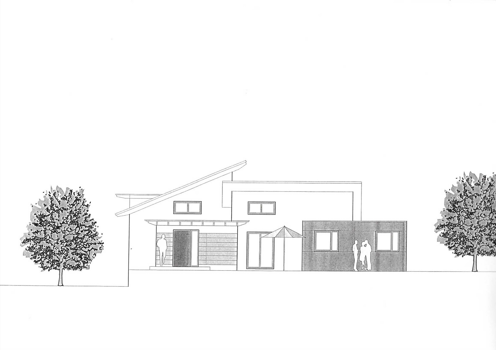

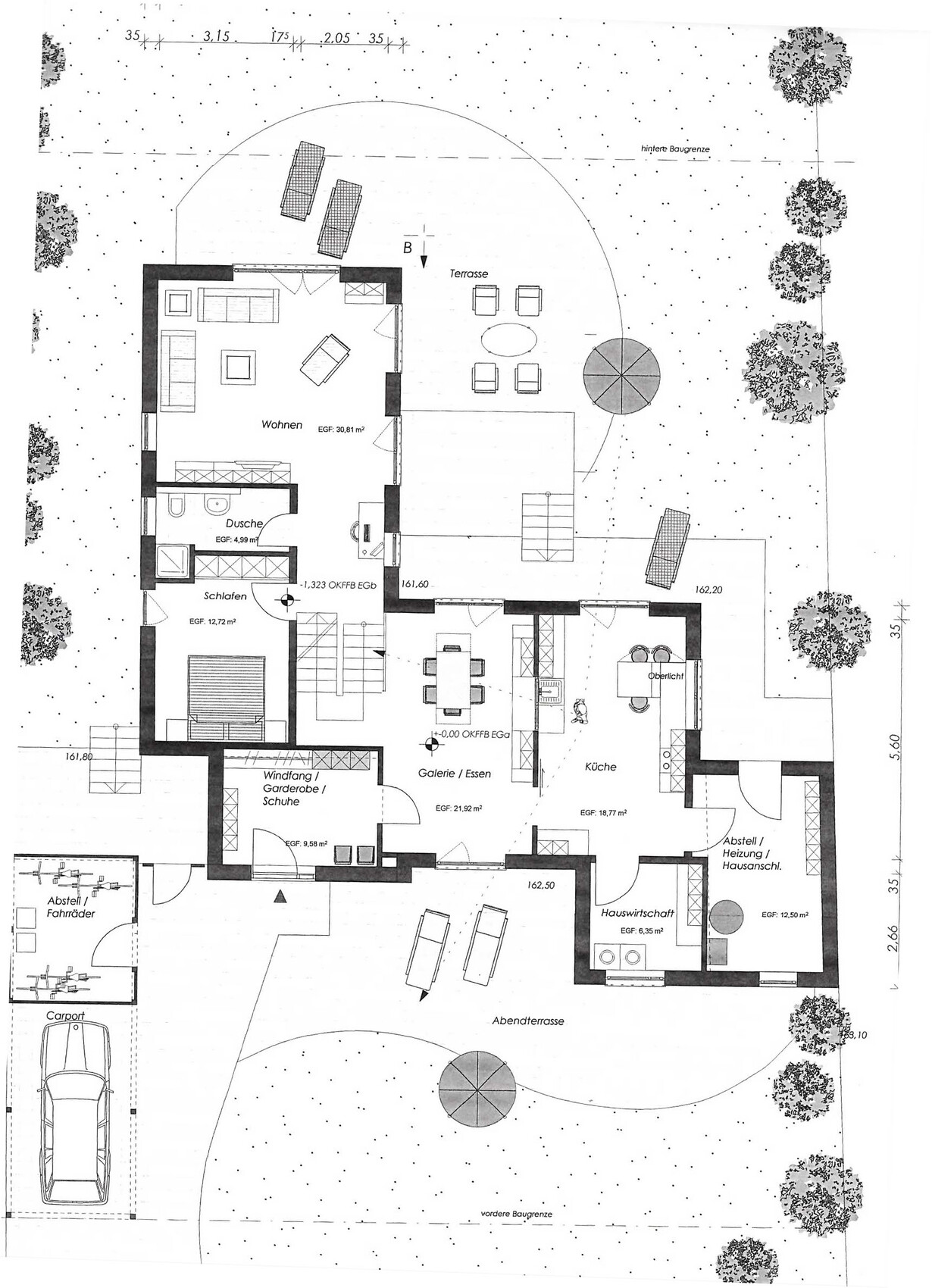

unfortunately, I only just managed to scan the floor plans. It would be great if you could take a look and give me some feedback, including whether you like it or what could be done differently, as well as your thoughts on the architect’s quoted price. This is just the first draft, and it definitely still has potential for improvements.
A brief explanation: the plot faces northeast and has a slope, which is why the evening terrace is planned at the front. The architect’s idea for the one-story right wing, which includes the kitchen, dining area, and utility rooms under a shed roof, is to allow sunlight to reach the northeast garden from the southwest side.
The master bedroom, bathroom, and living room are located on the lower level due to the sloping plot.
What I don’t like:
The master bedroom feels a bit small or needs a walk-in closet for the wardrobe. The kitchen could be smaller because the dining area is large and right next to it. Also, the passage to the utility rooms through the kitchen is not ideal in my opinion. The living room space marked for the PC seems somewhat wasteful, probably due to the staircase. Upstairs, the bathroom feels a bit small, and the hallway seems too large, likely because of the half-landing staircase. The entrance area, including the vestibule, could be smaller in my view. The problem is that we still need to fit a guest room/office into the floor plan without increasing the overall footprint.

toxicmolotof8 Apr 2015 09:07Isn’t the kitchen a bit too large? And the furnishings are probably just an example?
Please try planning a practical kitchen in the room... if the attempt fails, no problem. With that size, you’ll a) spend a fortune and b) get tired quickly. Walking distances are too long.
What I do like is the overall low amount of dedicated circulation space.
Also, the layout placing the children’s rooms upstairs while living almost on the ground floor is a plus. This makes it easy to create a separate "living unit" for the children upstairs. Unfortunately, this area cannot be completely separated later on to, for example, rent it out after they move out.
Thanks in advance for the feedback. The wall construction is not finalized yet. For now, the plan includes 17.5 cm (7 inches) brick plus external thermal insulation composite system (ETICS). What do you think about the room sizes? A 15 m² (160 ft²) children’s room should be fine, right? Ideally, we would like the master bedroom upstairs as well because when the kids are small, having the separation as it is now isn’t ideal – but it makes more sense for later. However, I think that will be hard to achieve with the current floor plan.
As I mentioned, the kitchen is too big because a table was planned there that we actually have in the dining room. Also, as I said, we still need a guest room somewhere.
