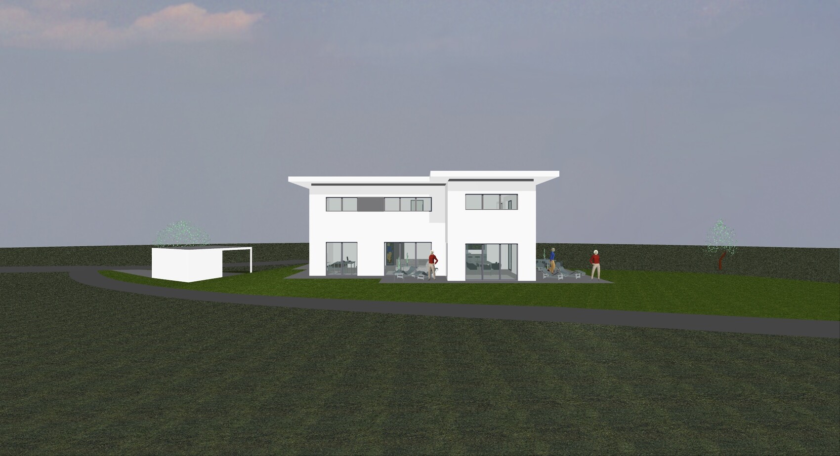

11ant21 Jun 2017 15:26
Curly schrieb:
visually, your house looks like an office building in an industrial area.
Oh, I hadn’t really noticed that a month ago: the wing with the bedroom suite, with its three identical windows evenly spaced, resembles an office above a row of three wide single garages. By simply breaking up this "machine-stamped" rhythm of the windows, you could add some "liveliness" without incurring extra costs.
The overall work of this architect strongly reflects a self-perception as an intellectual artist (with experience in commercial construction, a rare combination).
arnonyme
21 Jun 2017 16:08
Oh, I hadn’t really noticed this a month ago: the section with the bedroom suite, with its three identical windows equally spaced, resembles an office above a row of three wide single garages. By simply breaking this "machine-cut" rhythm of the windows, it would be possible to add some "vitality" without extra costs.
It was actually different. The architect sent something incorrect.
Originally, it looked like this:
Modern white two-story villa with glass fronts, terrace, and garden; people outside.
