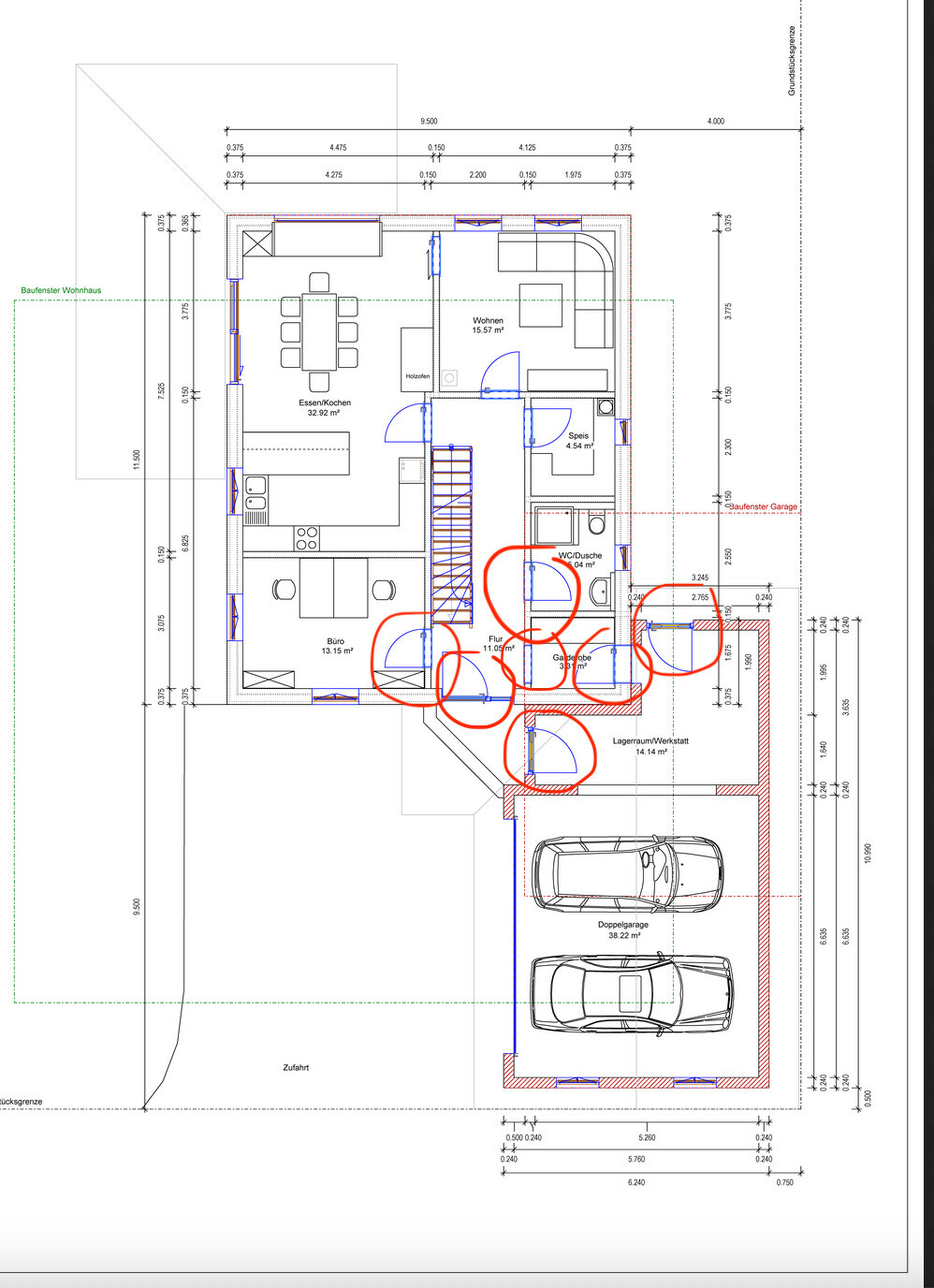

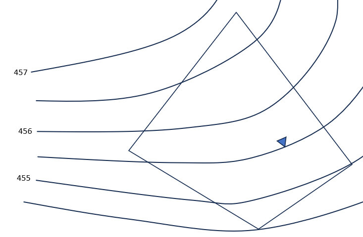

Bruno492Hello everyone,
Until now, we have been silent readers and would now like to share our current planning status. We are planning a single-family house with a basement. The current plans are initial drafts that incorporate our requirements and wishes. We hope that some of you can provide appropriate feedback.
The development plan is oriented to the north, meaning the house is rotated about 45°.

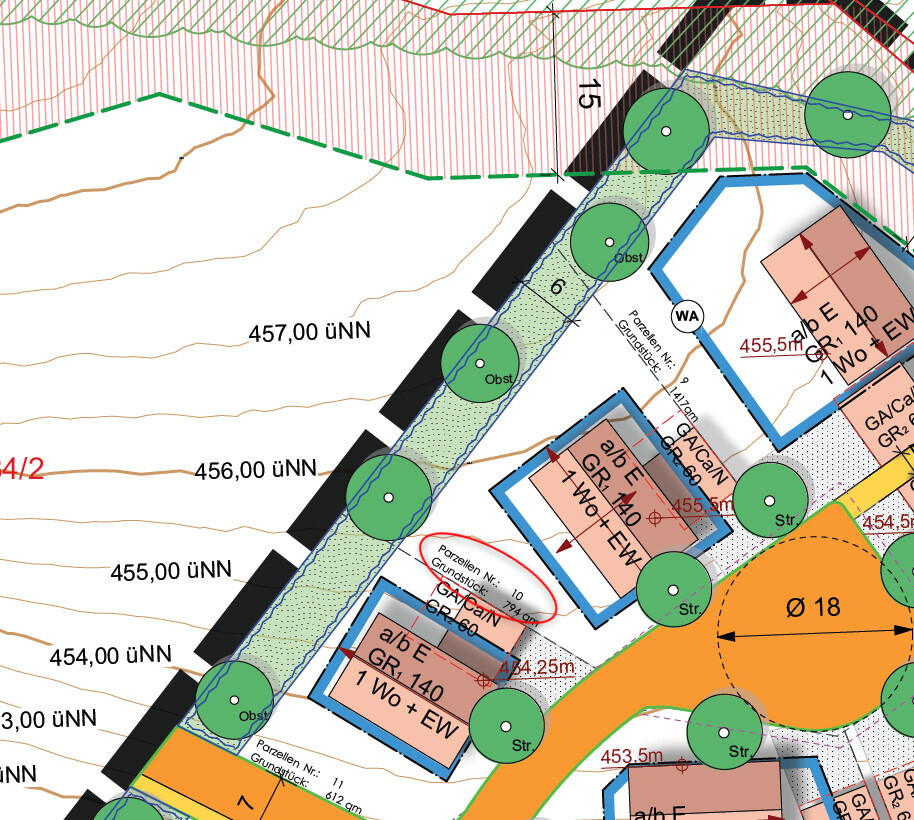

Plot size → 794 m² (8,544 sq ft), parcel 10
Slope → No
Site coverage → 140 m² (1,507 sq ft) for the house + 60 m² (646 sq ft) for the garage
Floor area ratio →
Building envelope, building line and boundary → see development plan
Edge development → Yes
Number of parking spaces → 2
Number of floors → 2 full floors
Roof type → symmetrical gable roof, 20° – 32°
Style → not specified
Orientation → see development plan
Maximum heights / limits → permitted wall height 5.50 m (18 ft) up to max. 6.00 m (20 ft) for 2 full floors
Further specifications → municipality is generally very open to deviations (e.g. garage/house setback deviations already approved)

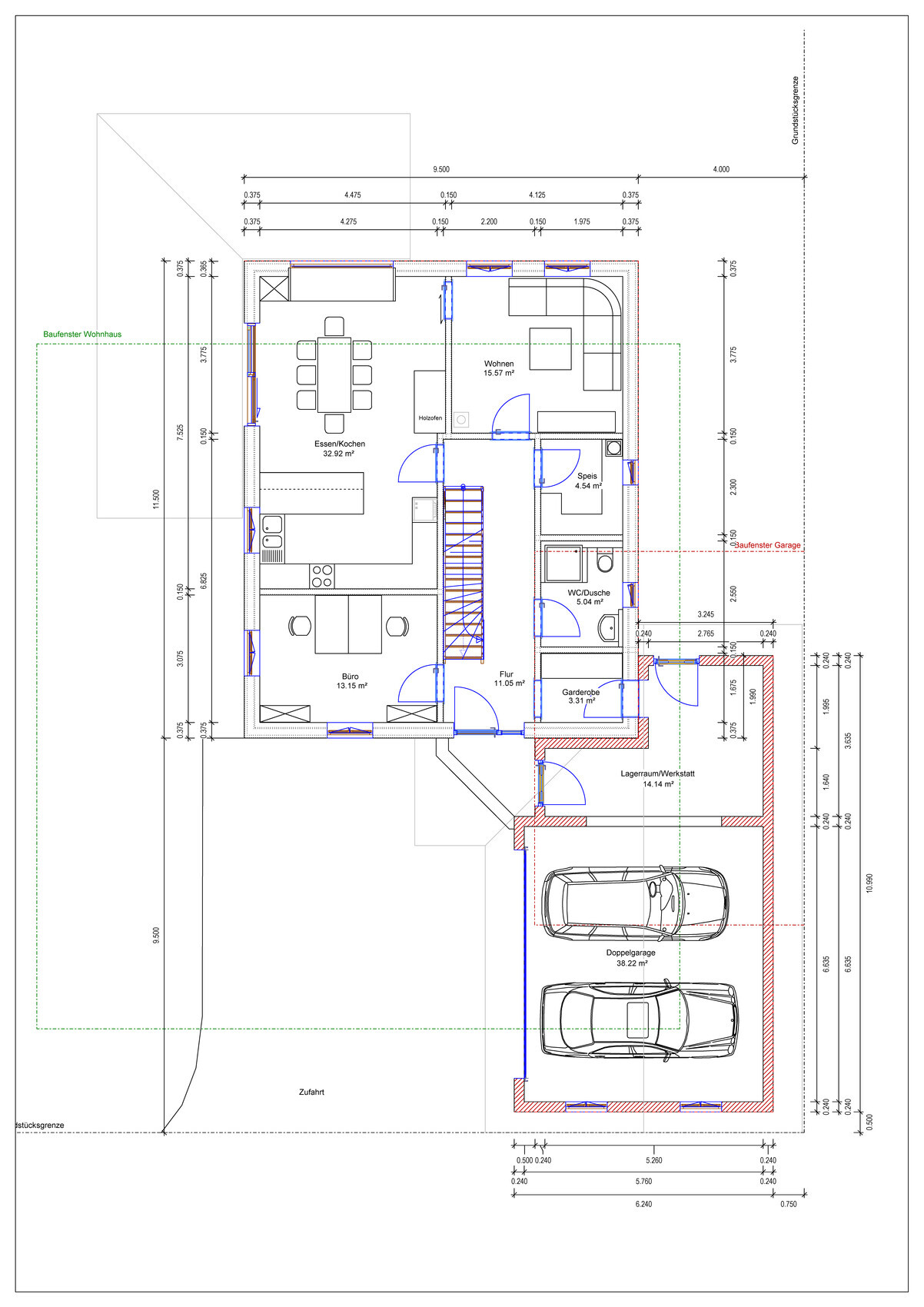

GF: For us, the kitchen/dining area is the central space of the house and should be designed generously. The open kitchen with an island should also have seating attached to the exterior wall. The pantry is deliberately placed towards the north and does not need to be a hidden pantry directly next to the kitchen (with the current location, it’s also easily accessible from the living room). A wood stove with a viewing window will be placed in the dining area, connecting visually with the living room. If possible, a seating window in the dining area with a view towards the forest/field would be great. The living room should be a private, separate, relatively small retreat. The office should be on the ground floor so it can also be used as a bedroom if needed. The WC should be equipped with a shower. A separate cloakroom is intended to keep the hallway tidy. The additional hallway area may also serve as access to the garage. A staircase at the entrance area is an absolute no-go for us, so the staircase is located at the rear of the house. The stairway leads directly towards the bathroom in the evening, which we find optimal.

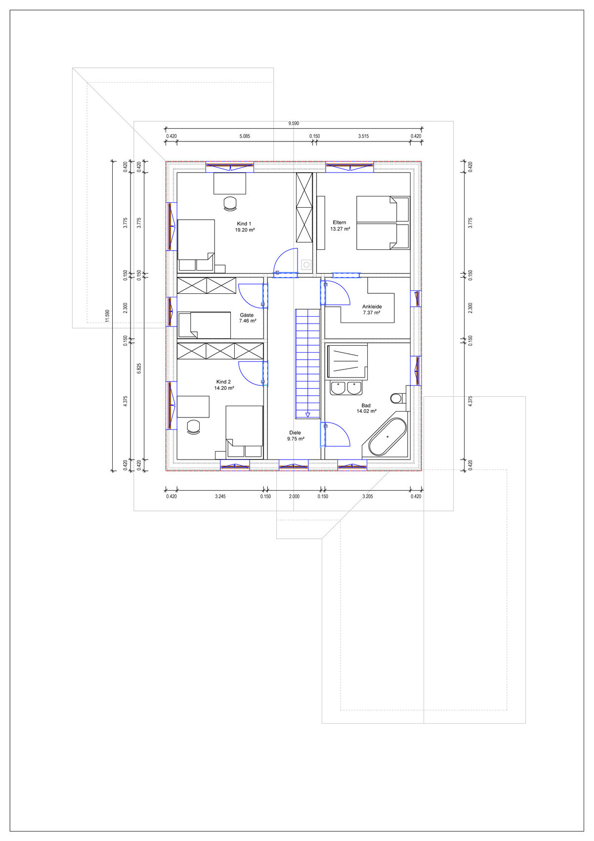

UF: We are not yet very happy with the layout. The second child’s room is relatively narrow. The guest room is too small (about 8-10 m² / 86-108 sq ft) and the first child’s room too large. The bathroom can certainly be reduced in size; we do not need a luxury bathroom. The goal on the upper floor is to make the most of the unobstructed view (field/forest) towards the northwest.

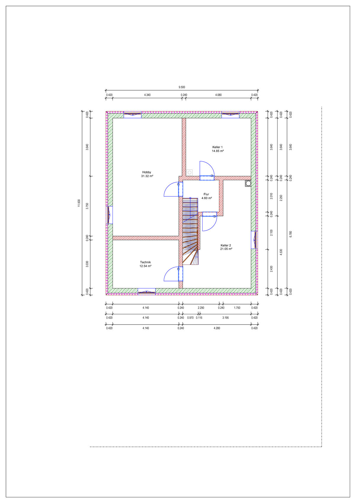

Basement: Also not optimal yet. The straight staircase makes it less convenient. We would appreciate tips here.
Garage: The garage rotation and its placement at the front of the plot has already been approved by the municipality. The garage’s length along the boundary (max. 9 m / 30 ft) will still be shortened. Whether there will be internal access to the garage from the house is still open; if necessary, a separate exterior entrance is sufficient.

What don’t you like? Why? → The children’s rooms are relatively narrow (3.245 m / 10.6 ft)

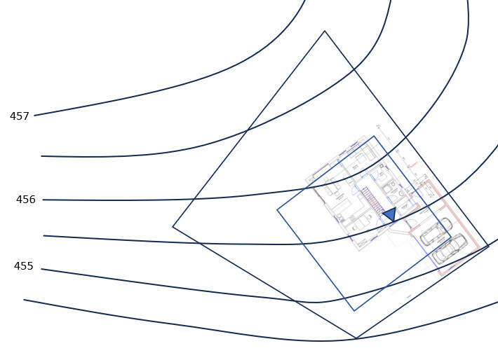

hanghaus202317 Apr 2024 10:40Calling it a slope is somewhat understated. A 2.5 m (8 feet) elevation change from north to south within the property?
hanghaus202317 Apr 2024 11:28S
Schorsch_baut17 Apr 2024 11:57S
Schorsch_baut17 Apr 2024 12:06What does the budget say? With a basement and no garage, that's about 300 m² (3,230 sq ft), if I haven't miscalculated.
