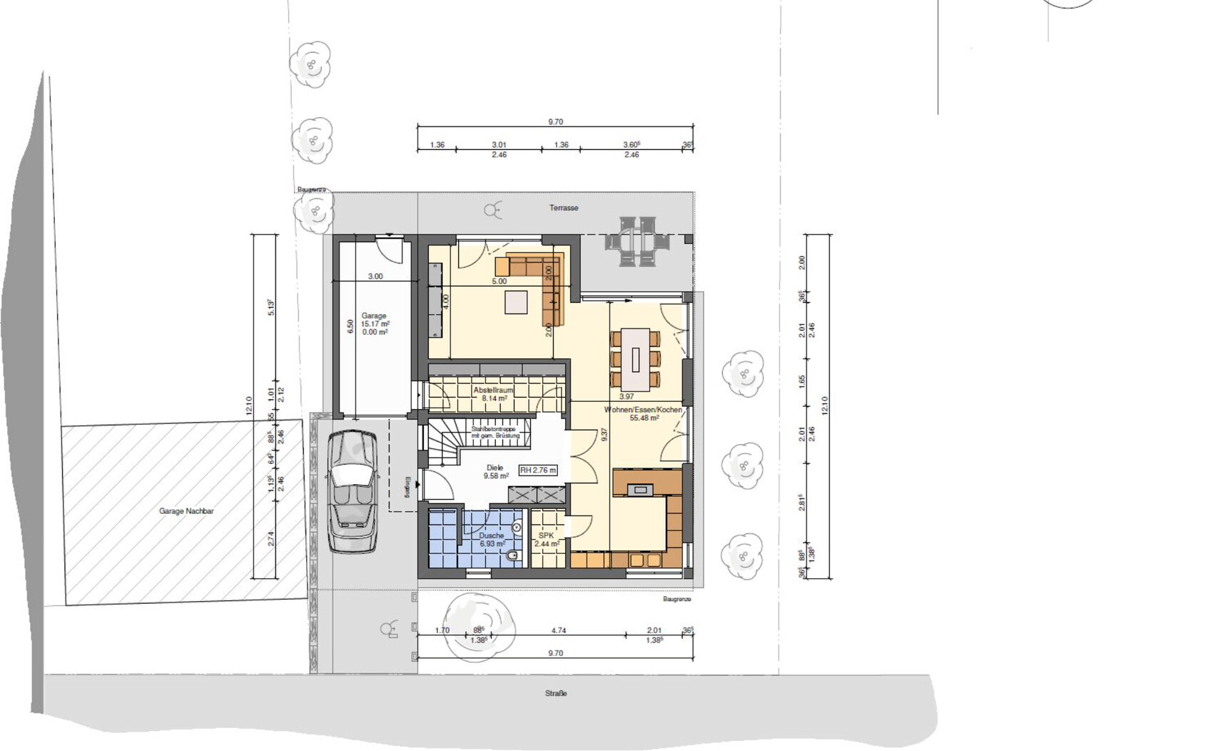

Hi,
We have a 500m2 (5400 sq ft) plot where we would like to build.
We have now received the initial plans from our preferred construction company.
We need a basement because my wife and I both work from home, and we have three children who should each have their own room.
The attic is not really a good option due to the small dormer window and a building height limit of 9 meters (30 ft). The basement is quite expensive because of the clay soil, but in the end, we decided in favor of the basement, and the first financing simulations fit approximately a $680,000 build cost including additional construction expenses. The land is not included, of course.
I think the plans are already quite good, but I don’t have much expertise. A master bathroom was our request. The guest bathroom on the ground floor is there because we often have guests staying with us.
In my opinion, the pantry can be left out.
I planned the upstairs hallway once larger and once smaller to allow for a bigger children’s bathroom.
I miss the external staircase to the basement. If the stairs were on the right side, it would allow for "normal" windows in the basement offices. I have pointed this out. Also, the street runs roughly along the house from left to right and drops about one meter (3 ft).
I’m not sure about the layout of the "fitness" room; I think it might be structurally necessary. I want to bother the architect only once we are 100% sure we are going with this construction company.
What I generally don't like right now is that generic feel when looking at it, but the house is simply a standard two-story with a 30° pitched roof.
I would really like to know from your experience whether this covered terrace is a good idea or not.
Thanks in advance

Grundriss eines Hauses mit Garage, Terrasse, Wohn- und Essbereich, Küche und Diele.

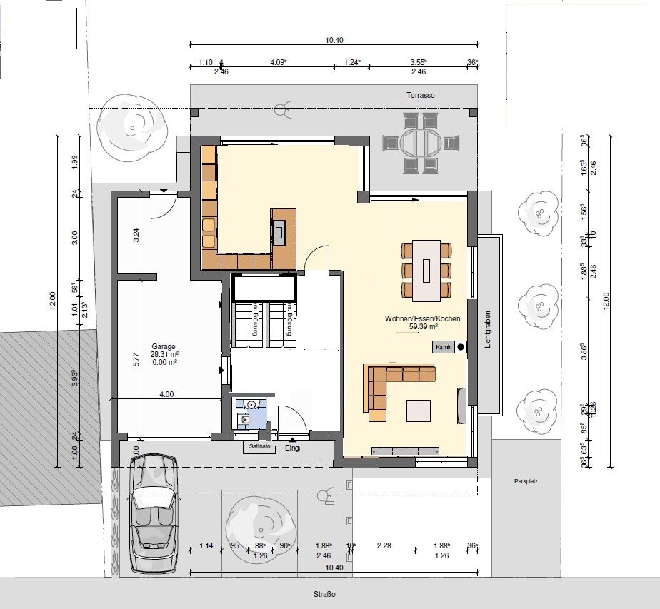

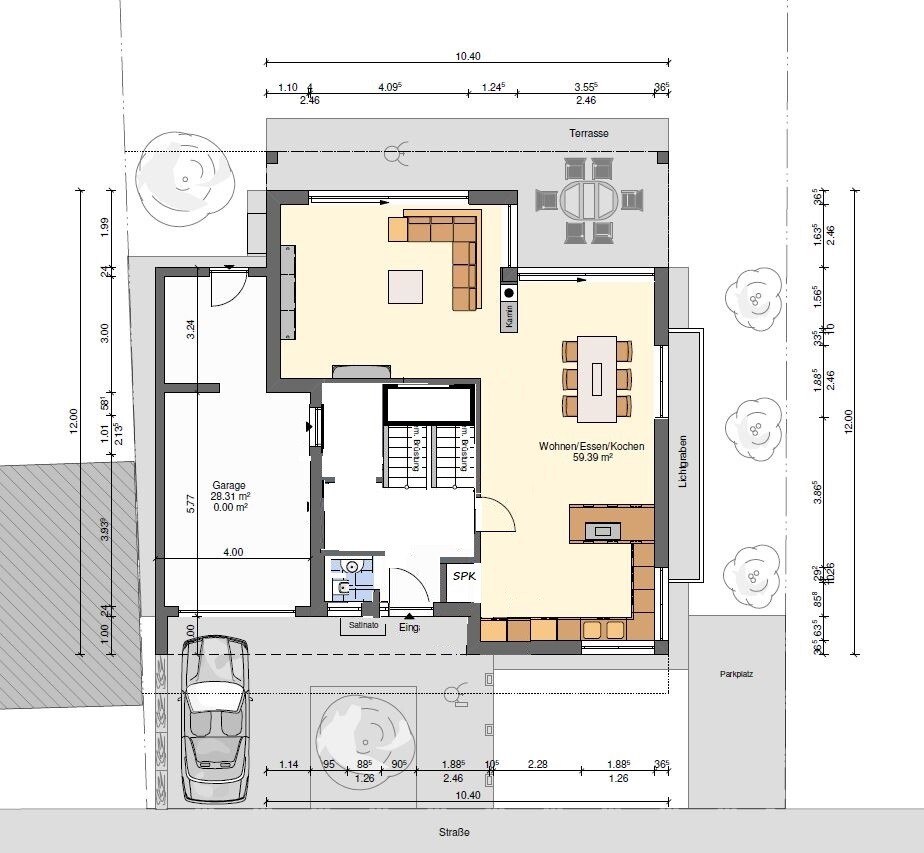

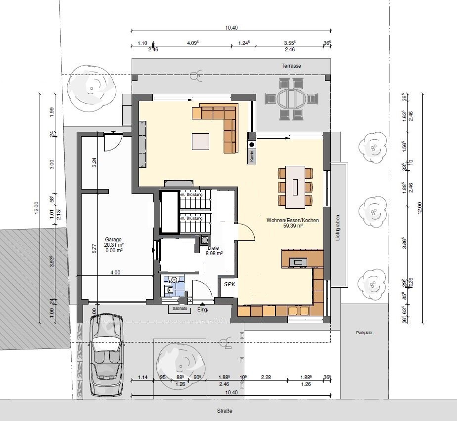

Since I don’t have a proper computer today, I played around with Paint. Is it really so unusual to place the kitchen facing the garden and the living room on the northwest side? I’m attaching my rough draft here in case anyone is interested.

Is it completely unusual to build the kitchen facing the garden and the living room on the northwest side?
Not for me!
It really depends on what you want from the living room. For me, the living area consists of the sofa and TV corner— a space we use privately, not with family, friends, or guests. The living room is a retreat, a place to end the day. In that sense, I find a spot with less natural light perfectly suitable for it.
The kitchen, on the other hand, as the heart of the home and a central hub for everything and everyone, should ideally be oriented with access to the garden.

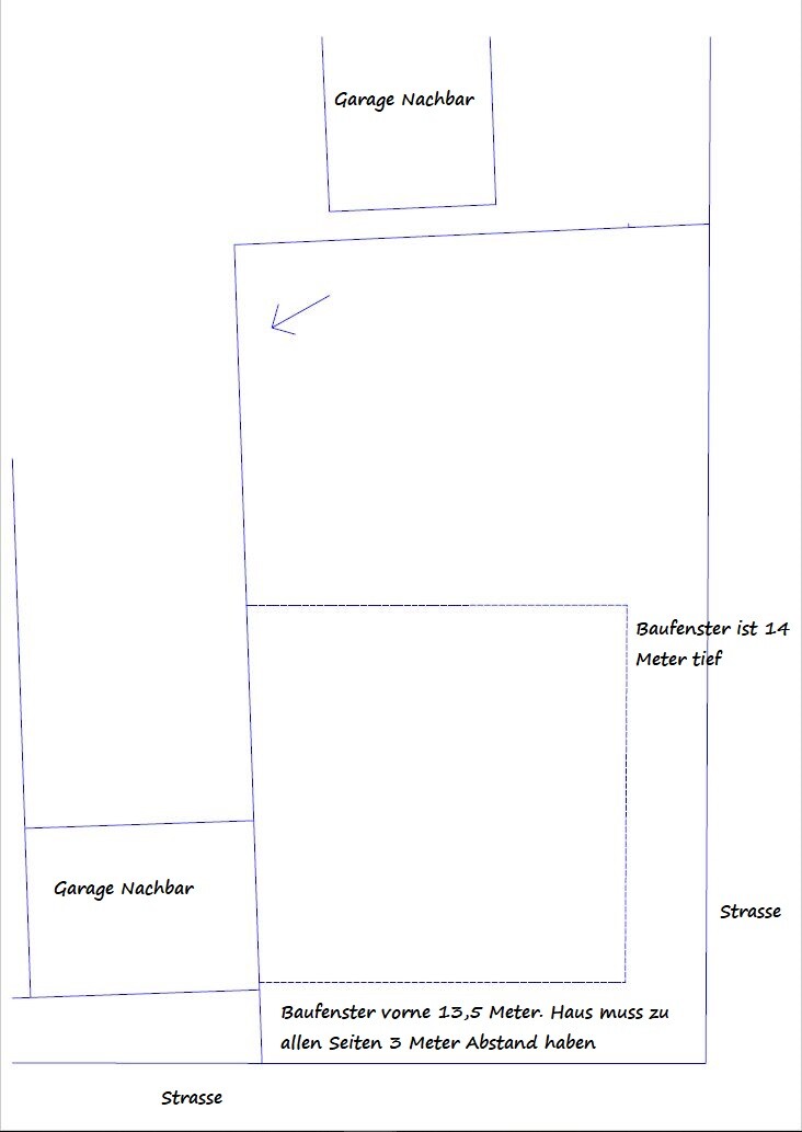

Otherwise, you can see the cardinal directions, the building permit area / planning permission zone, the neighboring garages, as well as the streets. So, which information do you find missing?
Take a look at what you posted here in the first post. It’s now a screenshot, with the north arrow, a cardinal direction, a street, and a neighboring garage in the top right corner... but you refer to all of these in the plural.
In the end, it doesn’t really matter, but I still don’t see the building permit area / planning permission zone (on my phone), which would make sense for the house dimensions. It would also be interesting to know what kind of street this is: a through street in a residential area, a dead end, how many neighbors or outsiders pass through?
Is everything already built, and does the neighbor also have a house next to the garage that could block your sunlight?
I can’t even see the lot. It may be perfectly clear to you because you know it, but we see a somewhat faded area that probably represents paving. How much space remains on the right side is not visible. It’s also possible that I’m missing the forest for the trees, which has happened before. The other posts don’t look any different.

I already posted this earlier in the thread, but here is the plot with the building envelope and the neighboring garages. The only neighboring house is next to the left garage. Otherwise, there are no other houses within a 30-meter (33 yards) radius that could block my sunlight. The north arrow is included here as well.

Site plan of a plot with building outline, 14 m (46 ft) deep building envelope, 3 m (10 ft) setback; street boundaries.
