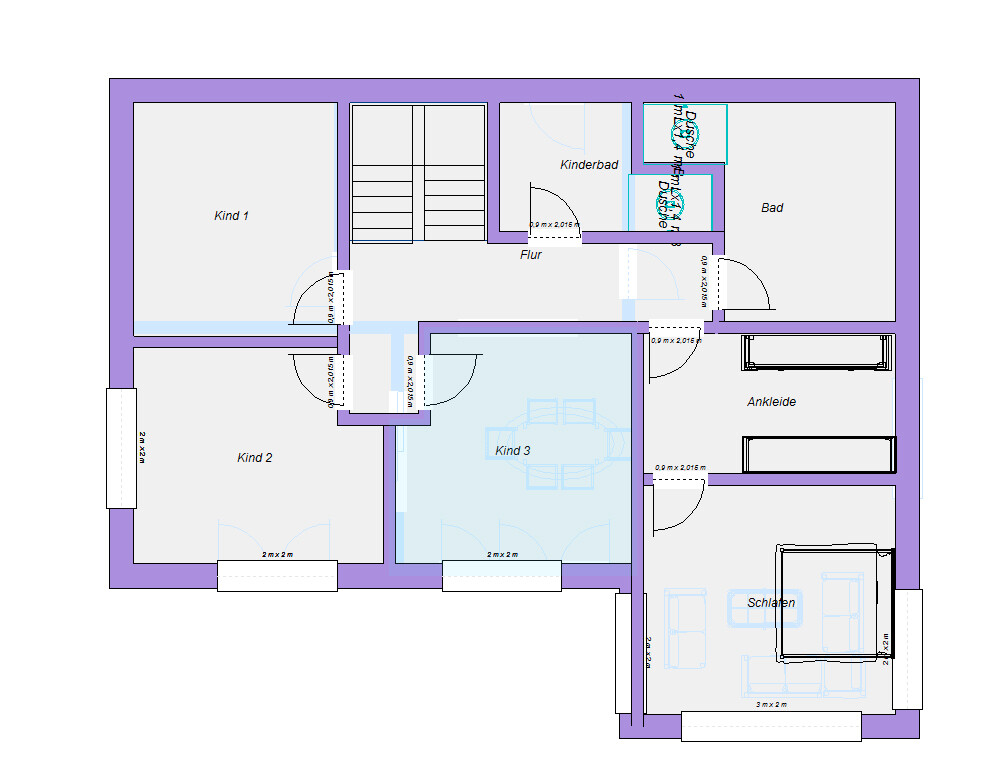

In my opinion, the main issue upstairs is the children’s bathroom. It would work better if the two bathrooms were located next to each other and the staircase switched to the side with the main entrance. Here is a sketch to illustrate what I mean. This would mean that the ground floor plan would need to be adjusted accordingly, which doesn’t seem impossible to me. However, almost all the rooms would need to be redesigned.
Just a thought.

Good approach, but can you still fit furniture in rooms 2 and 3?
The passage looks quite narrow.
That could be a critical point.
But the solution with the bathrooms is really clever!
kaho6747 Jul 2017 15:49
It is wider than a door. But with the third child, pulling it a bit closer to the wall seems manageable. This was just optimized so that all three children have the same size.

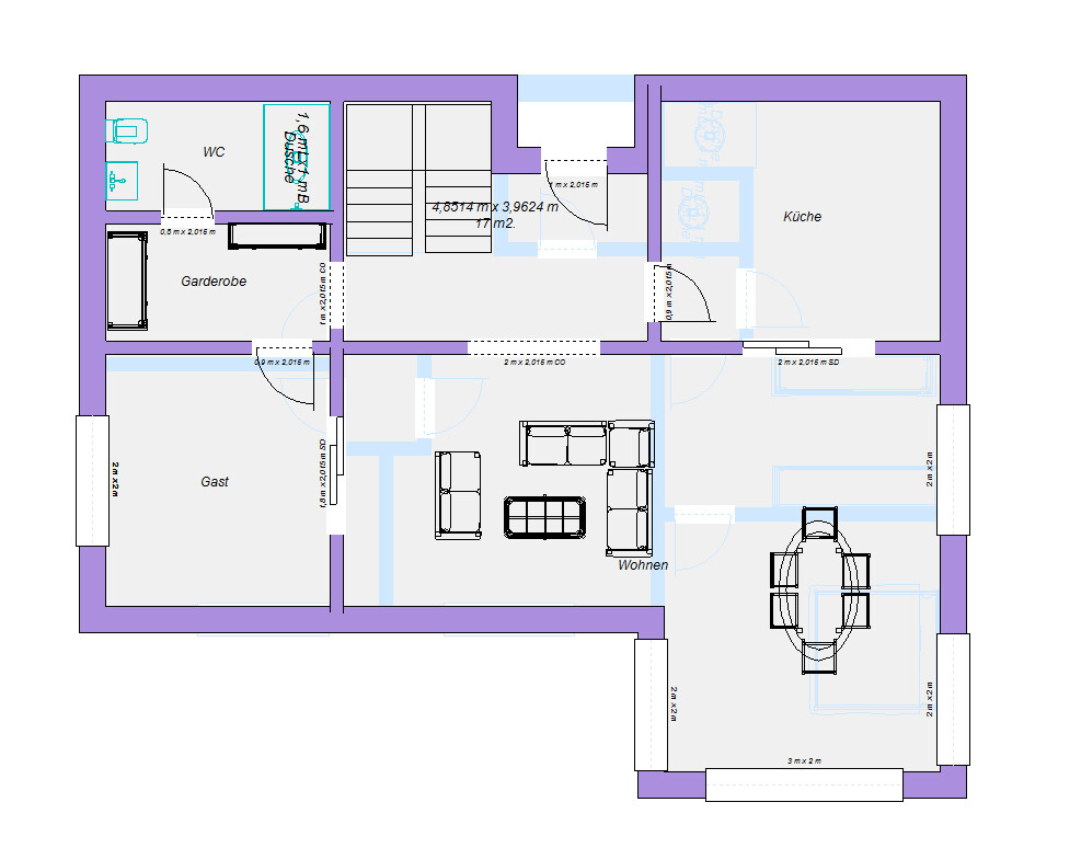

Based on this sketch, the lower part is not impossible. The main issue now is that the distance from the entrance to the cloakroom is quite long. This means less space for the guest and a direct line to the bathroom. Well, maybe the experts can come up with something better. Only minimal changes were made.

I'll forward it to him and see what he thinks.
What kind of little program is that, actually?
