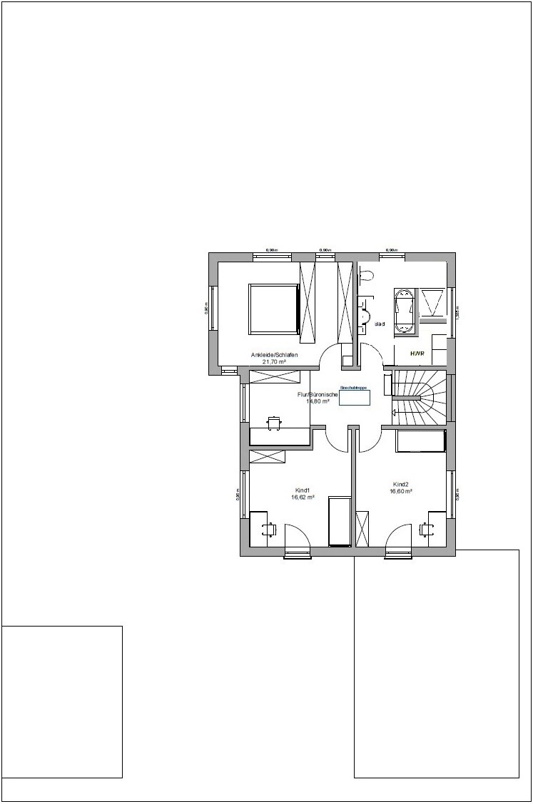

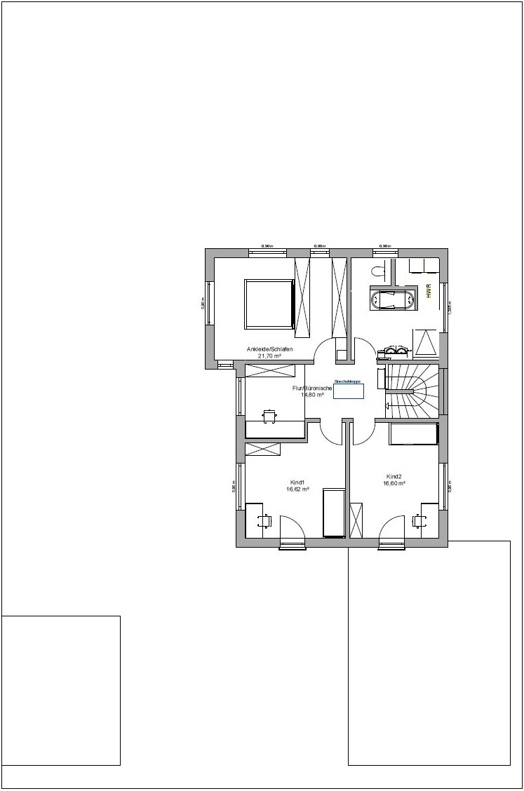

Hello everyone!
@hausnrplus25: Thanks. I think it will be difficult to place the bedroom with the walk-in closet in the southeast corner. Otherwise, that would be my ideal spot regarding sunlight. I’ll think about it, but I don’t want to burden the planner with too many further changes.
@ypg: Somehow integrate the utility room into the otherwise quite large bathroom, for example as shown in the two somewhat blurry sketches attached. Laundry could be collected there. The other steps, hmm, probably somewhere in the bathroom, walk-in closet, or office niche... Maybe a balcony is planned for later, which could also be used for drying laundry.
Do you have any suggestions for this?
Oh, and what do you think about the dining room? Is there enough space all around? A sliding door to the terrace is also planned.

tepee schrieb:
but I don’t want to burden the planner with too many additional changes
Wrong, wrong, wrong – that’s exactly their job! And if they have to make 50 changes before you get your perfect house, so be it! If you have a request, raise it and see whether it’s easily doable or if there are any issues – then you decide which compromise works best.
To keep communication more pleasant, it’s of course fair to gather several points and clearly articulate your wishes or concerns. Daily emails saying “now A” and then “oh no, actually B” are usually not very effective.
tepee schrieb:
We significantly changed the design, and this is the version that came out of it, I quite like the new pantry solution, but overall, I don’t think any amount of cosmetic adjustments will stop the kitchen design enthusiasts here from frowning. It looks quite cramped in terms of space.
hausnrplus25 schrieb:
And if he has to change it 50 times before you have your perfect house! ... to me, this seems like the beginning of the house developing Morbus Hotzenplotz :-(
... I see this as the beginning of the house developing Morbus Hotzenplotz :-(... you’re probably right that making multiple changes often doesn’t improve things. There’s even a term for it: “fixing something that wasn’t broken” or “making things worse by trying to improve them.”
But out of consideration for the architect, I would never give up on requested changes to my floor plan just because of that, like “well, the layout isn’t great, but rather than making the architect change it again, let’s just leave it as is and build it how we don’t want it” – that makes me shake my head.
