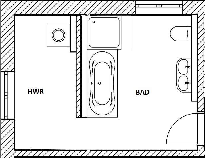

I understand the utility room. I would rather not give up the office. Therefore, the only option is the bathroom, which is actually almost too large for our needs. We only need about 10 square meters (108 square feet), but it is 14.5 square meters (156 square feet). So, 4-5 square meters (43-54 square feet) could be cleverly separated. Maybe something like this?
Floor plan of a bathroom with bathtub, double sink, and door; next to it utility room with washing machine.
11ant20 Feb 2020 12:59
I suppose it's what they call "fighting fire with fire," especially from the perspective of the relaxing bathtub captain.
kaho67421 Feb 2020 08:47
You have a large office downstairs, which also serves as a guest room. I think setting up another office upstairs doesn’t make much sense, especially when what I really need is a utility room.
