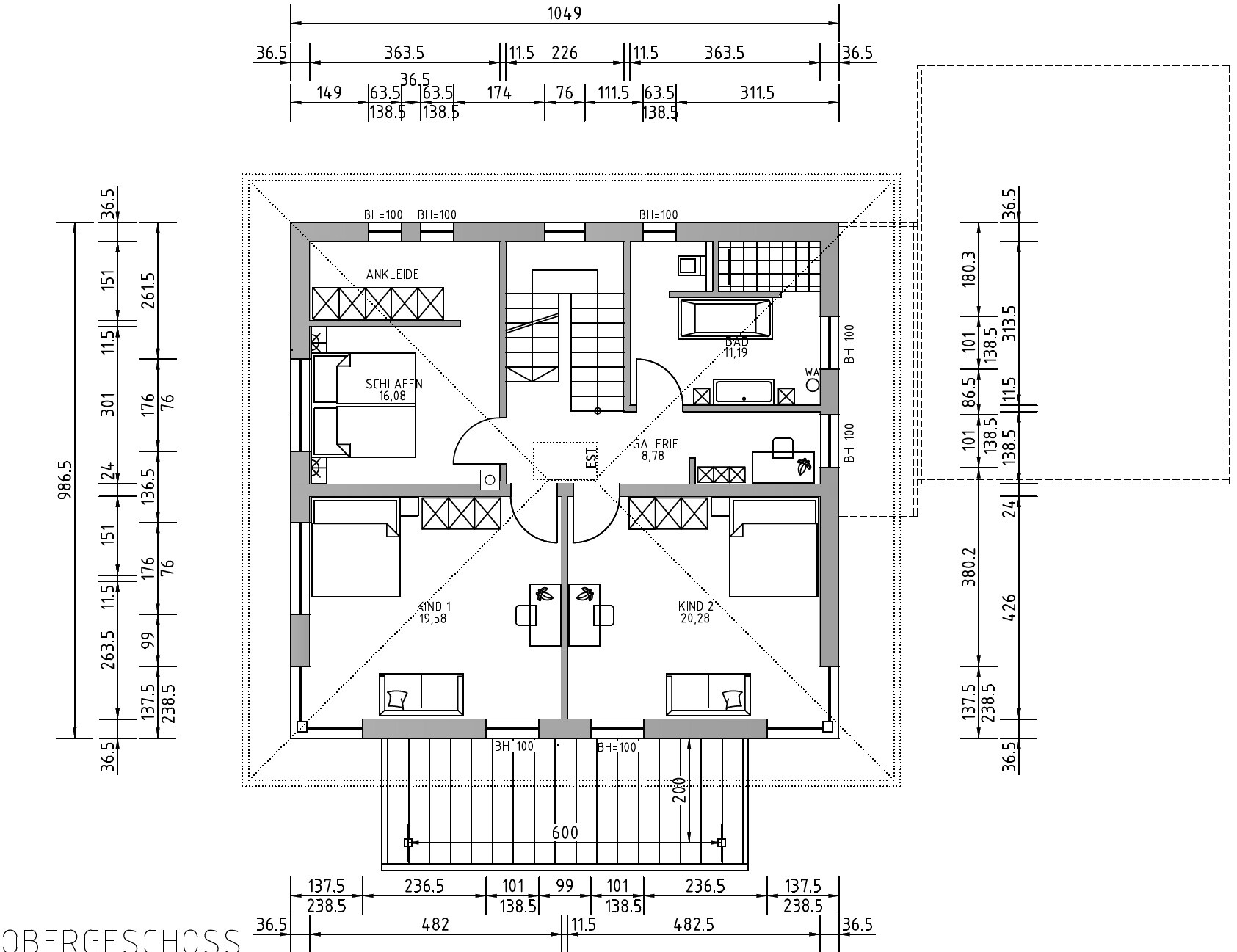

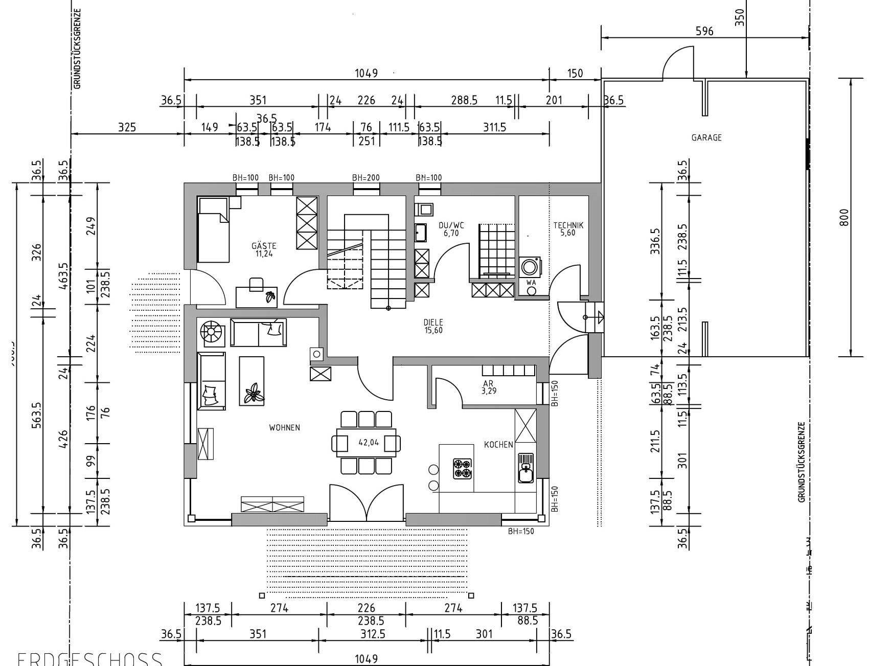

We would like to stick with the house design that includes the double garage next door. We have received an initial floor plan, see attachment. There are still quite a few changes needed (smaller kids’ rooms, larger master bedroom, utility room on the upper floor, etc.), but what do you generally think about it?

I like the floor plan. Simple and clear.
Regarding the house positioning: I would push the house all the way to the back and then as far as possible to the right. I would accept the long driveway and the higher connection costs for that. You can nicely separate the driveway from the garden with some shrubs. The neighbor at the back will have their garden adjacent, so you will get good natural light from all sides.

I quite like it as well. However, I noticed two things. For my taste, Child 1 has too many windows. In fact, there are four windows. And I would skip the passage to the garage. The main entrance is just one meter (3 feet) away. In a 6-meter (20 feet) garage, there isn’t much space (depending on the car) to comfortably walk around.

The floor plan proposal is based on a first smaller version and thus still has some flaws here and there. We generally like the ground floor. The garage access there is due to the slope: the garage would be slightly higher, requiring steps. Hopefully, this can be resolved by lowering the garage about 50 cm (20 inches), which would better fit our idea of a “single-level” layout.
I also see room for improvement on the upper floor. Not only does one children’s room have many windows, but the children’s rooms at about 20 sqm (215 sqft) each are somewhat large, while the bedroom is a bit small. The goal is to have children’s rooms of about 15 sqm (160 sqft) each and a master bedroom of 20 sqm (215 sqft) including a walk-in closet. That would leave a few extra square meters for the utility room and similar uses.
