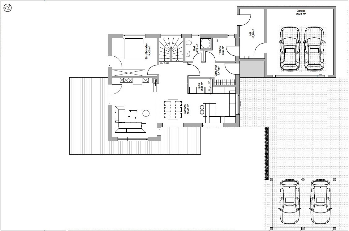

Hello!
After some time, we can finally focus on building the house again. We have significantly revised the plans, and this is the version we now want to proceed with quickly.
Approximately 165 square meters (1,776 square feet) of living space, without a basement. The drawn carport is optional, in case the garage space might be insufficient. It would also be quite useful as a privacy screen on its own.
The street side faces south, see the north arrow and site plan on the first page here. The highest point is in the southeast, the lowest in the northwest. The garage should be set as deep as possible, so that with some sloping in the northeast, the garden can be as level as possible.
The ground floor is essentially rotated toward the west. This results in the garden being on the southwest-west and north sides. The staircase is designed to let in plenty of light so that we have sunshine in the morning as well.
On the upper floor, the relatively large bathroom should also include the washing machine and/or some storage space, with (visual?) separation. So, basically a small utility room on the upper floor.
What are your thoughts on this?
I just finished reading all 7 pages. There have been quite a few ups and downs in your planning, especially regarding the basement issue.
I like the floor plan. I would prefer the directions of the upper floor to be mirrored (children’s rooms on the warm southwest side and bedroom/bathroom on the cooler side), if that is still adjustable.
Otherwise, we look forward to more updates and pictures of the construction process.
