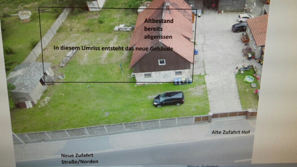

Attached is an aerial photo of the plot.

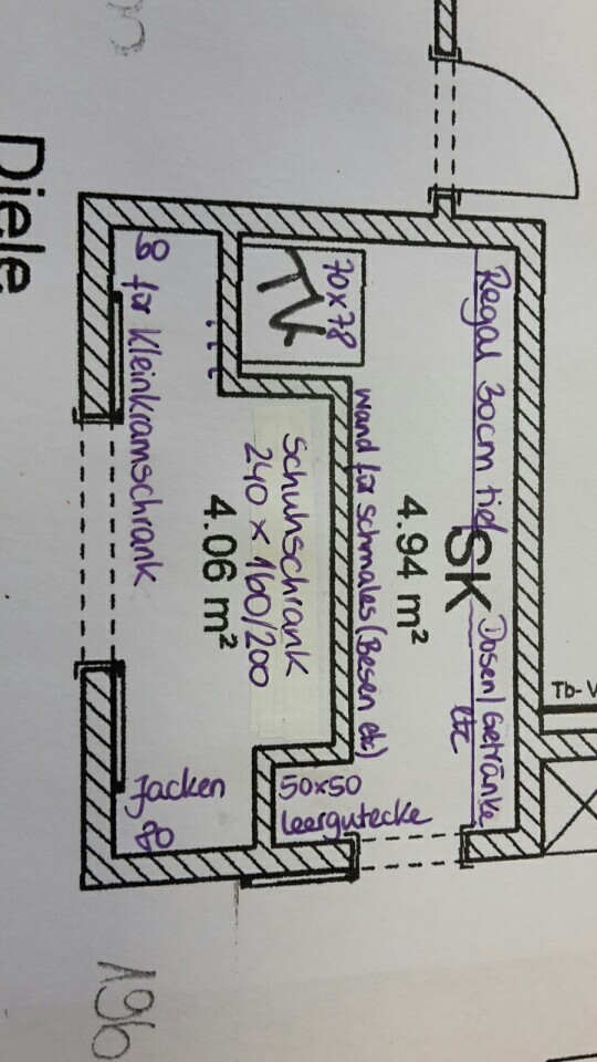

An image showing why I planned the stairwell and wardrobe this way.
The main house is 11.26 meters wide and 12.70 meters deep (37 ft and 42 ft).
The furniture was drawn in by the architect based on my exact measurements.
My dad said: First, you place the furniture, and then you build the walls around it to make sure it fits perfectly.

The shoe cabinet section is actually too deep. 80 cm (31.5 inches), minus the space taken by the sliding door, is not enough for jackets.
Try opening your 70 cm (27.5 inches) wide freezer cabinet so you can remove the freezer drawers. Especially, move it into the room or out again for repair or replacement.
ninfa4 Oct 2017 12:55
The sliding door in the SK is 80cm (31.5 inches) wide – 70cm (27.5 inches) of clearance is available, and the TK door can be opened without any issues.
The shoe cabinet itself will be 50cm (20 inches) deep, and having some space in front is beneficial (for slippers or dirty shoes).
The jackets will hang on hangers in two rows (160cm / 63 inches). Currently, I hang all of them within 80cm (31.5 inches).
kbt09
4 Oct 2017 13:01
From the sketch, you cannot see any of this clearly because there are no dimensions. However, if I look at the 80cm (32 inches) coat niche, the service entrance door is not 80cm (32 inches) wide.
