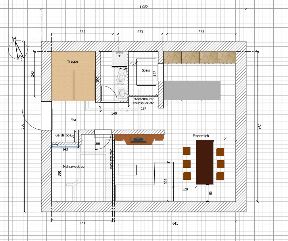

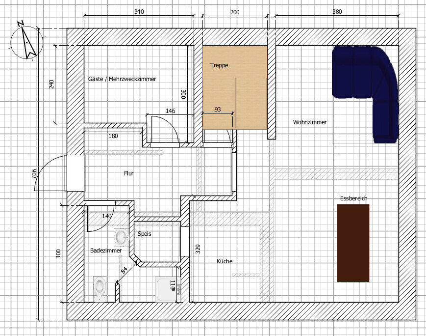

Hello everyone!
Although we are from Austria and building here, we have been following various posts in this forum for some time. There are many creative minds here, and I really appreciate your advice in the other discussions.
We ourselves have been in the house planning phase for quite a while. We recently purchased a plot of land south of Vienna and plan to start construction in 2020. We want to build with solid construction methods, but we are still deciding between brick (which is very common here) and aerated concrete blocks (we really like the kit house concept from Ytong based on what we’ve heard so far, although it is quite rare in our area).
Efficiency in the use of living space is very important to us (no unnecessary features, no long hallways, no balconies or bay windows), as well as in the building services (heat pump, controlled mechanical ventilation system, etc.).
I assume there isn’t much experience here with Austrian building regulations, so I will try to answer any questions that come up as quickly and competently as possible.
Here is the completed questionnaire:
Zoning Plan / Restrictions
Plot size: 604 m² (6500 ft² approx.)
Slope: No, completely flat
Site coverage ratio: (not applicable here) - 32% buildable area
Floor area ratio: (not applicable here)
Building setback lines and boundaries: front setback 3 m (10 ft), side setback 3 m (10 ft) or half the eave height of the adjoining façade – whichever is greater, rear setback 3 m (10 ft)
Edge building restrictions: within the setback zone up to a maximum height of 3 m (10 ft)
Number of floors: not specified in the zoning plan
Roof shape: no restriction according to zoning plan
Architectural style: no restriction
Orientation: no restriction
Maximum height/limits: max. building height 6.8 m (22 ft) (eave height)
Other requirements: none
Style, roof shape, building type: classic rectangular shape, gable roof or staggered shed roof, simple building form without bay windows or dormers, no balconies!
Basement, floors: basement (gym, workshop, laundry, mainly storage), ground floor (living areas + guest room), upper floor (bedrooms)
Number of occupants, ages: male 28, female 34, child 0.5 years, child 11 years (every second weekend + school holidays)
Space requirements ground floor, upper floor: ground floor (shower bathroom, guest room/home office/play/multi-purpose room, living room, kitchen, pantry), upper floor (bedroom including walk-in closet, 2 children’s rooms, bathroom), basement (gym, laundry, storage, workshop)
Office: family use or home office?: 80% family use as playroom, 10% home office, 10% guest room
Overnight guests per year: approximately 5, mainly relatives visiting for various celebrations from afar
Open or closed layout: open plan
Conservative or modern construction: rather conservative but open to “unconventional ideas”
Open kitchen, kitchen island: open kitchen with breakfast bar
Number of dining seats: permanently 6, at family celebrations minimum 12 temporarily, >16 long term
Fireplace: no
Music/speaker wall: no – but large TV frequently used
Balcony, roof terrace: definitely no!
Garage, carport: carport within the setback zone (on the north side?)
Vegetable garden, greenhouse: definitely yes! Gardening is a big wish and the main reason for the whole project
Other wishes/special features/daily routines, explanations if desired: The house should be as efficient as possible (during construction and especially in operation), therefore no awkward bay windows etc. (ratio of surface to volume)
Additional requests: controlled mechanical ventilation system, laundry chute, non-load-bearing partition wall between the children’s rooms so it can be removed in a few years if the older child no longer lives at home. The most important thing is a large garden, so that’s why the basement is desired to minimize the building footprint. The kitchen must be large enough for at least two people to cook at the same time – this is currently a problem in our apartment.
Designed by: DIY with a lot of input from planners
What do you like? Why?: almost all wishes implemented
What do you dislike? Why?: pantry is quite small, upper floor still not quite perfect, niche in the corridor as storage replacement for vacuum cleaner etc.
Price estimate according to architect/planner: €430,000 turnkey, €350,000 “turnkey with owner involvement”
Personal price limit for house, including fixtures and fittings: €350,000 in shell and core condition is the goal, with a comfortable buffer, but that would be our ideal
Preferred heating technology: heat pump with ground source collector (trench collector)
Note: We are not under time pressure for planning or construction. We are very willing and able to do much of the work on the house ourselves. Providing appropriate “self-performance proof” for the bank is not a problem either. This helps keep construction costs low.
If you have to give up something, which details/finishes
- could you give up: almost everything except the pantry and open kitchen
- could you not give up: pantry, open kitchen, and preferably not the controlled ventilation
A mix of many examples from model home parks, magazines, and many discussions with planners/architects etc.
All the rooms we imagined are present, relatively short circulation routes, hardly any wasted space
What do you think of the design? Where do you see potential for improvement? Placement of laundry chute?
I look forward to your opinions and comments!

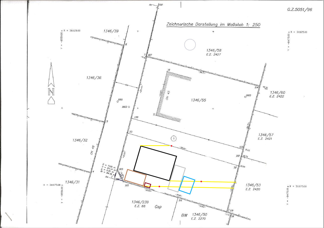

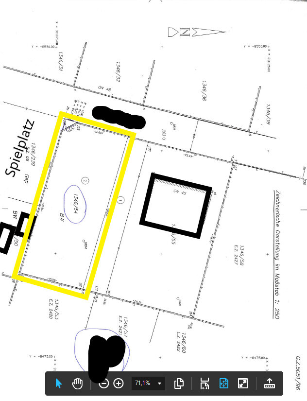

Gugelhupf24 Mar 2019 20:38Nordlys schrieb:
Spent the weekend there? Camped out? That’s real enthusiasm. We have a sleeping option nearby.
There is also a bed in the “garden shed,” but with our little one, it’s still a bit too cold for that.
The house could be set back towards the rear, but not right up to the property line.
A 10m (33 ft) setback would have to be maintained, which would place the house roughly in the middle of the plot, resulting in two garden areas that, in my opinion, are not really useful in size.
10m (33 ft) at the back, then the house, and about 14m (46 ft) at the front. Neither area is large enough to be practical.
I’d prefer one larger, continuous, though shadier, garden area at the back and position the house closer to the front.
Gugelhupf27 Mar 2019 21:32I experimented with a possible building layout and the sun’s position/shadows. The image is attached.
I moved the house 3m (10 feet) north—this allows more evening sunlight to pass the house into the garden. On the south side, a distance of 4.5m (15 feet) to the property boundary is marked, and on the west side, the drawing shows about 6m (20 feet) from the street.
The yellow lines represent sunlight during full west-facing sun (sunset). The red dots indicate shadows at a sun elevation of 10°, with Vienna as the reference location. A 10° sun angle corresponds approximately to 7:30 PM on July 1st, 4:30 PM on March 1st, 3:30 PM on November 1st, and so on.
The brown rectangle on the south side would be a carport about 3m (10 feet) high. The gray rectangle marks a possible position for the terrace (potentially extending around the corner), so at least half of the terrace would still receive the sunset light. The blue rectangle shows a potential location for a future pool—also positioned to catch the evening sun.
I think the planning exercise shows that this is a viable approach. It won’t be a full sun exposure property, but it won’t be in permanent shade either. This amount of sunlight would be sufficient for me, especially since it can get very warm and stuffy in your area during the summer, so a bit of shade is welcome. Karsten
Sorry, I wouldn’t like it at all if the carport is on the south side. It’s primarily about getting sunlight inside the house, not in the garden. Half of the year is winter, and you’re not sitting on the terrace or swimming in the pool. You still want the inside of the house to be bright and welcoming, right?
