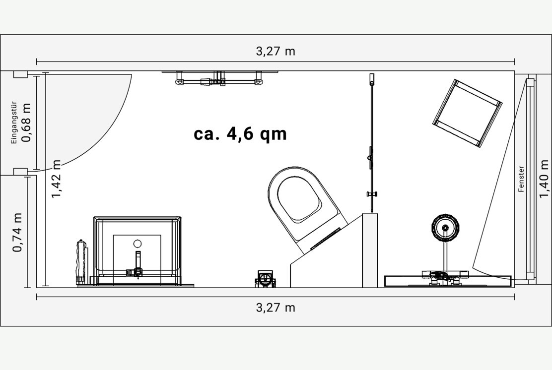

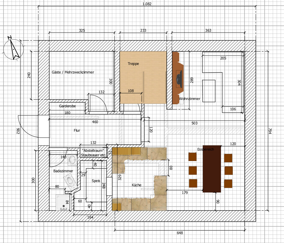

The ground floor is still missing.I have added some measurements on the ground floor. The kitchen is currently just a placeholder – we will consider it in more detail later...
Regarding the ground floor bathroom:
Would a solution like the one shown in the attached image be a practical option? This way, the shower is retained, and the layout would require significantly less space. The remaining question is how best to allocate the freed-up space to the kitchen or pantry?

About your floor plan
Please draw in the furniture you plan to buy or already have, to scale. Also include the kitchen you haven’t ordered yet but want. For example, if you definitely want a peninsula, it needs to be included now; the color and brand don’t matter.
Also take traffic areas into account, so that Aunt Gerda can still pass Grandpa Hubert when he is sitting at the table.
Ground floor
The pantry is so small it could fit inside any good cabinet. There are pantry cabinets that are real space savers.
Omit the shower and add that space to the pantry.
If the sofa is going to be that big, where will the cabinets, table, and children’s toys go?
Upper floor
Bathroom is very small, and the dressing room only fits one row of cabinets.
I would remove the dressing room and add those few centimeters to the bathroom.
Make sure to mark the two-meter (6 feet 7 inches) line, even with high knee walls. I might be able to shower, but if you are 1.99m (6 ft 6 in) tall, suddenly you won’t anymore.
Would a solution like the one shown in the attached image be a reasonable option? This would keep the shower while requiring significantly less space. The only question is how to best allocate the gained space between the kitchen and the pantry?Move the front door 30cm (12 inches) upwards, place your layout in the lower right corner of the plan, and also move the pantry all the way down to the exterior wall. The freed-up space can then be used for a wardrobe. (By the way, why are there two recesses for a wardrobe?) Alternatively, add the gained space to the pantry.
Alternatively: Keep the original layout but shift the pantry upwards so that it aligns with the wall in the hallway, creating a correspondingly larger access to the shower.
Personally, I would prefer option 1, since then the pantry could have a window.
Gugelhupf schrieb:
I hope I’ve cleared up the uncertainties? Yeah.
Those are some serious walls. For a rather compact house, they’re quite substantial. Is it still 135m² (1455 sq ft) then? What does your software say? Does it calculate that automatically?
Wrapping the bathroom like that doesn’t make sense. A thick exterior wall should be enough.
The house is small. I find a half-landing staircase questionable here. For this size, people usually go for a standard layout that maximizes space. To me, that means the entrance would be on the eaves side next to the stairs. Is that an option?
What knee wall / dwarf wall height did you choose?
Gugelhupf20 Mar 2019 17:26kaho674 schrieb:
Hey.
Those are some serious walls. For a rather compact home, they’re quite substantial. Is it still going to be 135m² (1455 sq ft)? Does your software calculate that right away? With the current floor plan, it should be about 140m² (1507 sq ft) of net living space. That’s a bit larger than the 135, but still fine...
kaho674 schrieb:
The house is small. I find a landing staircase a bit questionable here. For this size, people usually go for a standard layout that maximizes usable space. That means, for me, the entrance at the eaves next to the stairs. Is that an option? Definitely an option, I just found it even more difficult to fit everything in that way... but I’m always open to ideas!
The landing staircase is not mandatory, it could also be another staircase type if the space is better used.
kaho674 schrieb:
What knee wall height have you chosen? We are currently planning with around 2m (6 ft 7 in).
haydee schrieb:
Enclosing the bathroom doesn’t help. With the mechanical ventilation system, it’s an exhaust room. Out of interest, could I ask why that wouldn’t help? A planner actually recommended this to us to get 1-2°C (2-4°F) higher air temperature...

Grantlhaua schrieb:
Move the front door 30cm (12 inches) up, place your layout in the bottom-right plan area, and push the utility room (SK) all the way down to the exterior wall. The gained space could be used for a wardrobe. (Why do you actually have two recesses for a wardrobe?) Alternatively, add the gained space to the pantry.
Alternatively: Keep the layout as is, but move the pantry up so it aligns with the hallway wall, creating a larger access to the shower.
Personally, I’d prefer option 1 because the utility room could then have a window. I tried to quickly implement that and attached the picture.
Also, I replaced some furniture, where the software dimensions were misleading, with simple lines here.
