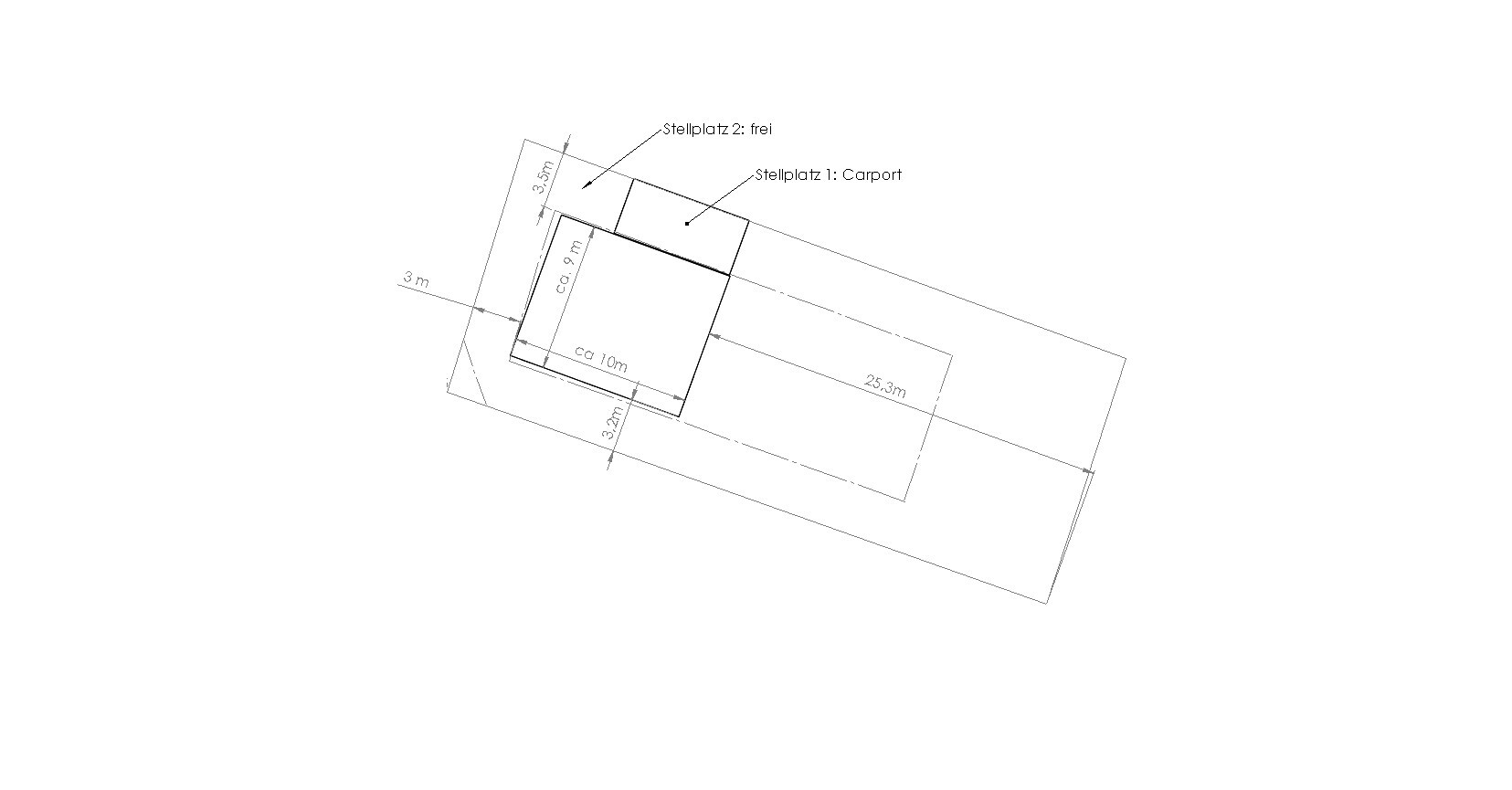

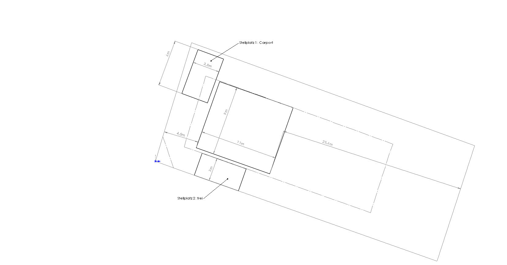

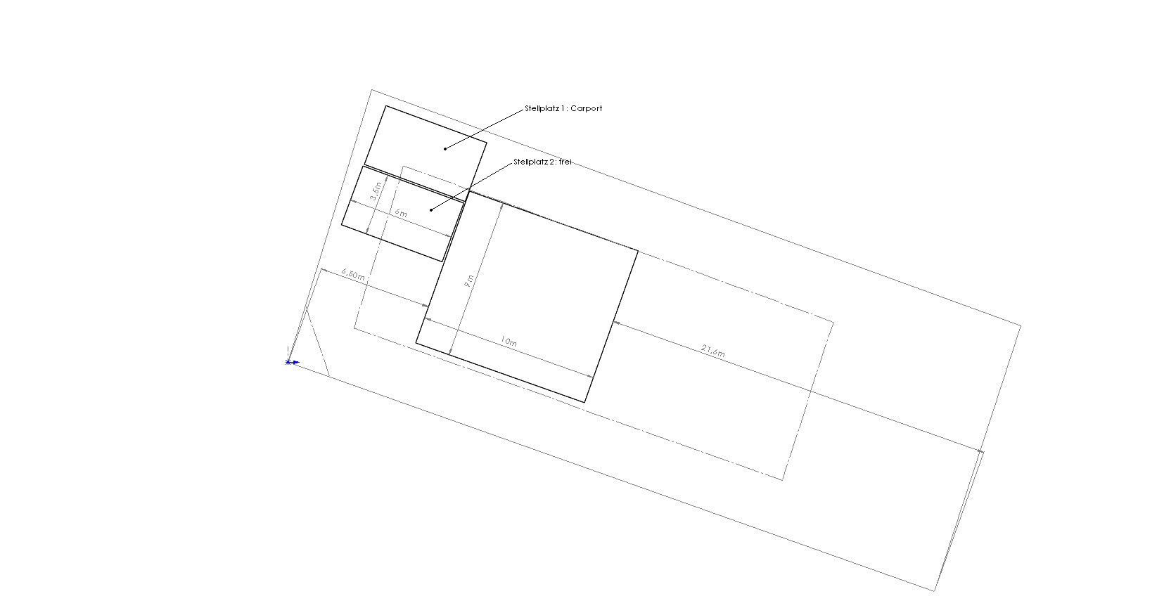

We visited the local building authority today to gather some information that I’d like to share with you.
  • The groundwater on our property is at about 20-30m (65-100 ft) depth with very gravelly soil – no standing water – so we are considering a masonry basement instead of a waterproof concrete one.
  • The sewer line is located in the street at about 2.3m (7.5 ft) depth, so a pumping station would be necessary in the basement for any potential laundry rooms (which we don’t plan to have anyway).
  • A carport up to a maximum height of 3m (10 ft) is permitted in the front setback area.
  • In the side setback area, a carport, garage, or a “lesser” outbuilding (i.e., without a function for the dwelling, no boiler room, etc.) up to a maximum height of 3m (10 ft) is allowed.
Here are the three versions of parking spaces we are currently discussing:
1.) Parking spaces on the north side:
Advantage: Very space-saving; instead of a carport, a garage could also be built.
Disadvantage: Very tight – especially considering that cars might become wider in the future (SUVs) or that more space might be needed for getting in and out as we get older.
2.) Parking spaces at the front and side:
Advantage: Still relatively space-saving, but plenty of room for getting in and out; parking space 2 on the south side does not block sunlight to the house since it is not covered.
Disadvantage: Parking space 1 may not be enclosed as a garage, parking space 2 may be, but this could block some sunlight; it might be tricky to maneuver when driving in and out towards the carport (however, some friends of ours have solved it this way without any problems).

Floor plan of a building with a carport and two parking spaces, parking space 2 free.
Angular floor plan: house with carport and two parking spaces, dimension lines visible.
Site plan of a building with carport parking space 1 and free parking space 2, dimensions shown.
