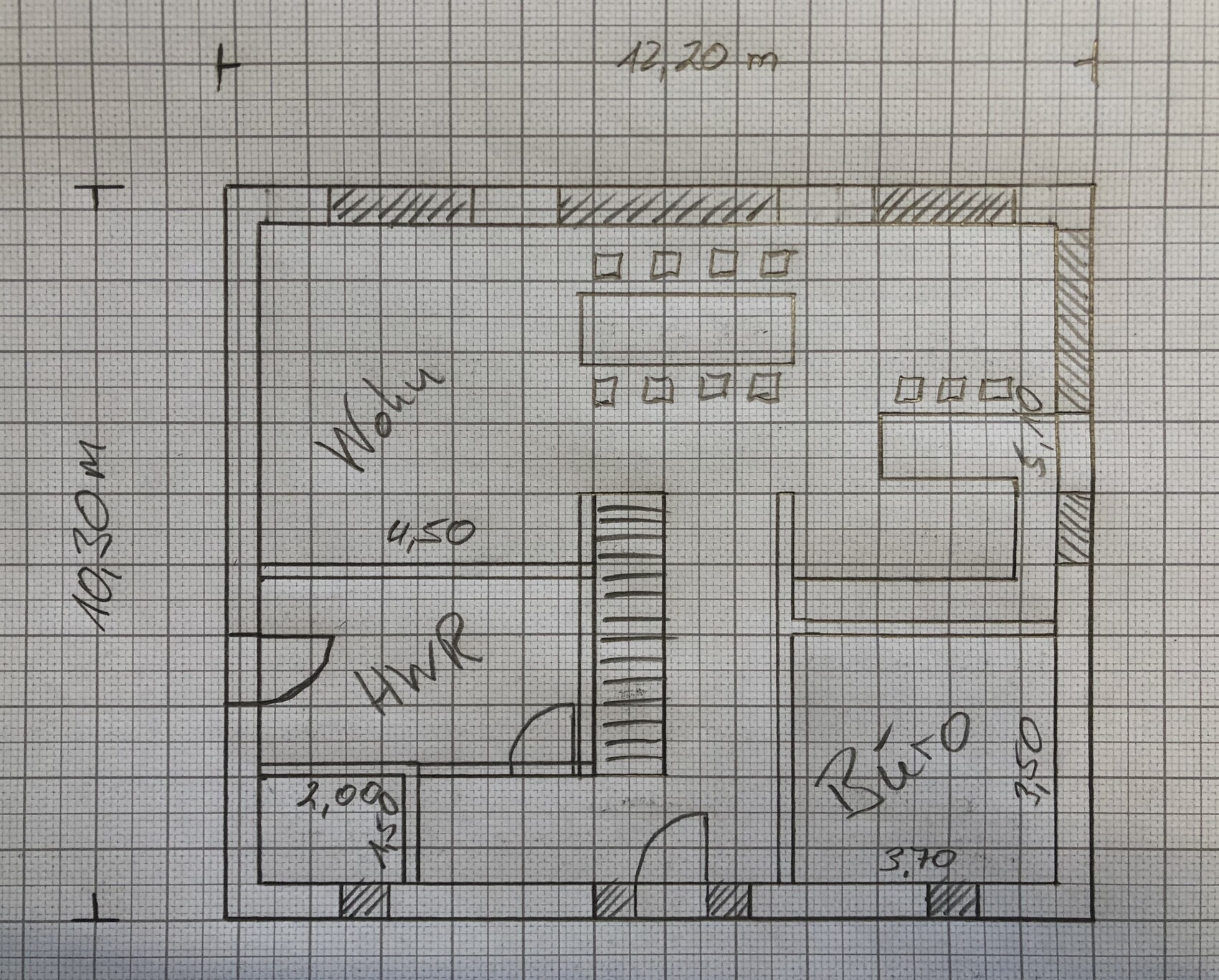

Hello dear forum community,
since the first draft from the draftsman didn’t quite match my taste, I took pencil and paper myself today to create an initial sketch.
What do you think?
The drawings are oriented to the north.
Rectangular floor plan with living area on the left, dining table in the center, office on the right, staircase in the middle.
Hand sketch of an apartment floor plan: bedroom with two beds, kitchen, bathroom, hallway, and stairs.
Plot size: 700 m2 (7,535 sq ft)
Slope: no
Site occupancy coefficient (floor area ratio): 0.3
Floor space index: 0.6
Building window, building line and boundary: 3 meters (10 feet) distance from neighbors
Edge development: allowed for garage/carport
Number of floors: 2
Roof type: open (0 to 30 degrees)
Style:
Orientation: south/west
Maximum heights / limits: eaves 6 m (20 ft) / ridge 9.5 m (31 ft)
Homeowners’ Requirements
Style, roof shape, building type: offset shed roof (14-20 degrees pitch) with east/west orientation
Basement, floors: no basement, 2 full floors
Number of occupants; age: 2; 30, 25 years old
Space requirement on ground and upper floor: approx. 170-180 m2 (1,830-1,940 sq ft) total
Office: home office
Guest sleepovers per year: approx. 10
Conservative or modern style: modern
Open kitchen, kitchen island: open kitchen; peninsula
Number of dining seats: permanently 8 plus 3 at the peninsula
Fireplace: no
Garage, carport: undecided yet
Additional wishes / special features / daily routine, also reasons why something should or should not be:
Terrace facing west/south; large window front with external blinds on the ground floor; daylight in the upstairs hallway
Who designed it: do-it-yourself
What do you especially like? Why?
What do you dislike? Why?
Personal price limit for the house, including fixtures: 480,000 EUR
-you can give up: straight staircase
-you cannot give up: large windows on the ground floor
Why does the design look the way it does?
Mix of many other designs
What is the most important / fundamental question about the floor plan summarized in 130 characters?
What can still be improved? Can the floor area be reduced a bit?
11ant4 Sep 2020 17:28
As you know, I appreciate every analog drawing.
Orienting the plans to north is good – but on which plot?
I can’t make out anything about the shed roof from the floor plans; please show more.
If the draftsmen’s plans were the basis here, please show those as well and explain where and how the changes were made.
4 Sep 2020 17:46
First of all, a relief for the eyes – the dimensions are self-explanatory.
Nevertheless, please upload the planner’s design since you are referring to it.
And the site plan, please.

Could you please mark north on the plan? Oriented to true north would mean north at the top, but that doesn't align with the terrace.
11ant4 Sep 2020 17:56
Zubi123 schrieb:
Unfortunately, I’m not allowed to share the initial drafts from the draftsman :/
Then why not provide us with some elevations for your floor plans? Neighboring properties are also missing: the street seems to be at the bottom of the plan (?), but where does the angled line come from—is the street turning there?
