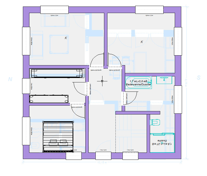

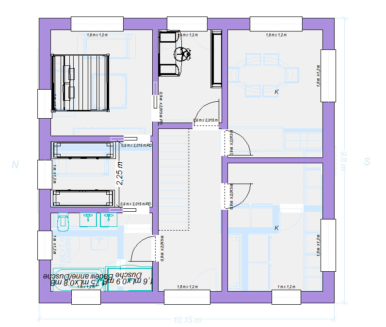

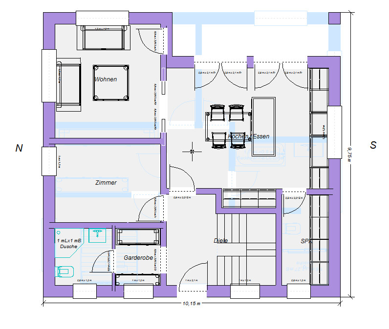

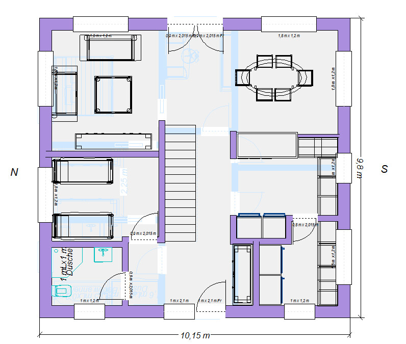

I experimented again with the front door facing the street and came to the conclusion that the orientation towards the sun might not need to be overemphasized for this plot. Instead, focusing on the garden could be more beneficial. Using the full width (10m (33 feet)) makes the house open up more attractively towards the terrace, in my opinion.
However, I always end up with a width of 10.15m (33 feet 4 inches). That seems to be a magic number. Hence the question...
Option 1:
Option 2:
(Stairs without landing)
Option 1:
Option 2:
