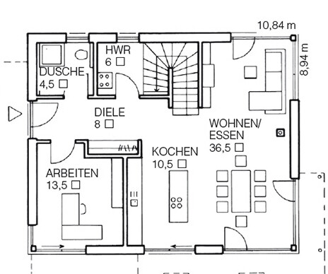

Gugelhupf22 Mar 2019 21:13Hi Katja,
Thank you very much for the design!
I just reviewed it with my wife, and we really like it!
Regarding the parking spaces, we will place the "main parking spot" in the carport as you suggested.
We will likely make the second parking space a diagonal/parallel parking spot in the front building setback area, since it is only required for the building permit/planning permission but will not actually be used.
This should allow us to move the house to about 4.5 meters (15 feet) from the street boundary, gaining approximately 1.5 meters (5 feet) compared to your sketch.
We are still considering whether to build the staircase bay window as shown or to widen the sofa/TV area instead so that the wall becomes straight.

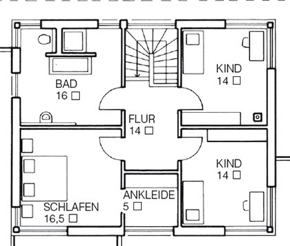

Upstairs, we prefer the 5-room version, but we would mirror it slightly so that the children’s rooms face the garden.
I included the bay window to make the design less boring and to set the staircase back a bit, otherwise the hallway would become too narrow. (Note: the staircase is not a landing! This is a display issue.) Removing the bay window would probably be possible. However, the children's rooms on the other side would then be quite dark. That’s not ideal for playing. Also, the bed is ideally positioned facing east. But everyone has their own preferences.
I found a similar suggestion at Kampa. The wall thicknesses are probably key to making it look more appealing. The chill-out area seems a bit tight, but maybe that’s just the impression. The layout is very open, which might make it too noisy with children. But I don’t think that’s necessarily a bad thing.
The house is listed at about 160m² (2 x 79.5). That gives you an idea of the scale.
Gugelhupf schrieb:
We will probably design the second parking space as an angled or parallel parking spot in the front building setback area since we only need it for the building permit / planning permission but won’t actually use it.
This should allow us to move the house about 4.5 meters (15 feet) closer to the street boundary, gaining roughly 1.5 meters (5 feet) compared to your sketch. Every blade of grass seems to count here, huh?
Think carefully about this. With a garden depth of 38 meters (125 feet), you definitely won’t be lacking at least 1 meter (3 feet) of green space behind the house in the end. But guest parking spaces are usually very valuable. Our lot is also about 40 meters (130 feet) deep. We set our house back 12 meters (40 feet) to have distance from the street and room for four cars (two for us and two for guests). I’m always glad when our guests can just drive straight in without hesitation. Besides that, having a front garden is a nice thing where gardeners can really show their skills.
