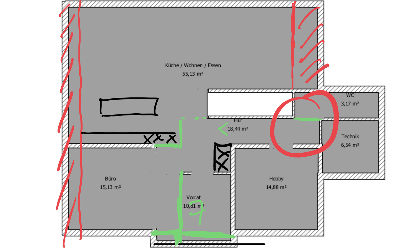

Without plot details, you can’t say anything. Your orientation isn’t great right now. Sloping site… no constructive input can be given, and no changes suggested.

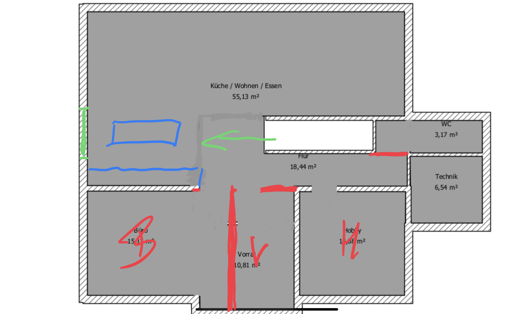

I am also thinking more along the lines of a partially buried urban villa. There’s nothing attractive about it if the house doesn’t work with the floor plan. Maybe everything here has its justification, but we don’t know the background.
Regarding your last suggestion (apart from the fact that there’s still lots to clarify between you and the general contractor):
Upper floor, already outlined in words:
For the ground floor, if I were to change anything, it would be like this:
The green area would form a nice view axis toward
Or reduced somewhat, because it really isn’t covered (in the sense of usable) area.
If you remove the silly symmetry of the sleeping area, you can come up with something reasonable here too. Ultimately, it’s an urban villa floor plan that has already been inflated by the wide corridors needed for the straight staircase.
The south-facing WC without a window, but with panoramic windows in the north hallway, is quite bold for our climate 😉
kati1337 schrieb:
Contrary to my original plan, I have now imported it into SH3D and tinkered with it a bit.
I abandoned the massive garage and plan to build a smaller carport with a shed separate from the main building.
I have slightly widened the main house. Hobby room and fitness room have been swapped. Guest room and fitness room have been combined on the upper floor.
Overall, it’s probably still too many square meters. Maybe the entire layout can be reduced by a few centimeters on each exterior side so the total square meters become a bit smaller.
Reducing just a few centimeters per building side won’t help you...
Your floor plan is over 240 square meters (over 2,583 square feet)... For a sloped lot and a budget of 550k. Sorry, but it’s starting to feel just arrogantly unrealistic how many warnings are being ignored here...
