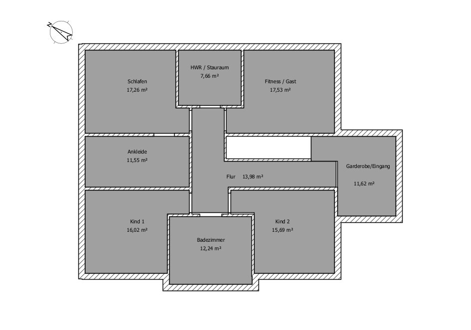

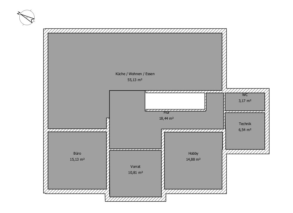

Contrary to my original plan, I have now imported the design into SH3D and made some adjustments.
I discarded the massive garage and instead plan to build a smaller carport with a storage shed, separate from the main building.
I have slightly widened the residential house. The hobby room has swapped places with the fitness room. I combined the guest and fitness rooms on the upper floor.
Overall, it is probably still too many square meters. Perhaps the entire layout can be reduced by a few centimeters on all external sides to lower the total floor area slightly.
Floor plan of an apartment with bedroom, children’s rooms, bathroom, hallway, cloakroom, and utility room.
Floor plan of a house: kitchen/living/dining, hallway, office, pantry, hobby room, WC, technical room.
