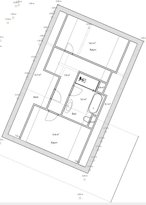

Option 2 with possible attic conversion
Ground floor (GF)
The stairs in the garage are just a test. The stair window is still missing. The 6 steps in the corner are also missing.
Basement (B)
Attic (A)
I do not have elevations for option 2 yet.
I have adjusted the terrain modeling.

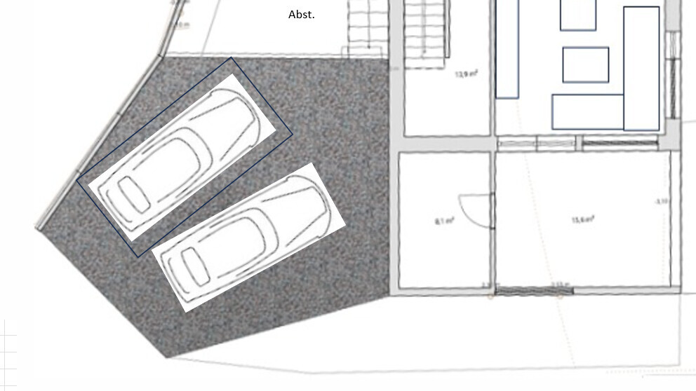

hanghaus202319 Feb 2025 13:43K a t j a schrieb:

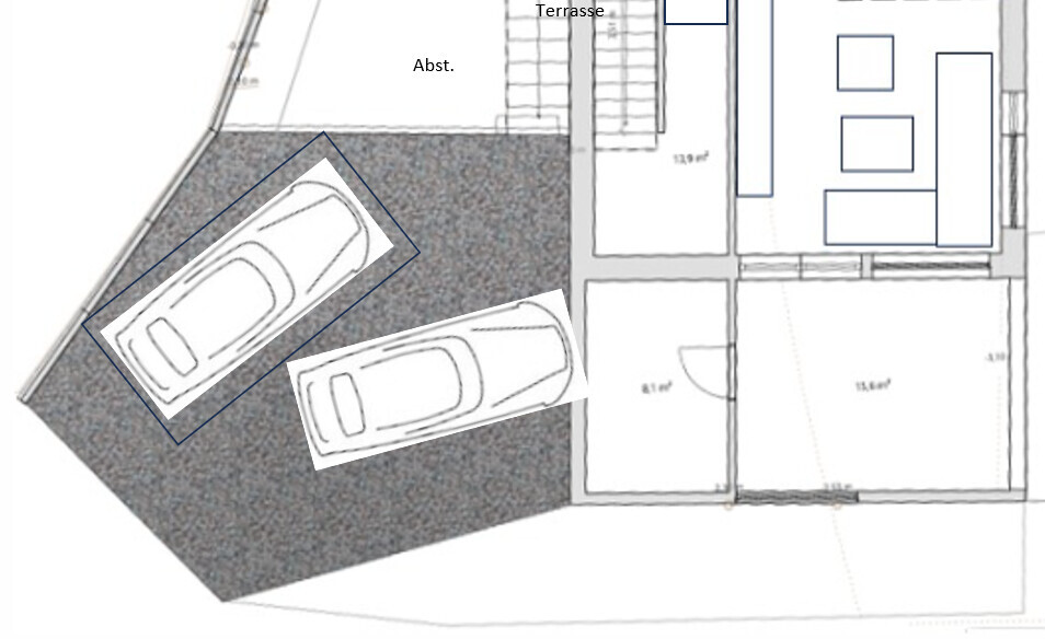

Why is this necessary again?Because the property boundary is the same as the building boundary, but the 3 m (10 feet) setback still applies. This concerns the corner in the southeast.hanghaus2023 schrieb:
Since the property line is the same as the building limit, but the 3 m (10 feet) rule still applies. This concerns the corner in the southeast.And you really want to build right up to the boundary? Is that because of the slope or another reason?H
hanghaus202319 Feb 2025 15:36K a t j a schrieb:
And you really want to build right on the property line? Because of the slope or another reason? I’m hoping for a simpler excavation because the foundation will be further away from the neighbor’s property boundary. If I build parallel to the boundary, the excavation would be only 3 m (10 feet) from the neighbor’s property, and I feel uneasy digging 3 m (10 feet) deep so close to their land. On the north side, I’d only need to excavate about 1 m (3 feet) deep because the natural terrain is already much lower there.

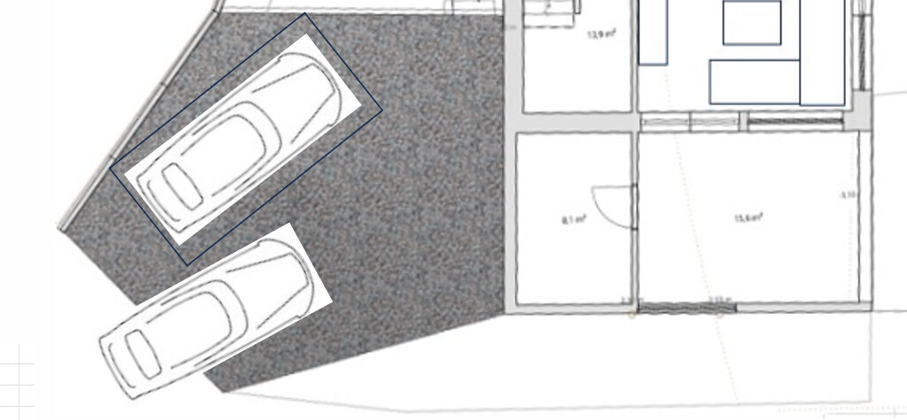

2 cars work. With hanghaus2023 schrieb:
and without garage. That is not correct.
Two cars can park on the driveway, but no car can exit the garage if one car is parked on the driveway.

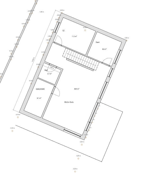

hanghaus202324 Feb 2025 17:05@ypg I tried to apply your suggestion with the rotated staircase. The ground floor is now a small apartment. The attic is prepared for conversion. Knee wall height is 35cm (14 inches).
Is the basement then a rentable unit? Or a cellar?
Unfortunately, the windows in the attic are not visible in the floor plan, but they appear in the elevation view.
For the basement, could the entrance from the north be accessible via stairs along the slope?
