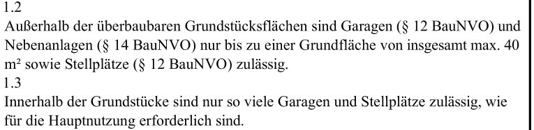

Then no more than 40 sqm (430 sq ft) applies and is necessary.
The exact requirement can be found in your parking space regulations.

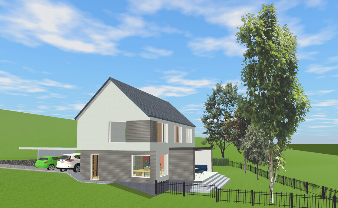

I have made significant progress. I have abandoned the original plan.
Why? The old plan involved filling almost completely up to the neighbor’s retaining wall. In hindsight, not a good idea. The new plan is to create the driveway with a 10% slope. The bottom edge of the neighbor’s retaining wall drops by 2.5 m (8 feet) to the north. That corresponds roughly to the 10% slope. This means my parking areas are now 50 cm (20 inches) lower. Then there will be 3 steps leading up to the ground floor level. There will no longer be a basement. On the east side, either steps will be built as shown in the picture or the area will be filled in. (We’ll see what the city says about the steps, since this is within a green area that must not be built on.) The big advantage is that now a standard house can be planned according to the local design guidelines.
