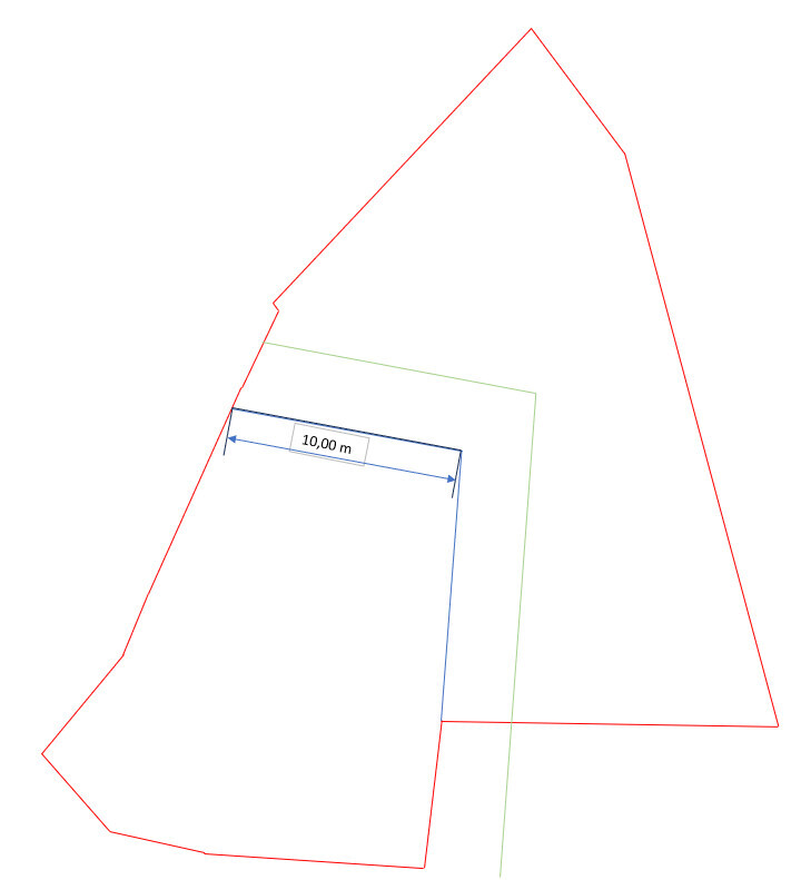

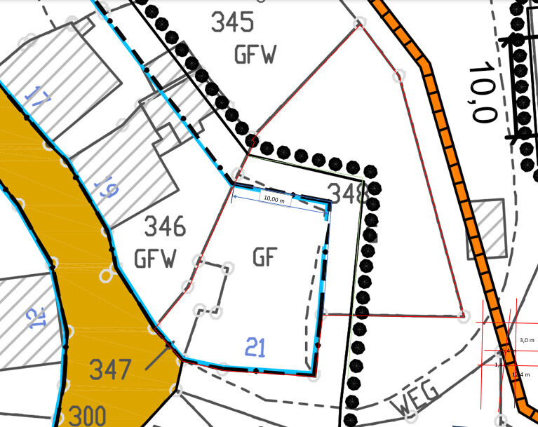

Here is an excerpt from the development plan and the plot shown as a blank layout. The green line marks the boundary to the green area, which must not be built on.
Plot plan with blue outline, orange boundary line, and measurement lines on the map.
The path is privately owned. The owner has been asked for an easement on the south and east sides and has at least given a verbal agreement.
Plot floor plan with red border and blue building area on the plan
I have linked all documents in the green thread. Unfortunately, this is not possible here.
