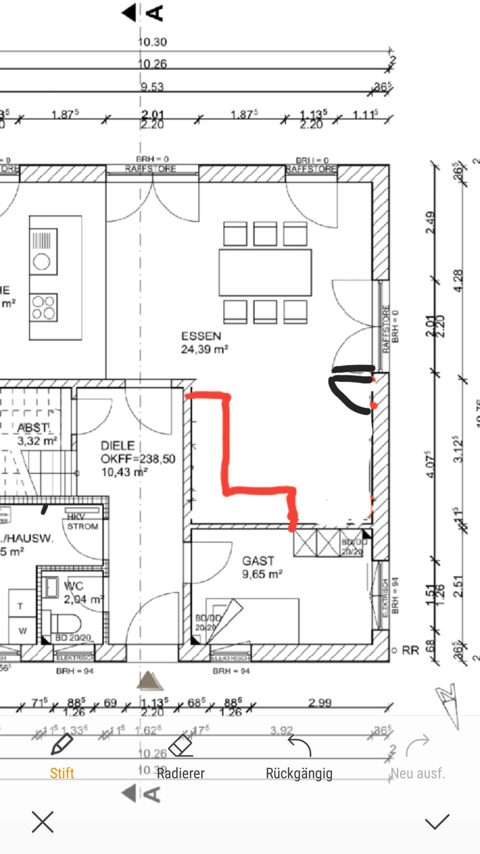

Plot size 492 sqm (5293 sq ft)
Slope yes
Site coverage ratio?
Floor area ratio?
Building envelope, building line, and boundary?
Boundary development?
Number of parking spaces 2
Number of floors 2
Roof type Pyramid roof, 25 degrees
Architectural style Modern urban villa
Orientation Main entrance facing north
Maximum heights/limits
Additional requirements?
Clients’ Requirements
Modern urban villa with pyramid roof, 25 degrees
Basement, floors 2 full floors without basement
Number of occupants 4
Open kitchen, kitchen island
Number of parking spaces 8-10
Garage
Who designed it?
-Architect
Large living area, master bathroom
What don’t you like? Why?
Utility room quite small and master bedroom small, children’s room somewhat too large
The architect implemented the corresponding wishes
What do you think is especially good or bad about it?
Good: large living area
I am uncertain about the half-height window sizes and the swing direction of the doors
What do you think about the floor plans?
Slope yes
Floor area ratio?
Number of floors 2
Garage
Who designed it?
-Architect
- Where could it still be optimized? Would you recommend different window dimensions or sill heights?
- What do you think is poor or what would you do differently?
- A partition wall will be added in the walk-in closet. That would theoretically allow watching TV from the bed. I am considering a lightweight wall. I plan to place a 211cm (83 inches) Pax combination wardrobe in the closet. The closet is planned with a raw width of 218cm (86 inches). Do you think 218cm is enough for the Pax once the walls are plastered, or how wide should the rough dimensions preferably be?
- Is the hallway on the ground floor too narrow?
- Would you raise the ground level? The house would be 40cm (16 inches) below street level. If I build a terrace into the garden, it would be about 1m (3 ft) difference. You could raise only the house level, resulting in approximately 1.6m (5 ft) difference between terrace and garden. I don’t know anyone living below street level. Raising the garden would probably not be allowed without permits, and affected neighbors likely wouldn’t agree. On the sides of the house adjacent to neighbors, raising is permitted only up to certain limits. I am overwhelmed with the decision.
- Do you have any ideas for arranging the sofa differently and placing the TV sensibly? My husband doesn’t want the sofa back facing a window. I still need to get used to placing the sofa in the middle of the room.
- Is the kitchen size sufficient for a nice kitchen with an island?

Okay, I’m not fully committed to this townhouse concept. I really like these floor-to-ceiling windows, and the horizontal bands of high window sills remind me a bit of a basement. That’s why I prefer floor-to-ceiling windows. I find them stylish and modern. But at the same time, I don’t want to feel like I’m sitting in a greenhouse or have too many windows—I need some wall space for privacy and furniture placement. Especially the new TV area without windows—that part I liked exactly for that reason.
But now I’m really worried about sitting there in the dark. My nightmare is that any room won’t get enough natural light.
I’m concerned about:
- The TV corner
- The parents’ bedroom
- The staircase area, because the window sill height is 90 cm (35 inches) on the upper floor (1.76/1.26) in the next version coming soon
What do you think? Is there enough light?
@11ant
I actually like the floor plan overall. What’s your specific advice for me without having to change it completely?
I admit I’m feeling overwhelmed by the floor plan and want to finalize it feeling satisfied.
And I think the floor plan isn’t totally off, or does it feel like we got lost somewhere or it’s somehow awkward?
- The TV corner
@11ant
