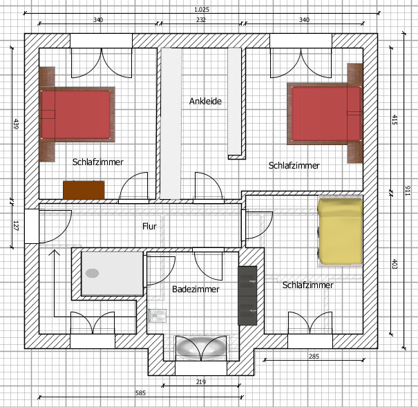

I need a bit of help with my floor plan – feedback, tips, suggestions – anything is welcome!
I’m having a city villa built through a general contractor (10.25 x 9.15 meters (33.6 x 30 feet)). They already have a standard floor plan, but I don’t like it. Here are our wishes:
It’s almost impossible to fit all this into 140 sqm (1507 sq ft), so I need someone who understands floor plans better than I do. My biggest problem is the layout of the bathroom as well as the staircase (this will be a quarter-turn staircase, 16 steps, 19.5 cm (7.7 inches) riser height, 26 cm (10.2 inches) tread depth). Maybe too steep? I’m leaning towards adding a bay window at the entrance so that, because of the length of the staircase, there’s more space left in the living room – or even to increase the living area completely?

The utility room will not work. It is too small for the house connections, fuse box, ventilation, heating system, washing machine, and dryer.
The bathroom upstairs is clearly a leftover space, and it shows. Swapping the shower and toilet might help. Whether this thin wall by the sinks will hold up is questionable.

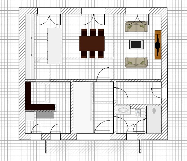

So, we were able to agree with the municipality to change the plot. It is located directly opposite on the other side of the street. 550 sqm (5,920 sq ft), offers less privacy as it is surrounded by neighbors on the south, east, and west sides. However, we can improve this with strategic planting. An entrance on the north side would now be possible.

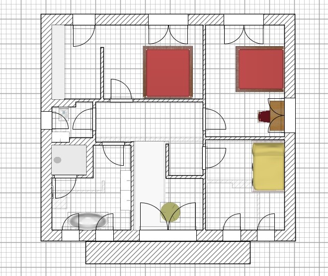

I have also been working on the floor plan again—probably still not perfect, but an improvement compared to the previous versions, in my opinion.

I have also been working on the floor plan again, probably still not perfect but, in my opinion, an improvement compared to the previous versions.I know that one. It has already been discussed back and forth.
Bizzy schrieb:
I have also been working on the floor plan again, probably still not perfect, but an improvement compared to the previous versions, in my opinion.As a layperson, I would suggest at least swapping the kitchen and the living room.
Reason: Evening sun / west-facing sunlight can usually be enjoyed longer – if you work during the day – than the eastern morning sun. So, it makes sense to move the living room to the prime southwest side and place the windows there.
Child 2 would have only a north-facing window.
