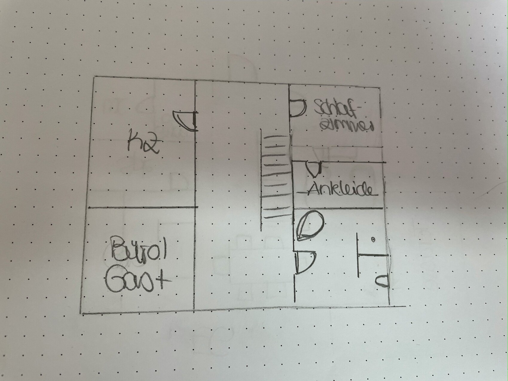

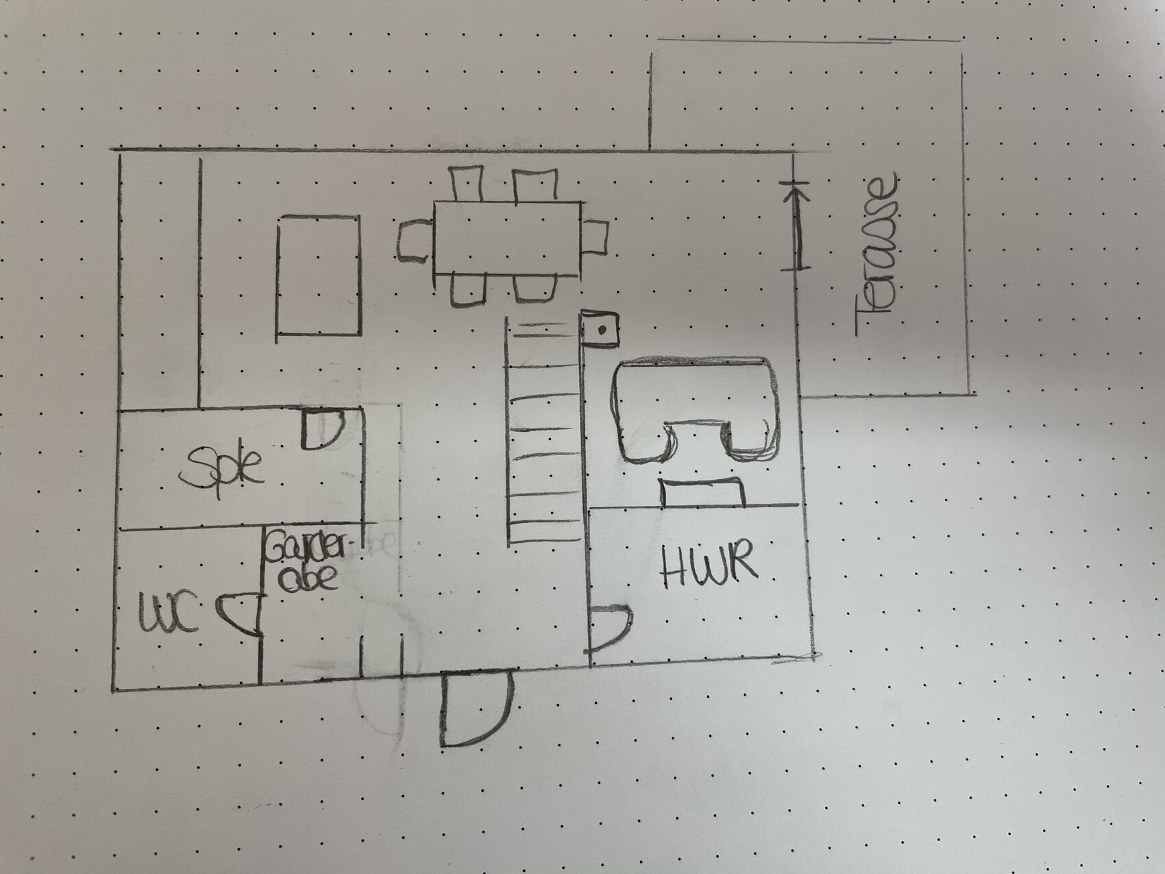

For our future construction project, I am mainly looking for ideas and support regarding the optimal use of our conditions.
We plan to build a city villa with a hipped roof.
We are still quite open about the living area but are currently considering around 140-150sqm (1,507-1,615 sq ft).
We, the builder and I, currently live with our dog in an apartment. At most, one child is planned.
We already have rough ideas and, based on these, have sketched a floor plan without dimensions or details (see pictures).

Always draw to scale. Graph paper with 1 square of 5mm (2 inches) = 50cm (20 inches).
Draw in furniture you want or already have, also to scale.
The tape measure will become your best friend. Walk through your own apartment and others with open eyes. What feels too tight now should be made larger, what is optimal should be kept as is.
Regarding your sketch:
Corridors too wide
Swap living and kitchen areas on the ground floor
Corridors too wide
The proportions don’t seem “right” to me, but I’m not a professional.
The upstairs hallway takes up one-third of the space.
The staircase seems too short but takes up an enormous amount of space.
Meanwhile, the master bedroom is tiny.
The fireplace is directly next to the sofa.
The sofa is placed right against the wall (are you nearsighted? ;-))
and so on.
Instead of spending time on a self-made floor plan, I would a) look for pre-designed floor plans that you like, and b) write down exactly what you want and what the limitations are, including the dimensions of your desired furniture.
Then take this to a professional.
and so on.
Myrna_Loy3 May 2021 10:31minimini schrieb:
The proportions don’t feel quite right to me, but I’m no expert.
The staircase seems too short and takes up an enormous amount of space.
The fireplace is right next to the sofa.
The sofa is placed directly against the wall (are you nearsighted? ;-))
and so on.
Instead of spending time on a DIY floor plan, I would a) first look for pre-designed floor plans that you like. b) write down exactly what you want and what limitations you have, including the dimensions of your desired furniture.
Then take everything to a professional. Yeah, there are plenty of houses with exactly this floor plan and these requirements here in the forum. Just browse around a bit.
One thing I’ve noticed is that there’s hardly any storage space in the living room, or play area for a planned child. That child also always comes into the living room with dirty shoes from the garden… (this is the same for us, typical mid-terrace house issue… I would handle it differently in a detached house!)
Try also going through a “typical day.” For example, I would find the dressing room upstairs annoying, because my husband goes to bed much later than I do and then fumbles around putting away his things or similar. Having access to the bathroom would be great if I’m already planning a dressing room.
hej.eigenheim schrieb:
2. The living room has to be on the right side because that is the only place where there is land available for a terrace and garden.Where is north? At the top of the plan? And why put the living room next to the terrace... dining and kitchen areas next to the terrace are much more practical.Similar topics
