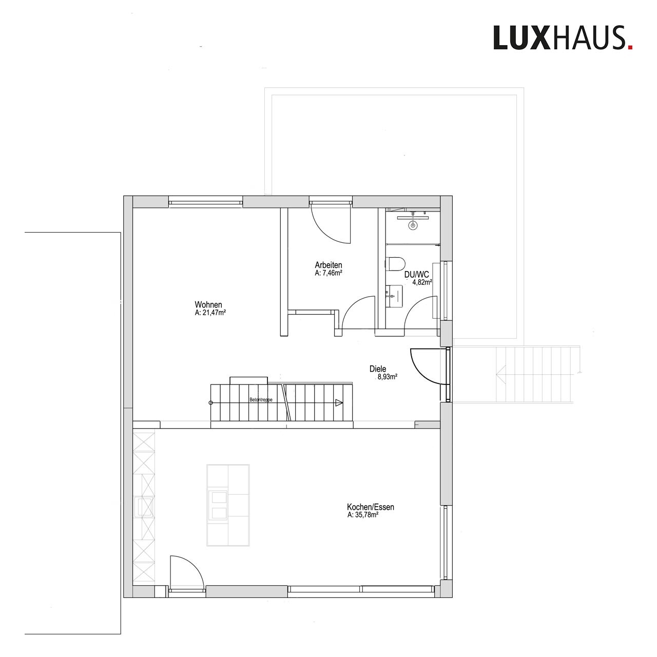

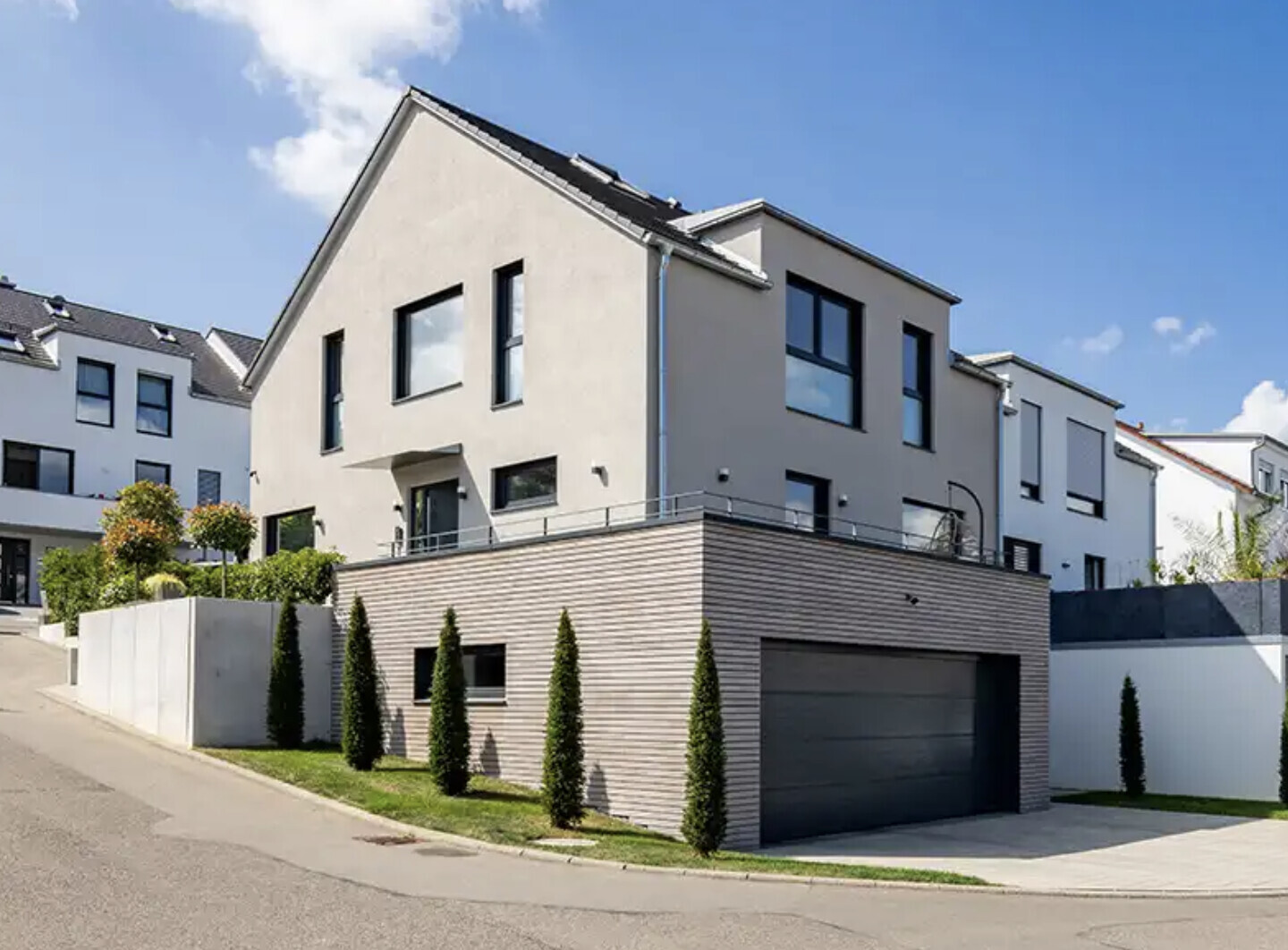

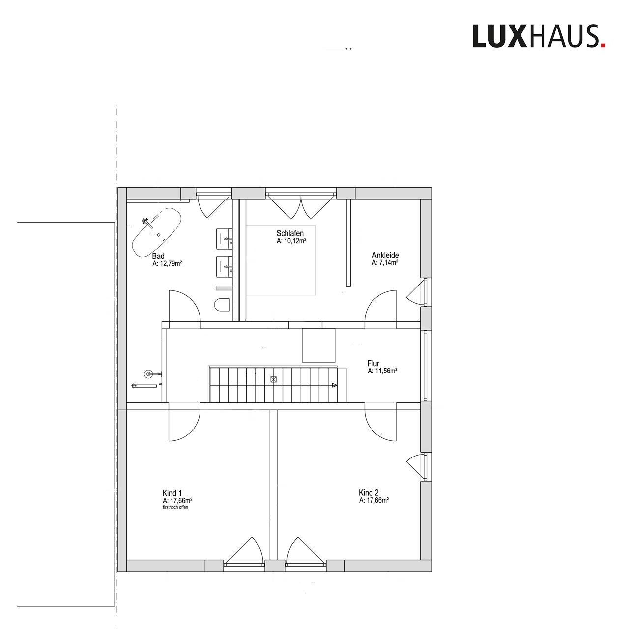

Since I’m clearly not an architect, I continued looking for inspiration and found a floor plan that meets many, if not all, of our requirements and, I believe, can be very well implemented on this plot. Yes, it’s a house with a basement again, although that was initially dismissed for budget reasons. If the house is built smaller (here 128 sqm (1375 sq ft)), it should appear to fit within our budget at first glance. Additionally, the plot has a height difference of about 3 m (10 ft) from one end to the other. A solution for this would have had to be found anyway.
Why this floor plan?
  • The house is somewhat narrower and fits within the building envelope/planning boundary, leaving plenty of space between the neighbor’s hedge and the house
  • The straight staircase does not start near the entrance (which we see as a positive)
  • The study is located at the top of the plan and has direct access to the garden
  • The living room is on the left side of the plan, has direct access to the terrace, and receives a lot of sunlight
  • The kitchen has a large cooking island, and the dining area offers a nice view
  • The staircase landing faces a window where the morning sun should be visible. The hallway is no longer dark
  • The bedroom faces away from the street side and features a dormer allowing a view of the garden
  • The two children’s rooms share a dormer; one will be used as a second office. Originally, the office was planned to be at the bottom of the plan to have a good view
I actually see many of our wishes reflected in this floor plan and feel that we would have to make few, if any, compromises. The basement raises the entire house and further improves the view. Since the house is already situated on a hill, the basement on the lower side would provide a good outlook over the landscape. The simple geometry (no bay windows) should help keep the project cost-effective.

What are the exterior dimensions?
And how is the roof supposed to be designed?
And why is the terrace connected to the living room? It is usually more practical to have it accessible from the kitchen.
How is the house positioned on the plot?
How is the 80 cm (31.5 inch) knee wall taken into account? See the rooms on the upper floor.
