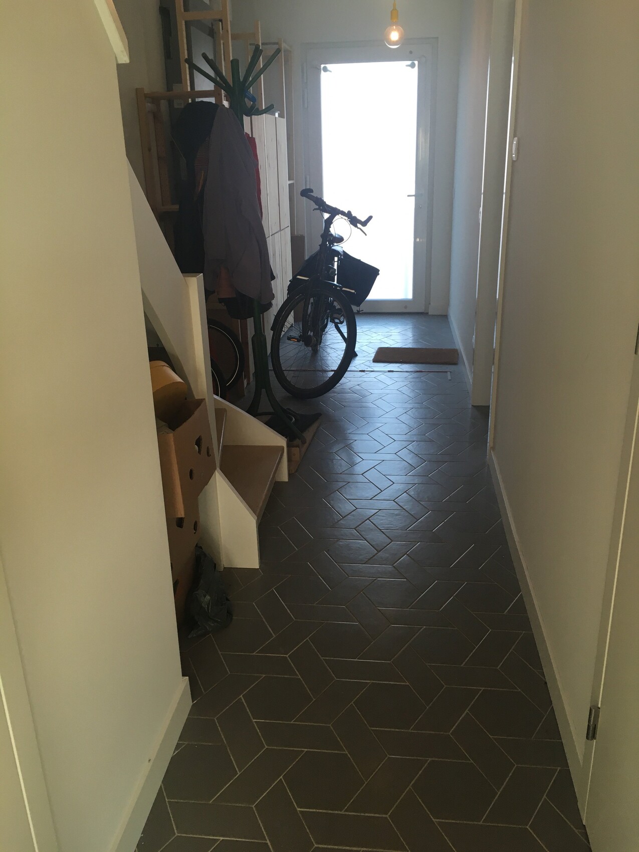

. It won’t help me downstairs, right? The space for the shoe cabinet is next to the kitchen door, but opposite that is the storage room and the restroom, not a staircase that would give me extra space?
One of the two can then be placed lengthwise under the stairs. I have my restroom with a hand basin there. It works great, even for men who prefer to stand. 😀
The other can be rotated lengthwise or you could even have the pantry as just a cabinet along the wall. Then the circulation space you currently need in the pantry to access the shelves and supplies becomes the hallway’s movement area in the lengthwise direction. Since the hallway is also circulation space to reach the pantry, it serves both purposes.
I took a photo: the tape measure on the floor is extended to 180cm (70.9 inches). The cabinets are 30cm (11.8 inches) deep (Ivar from Ikea) and are placed in front of the utility area for me. Behind the entrance door I have water, electricity, and telephone connections, which I want to keep accessible. I also store my bicycle in the hallway. The bike is about 65cm (25.6 inches) wide. The narrowest passage at bike height is 80cm (31.5 inches). That’s roughly what you would have— but constantly. I can also move my bike away. Then I have a 140cm (55.1 inches) wide passage plus storage at that spot.
Bicycle stands in a hallway next to wooden walls and a frosted glass door.
Small hallway with a bicycle in front of the bright door, coat rack on the left, and shoe rack.

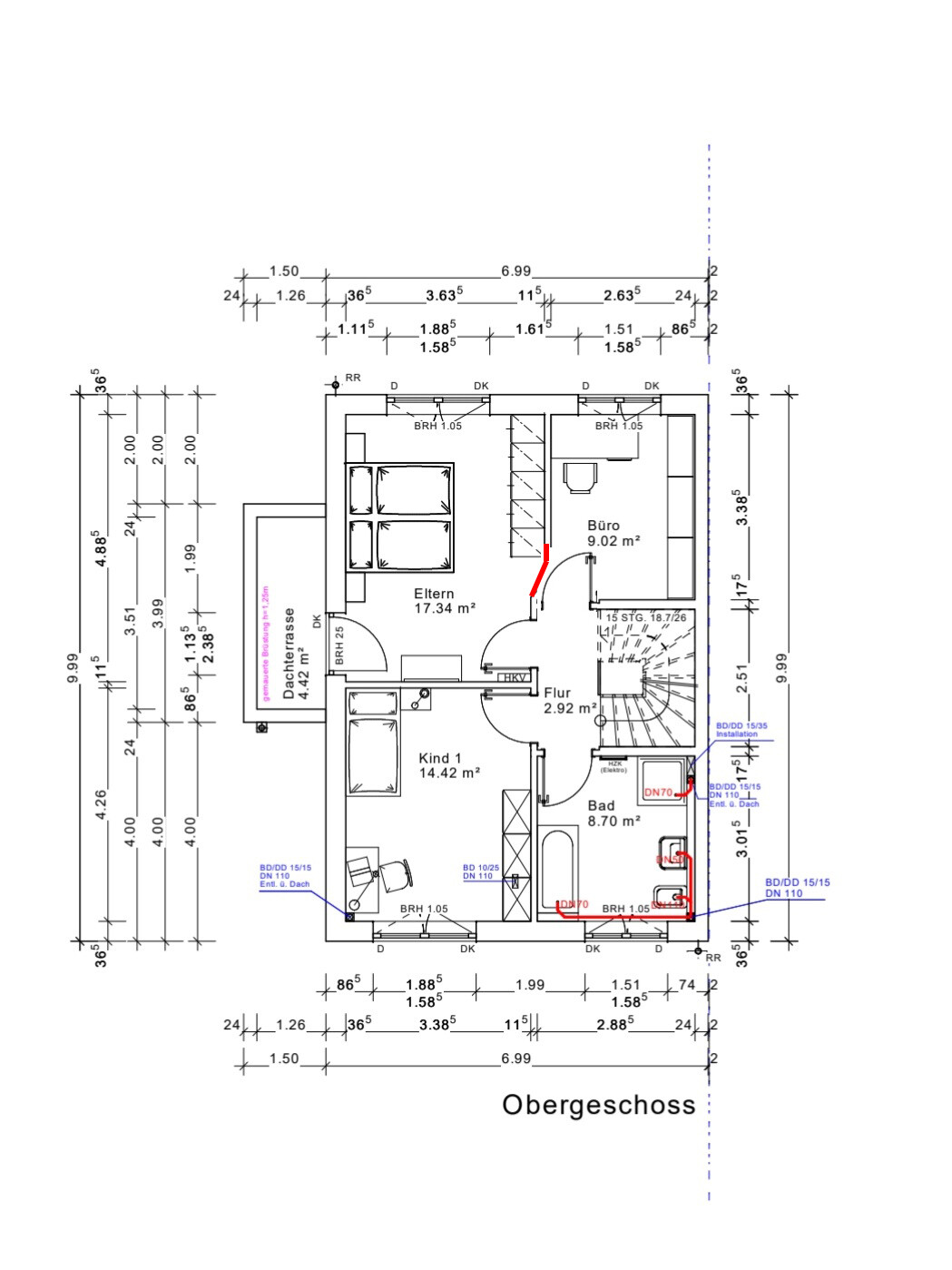

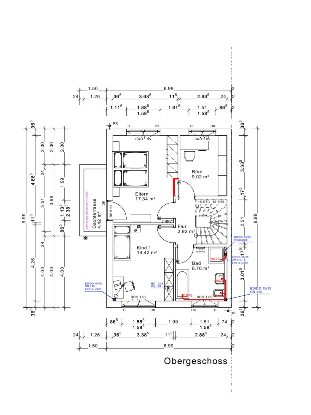

The office door is really a hazard. That’s quite unfortunate. Here are two alternative solutions, though each has its drawbacks.
Option 1 costs you some floor space. In such a small house, that’s a significant loss. But it’s still better than having the door slam right in your face.
Grundriss Obergeschoss: Zimmer Eltern, Kind 1, Büro, Flur, Bad, Dachterrasse.
With option 2, the door feels like it opens the wrong way (not into the room, but toward the wall). That’s manageable—you can still open it wide. However, you’d need to adjust the sloping ceiling slightly, and the bedroom floor space would remain intact. The big question is whether the masons are precise enough to get it right and not mess it up. They have to keep the door swing area in mind. In such tight spots, I like to be on site to keep an eye on things. It’s best to mark the door swing and wall slope on the floor with a few centimeters (inches) of extra space for plaster and door frame.

Option 1 is out of the question for me because I want a 3m (10 feet) wardrobe later, and I’ve reserved space for that. I really like option 2 for that reason. I’ll ask the architect if that’s possible—I hope it works out, that would be really great.

But even in the original version, there is no 3m (10 ft) wardrobe shown. Sloped ceiling or not, I’m afraid that space just won’t be enough either way.
Bauherrin123 schrieb:
I really like option 2 for that. Ask the architect if it’s possible—I hope it works out because that would be really great.
As I said, if it’s possible, you need to be there on the right day and keep an eye on things to make sure it’s done properly.

With the original option, it is definitely possible—the architect measured. The wardrobe is drawn in at 250 cm (98 inches), and there’s definitely 50 cm (20 inches) more space available. The only question is whether the door rotation still allows it to fit… I definitely want to keep the option to place a 3 m (10 ft) wardrobe, but I’m considering if it’s worth it, or if I should limit myself to 2.5 m (8.2 ft) and choose a better layout, in case option 2 doesn’t allow for the 3 m (10 ft) wardrobe.
