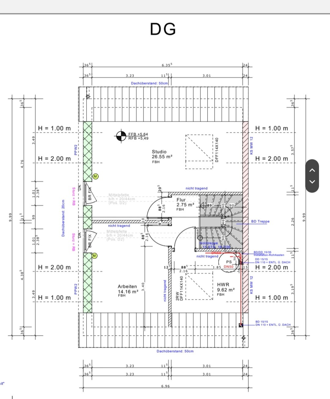

I’m also uploading my floor plan, which I think is finished. I don’t understand how high the ceilings are; can someone tell from the plans? Inside the rooms, how high are they? And generally, do you notice anything about the floor plan?

All technical equipment is upstairs in the utility room; the washing machine is right up against the 1m (3.3 ft) boundary – that looks problematic to me. Where is the heating system and what kind is it... and anyway, where is the completed questionnaire?
The office door swings into the path of the bedroom door. That’s almost a safety hazard. The bedroom wall will need to be shortened a bit, just enough so the door can fit and open properly. The kitchen door also opens the wrong way.
Why do you think you can get a 1m (3.3 ft) knee wall? Is there any chance of approval? Maybe your architect could argue using the height difference. Instead of raising the floor, build higher on top so the “appearance” looks right. I’d give it a try, but first test it verbally to see if the planning office laughs you off.So I’ll draft how I want the living room... I realize it’s going to be tight with some doors, but a sliding door costs 3000 euros, which we can’t afford.
You can submit your version for the upstairs doors, showing how you think things should be moved?
The washing machine thing is really nonsense, I hadn’t thought about it at all. We’ll have a small heating system; that’s how it was in the house I visited, but I’ll check, thanks for pointing that out. The technical systems are actually in the entrance area, directly in the hallway... upstairs, in the utility room, there’s the “tower” of the heating system, whatever that’s called. We will be getting a heat pump.
I haven’t been to the selections appointment yet, so the door swing directions haven’t been finalized; changing that won’t be a problem. But why would you want to open the kitchen door the other way?

I’m summarizing all changes here:
1. Change bay window door to be centered
2. Make kitchen door open inward
3. Change office and bedroom door openings, move doors—but how?
4. Roof space washing machine and sink issue—does everything fit under the sloped ceiling?
