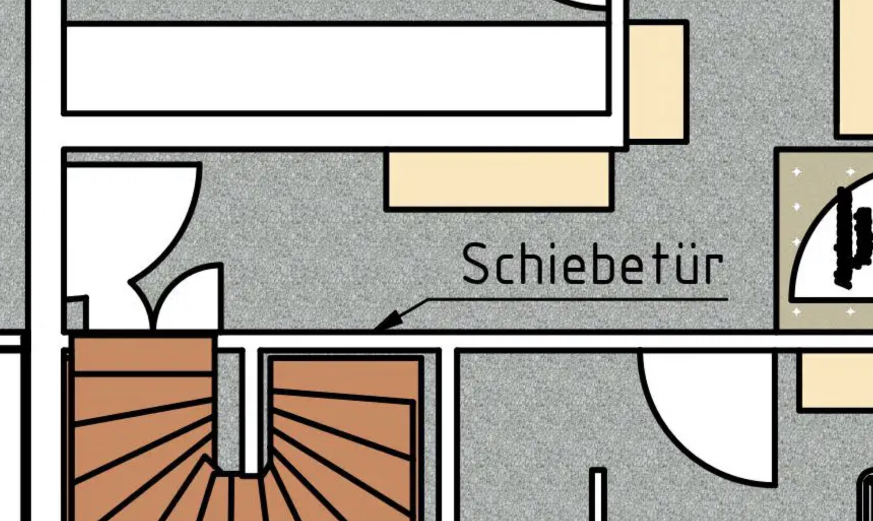

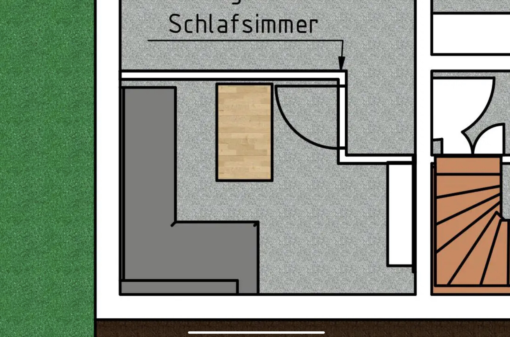

The cramped rooms are somewhat shocking and do not align with the goal that a living space should be at least 8 sqm (86 sq ft). Even a prison cell is larger and more comfortable than these storage rooms. Sorry for the comparison, but your design practically invites it.
Let’s take, for example, these two scenarios:
An undesirable room for a living area.
An undesirable hallway that narrows down...
A staircase that barely meets minimum dimensions and essentially makes it impossible to separate the floors into two independent dwelling units. I also do not see any floor plan that allows for reasonably comfortable accommodation of different life stages.
As a very poor example of good planning, here is a room missing essential installations like drainage and risers, which if installed, would run through the living room far from the heating, along with two (unmarked) doors for a room under 2 sqm (22 sq ft), which makes the bathroom resemble an outdated toilet from the turn of the 20th century, 1899/1900.
With the planned location at the edge of the plot, this would generally not be approved according to common building regulations.

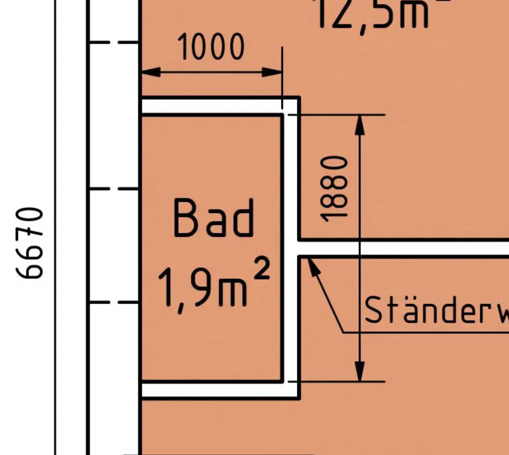

- A childrens’ bathroom shared by both kids, without access from the hallway – no further comment needed.

I thought it was clear that this wall is only a partition, assuming the two floors are completely separated. When the children live at home, this wall does not exist, but it could be installed if the children move out and only two people remain, so the whole space is no longer needed.
The corridor is also, for me, purely a “functional element” used to access the different rooms. I see no point in making the hallway excessively large. I don’t need a “wow effect” when entering the front door; hopefully, this is felt in the living and dining area instead. Regarding the sliding door in the corridor, it should be noted that it is open 99% of the time and serves merely for a potential separation between floors.
I am myself unsure how sensible the bathroom in the children’s room is. Its main purpose is to shorten the route for the kids, especially when they are younger. In a hotel, for example, the bathroom is often directly in or next to the bedroom and is functional. The doors would open into the children’s rooms on the long wall. I cannot disagree regarding drainage/riser pipes, as I honestly lack experience here. Could you please specify this more concretely? My idea was that relevant pipes would have to be installed in this area anyway for a potential future kitchen.
An undesirable corridor that narrows…

- A children's restroom shared by both, without hallway access — no further comment needed

- See my previous post — I’m still undecided about whether an additional toilet is truly useful. There are advantages and disadvantages. However, I can’t fully follow your points. The children share the main bathroom with the parents anyway. The small bathroom is primarily intended to make nighttime visits and brushing teeth before or after sleeping easier. For longer use, the main bathroom or, if occupied, the bathroom on the ground floor will be used. As already mentioned, in hotels the bathroom is often located within the bedroom itself.
