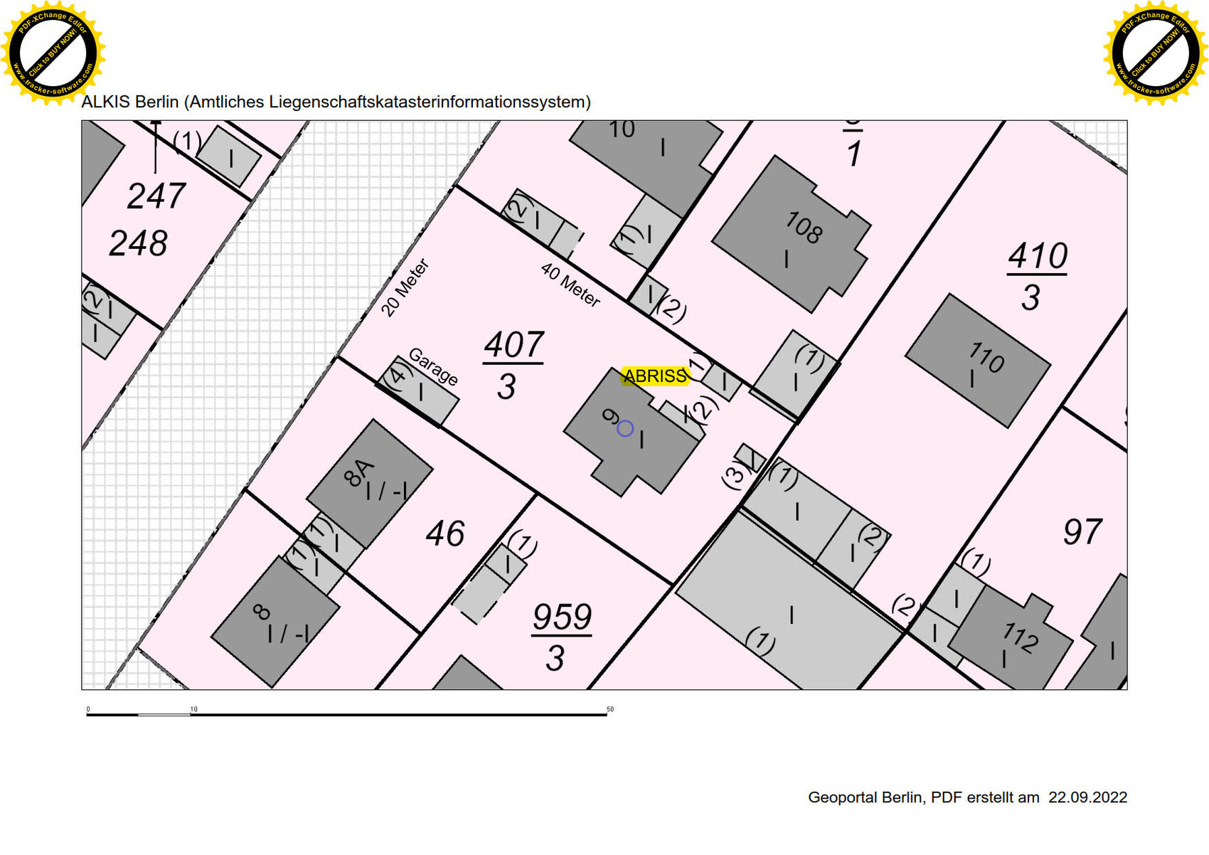

Plot size: 796 sqm (8,570 sq ft)
Slope: none
Site coverage ratio: 0.2
Floor area ratio: 0.4
Building lines / boundaries: 5 meters (16 ft) from the street, 3 meters (10 ft) from neighbors
Edge development: garage existing, should remain
Number of parking spaces: none (on the street)
Maximum height / limits: none, buildable according to §34

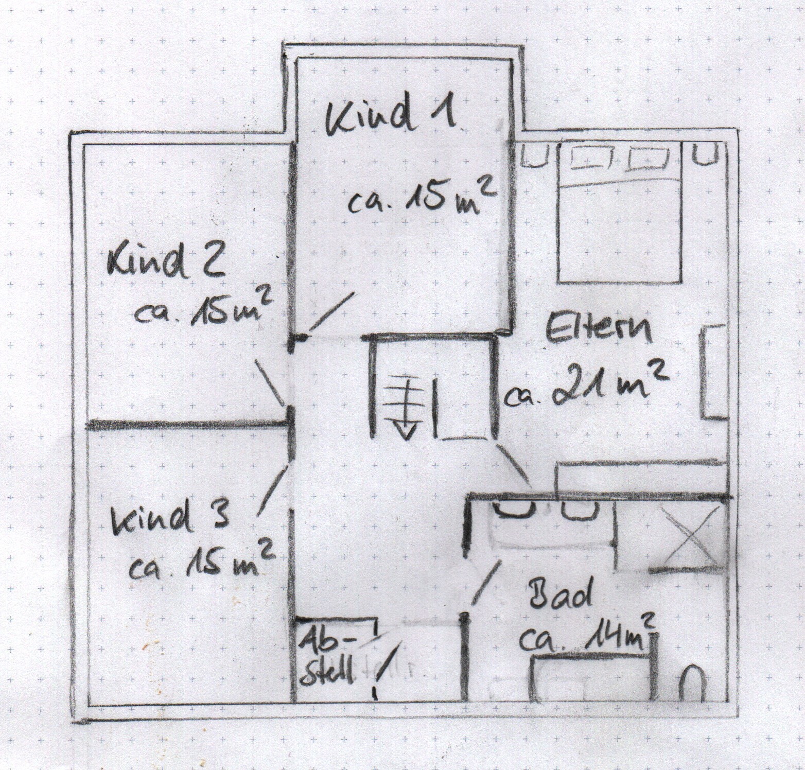

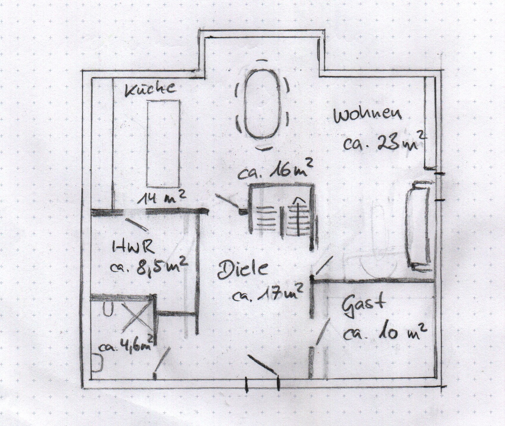

Is the room layout roughly okay? How do you see the building’s orientation on the plot? I would like to position the house close to the street line at 5 meters (16 ft) and have the entrance facing the street.
I would actually prefer the bathroom on the opposite side and the children’s room where the bathroom is now, but due to the stairs I have no other way to do this.
I don’t like the door to the living room where it is, but I would like the option to go to the toilet in the evening in comfortable clothes without having to pass by teenagers who might be eating in the kitchen. Any ideas?
The stairs probably won’t fit dimension-wise anyway...
And will the upstairs work out okay with the roof slopes? The Danhaus has a dormer, but that doesn’t fit with my upper floor layout, does it? Although the bathroom could be a bit smaller, then it might work, right? Although I wouldn’t build the dormer like that anyway, as otherwise anyone coming from the street can see us going to the bathroom...

The “inspiration design” is already the wrong base model here, since the number of children's rooms doesn’t match. Also, it appears you considered the stair shape a design gimmick of the catalog home, but it is actually crucial to the functionality of the design. In a house of this size, you automatically create bottlenecks if you change seemingly minor details, like reversing the stair direction. This might affect only two square meters per floor primarily, but the consequences reach further.
In the end, you should set aside any hope of achieving a similar price with a house design inspired by a catalog home of roughly the same exterior dimensions. Nonetheless, a catalog home as a base model is not automatically wrong for you, but you must consider its specifics. The key issue is the third children’s room, which most catalog designs do not offer. There are mainly three ways out of this dilemma:
A: Choose a house design that offers a variant like "trade a study for a smaller living room," as is commonly done by, for example, Town & Country;
B: Build a catalog home as an “extended version,” meaning insert a full room along the ridge axis into an otherwise unchanged base design. This affects both floors, so the trick also works with a base model that normally has only one children’s room (e.g., Town & Country: Raumwunder 90);
C: Use a “country house” design and modify the attic into a full-height upper floor (“town villa”), so the usually knee-wall areas become usable standing space. To gain a full room, you will need to widen the house by about one meter (approximately two grid steps).
With ALL these more extensive modifications, the final price will inevitably move further away from the original base catalog home price!
You have already made a significant change to the catalog design in one crucial aspect: the bathroom location is now completely different. This has consequences not only for the soil and waste pipes and related drywall cladding, but also for similar entanglements in the layout of the ductwork for the mechanical ventilation system. This is a classic issue when trying to rearrange major elements without changing the building footprint or outline! (And the same problem will certainly “come back to haunt you” with a different base model but the same approach.) The consequences are always the same: 1. bottlenecks, 2. distortions in the ceiling penetrations and related components, 3. drywall weaknesses.

In the Danhaus, there are actually three children's rooms on the upper floor; my intention in rotating the staircase was more about the living room—I just wanted it to be a bit more private and have its own door.
We are visiting the show home there anyway at the beginning of October, so I can take a look then.
But I understand your concerns and will try to look into it further.
What do you think in general about the orientation of the house and the rooms on the plot?

I think the design is very good for a first attempt. The problem, as you suspected, is probably the staircase, which is undersized. But it’s not unrealistic to build it this way or something similar. What looks great with just three lines on a plan can quickly become very large once you add proper walls and a staircase. That will put pressure on the budget.
Another questionable aspect is the orientation. At the moment, the layout is more like an I shape rather than an L. In my opinion, the living room is far too long, and you end up hiding behind the staircase to avoid seeing the kitchen. However, the space to the right of the dining table is useless and wasted.
The entire house faces southeast – which means the kitchen will be as dark as a cave in the evening.
If you want an L-shaped layout anyway, then plan it accordingly and rotate the house (like the current house on the site). Put the kitchen in the bay window area for plenty of southern light and the living space facing the garden. This will save space and money.
