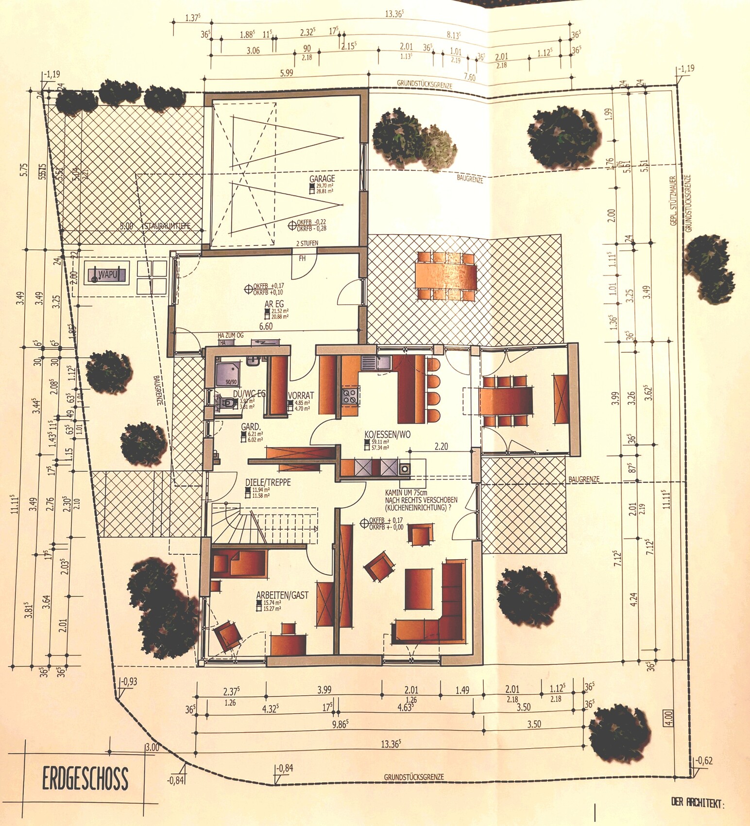

The floor plan is very practical (for example, the pantry is close to the kitchen and garage, utility room on the upper floor where most laundry accumulates), our corner windows in the "garage gap," which provide a great view over the fields, our light-filled dining area overlooking the garden, the parents’ area because we find the bathroom-dressing-bedroom layout very nice and practical, location of the coat closet: hidden but easily accessible from both the front door and the garage

Absolutely! Architects appreciate every project that isn’t generic and doesn’t end up being a house where you can tell what the rest of the rooms look like just by standing at the front door. That’s why I don’t think this design is all wrong. I wouldn’t dismiss it but rather examine it critically, identify what works really well, and what doesn’t.
For example, I really like the solution for the transition between the kitchen and living room—the kitchen opens onto the dining area and isn’t completely separated from the living room either, but you’re not staring from the couch across the dining table directly at the stove and sink. The design creates a sense of intimacy on the ground floor with semi-open rooms. I think this works well, especially considering the dimensional details.

Thank you for the positive comments! We actually thought it was great too and were proud to have a truly unique floor plan that was entirely based on our own ideas. We invested many hours, built cardboard models, created our own 3D floor plans, and so on. But of course, we overlooked some points, and correcting those now will probably be very difficult. Maybe it’s best to let the architect take over from here without us overthinking everything again beforehand...

The garage remains and will have a roof with a basement replacement room/storage room.
The current storage room will be reduced by half in size and will house the technical room and pantry (two separate rooms). The kitchen will be located in this area, opening to the terrace; the current kitchen will become the dining area with windows facing south and southwest.
The restroom will switch places with the staircase. Additionally, the front door will be moved further up the plan, near the staircase. This way, it will connect to the technical room/pantry with a large hallway and cloakroom space, and provide access to the kitchen and dining area. (The dining area will be semi-open to the staircase?)
The bay window is not necessary but could serve as a design feature, extending half a meter to one meter (about 1.5 to 3 feet) deep and as wide as the bedroom requires. However, it should not divide the already small plot.
The office and living room will remain. Note that the restroom is now also near the guest area/office.

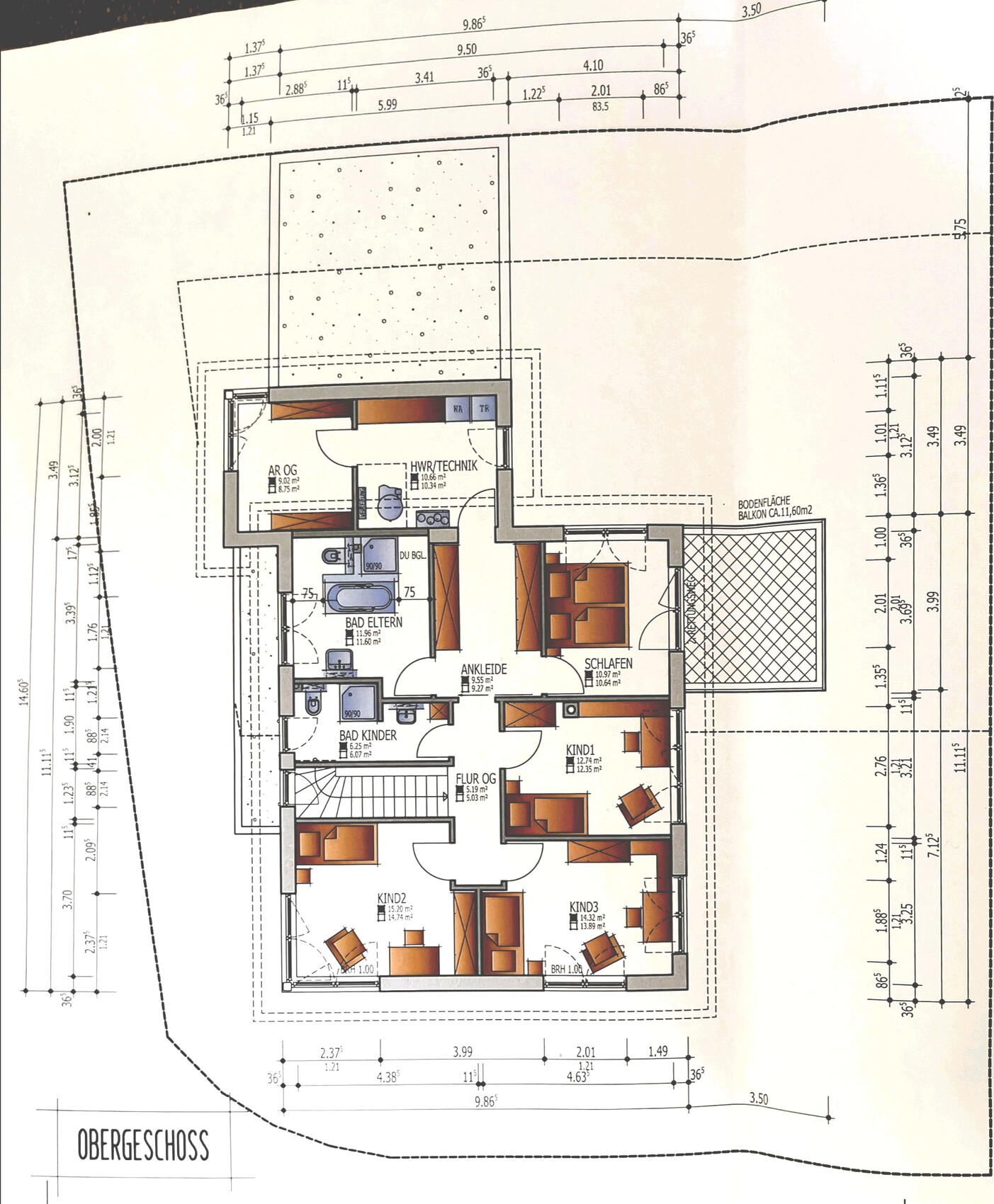

Upstairs, the children’s bathroom and staircase will switch places. However, it should be considered whether a children’s bathroom is necessary. The children’s rooms could stay, perhaps slightly smaller... (one room could be straightened a bit...)
I would place the children’s rooms on the south and west sides, facing the garden.
Where the children’s rooms are now would become the parents’ area. When entering the bedroom, the bed should be visible; no south-facing window.

Set the garage slightly apart from the main house.
This will save quite a bit of floor area. The storage room counts as part of the garage 😉
