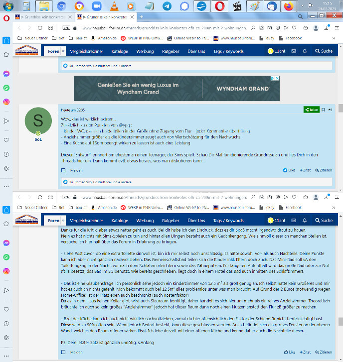

ThomasMagmar24 Feb 2023 15:16SoL schrieb:
The residential units are not considered separate because the ground floor unit does not have its own bathroom; instead, the bathroom is accessed from the shared corridor. Each door from the ground floor corridor into the unit would have to be an apartment door, not just a regular interior door.
You don’t see it because you don’t have any knowledge of the subject and haven’t studied it.
That’s not necessarily a bad thing—I have no clue about paragliding, so I simply don’t do it. Or if I want to try, I hire an instructor.
Applied to residential buildings and floor plans, the instructor is an architect. And they create functional floor plans. That’s what they studied. I don’t disagree with you, although I don’t understand the reasoning behind that definition. If the stairwell were outside the building, would the ground floor still not be considered a separate unit, or would the construction not be allowed as such?
That’s exactly why I’m here—to gather experience. The more issues that can be addressed and improved beforehand, the better. And it’s not like I’m jumping straight into a paraglider; I’m starting with a simulation.
ThomasMagmar schrieb:
The height of ingratitude is not even being able to quote properly and making false accusations.Nonsense, see attachment.ThomasMagmar schrieb:
I can give you a tip as well. If you think you are funny, no, you are not.At least I'm always humorous—only until the helping hand gets bitten. And goodbye!https://www.instagram.com/11antgmxde/
I’m only ever amused for as long as the helping hand isn’t bitten. And goodbye! - Then show me a comment from @SoL in between. This was a reply to his last comment.
- So far, I haven’t really received any help from you; all your comments were just bashing or making fun of me with others. If you like to criticize others so much, you should also be able to accept some criticism yourself.
It’s not about what criticism you make, but how you present it. For example, you can describe something as “unsuitable/inappropriate” or as “sh...” Even though I appreciate and am grateful for the feedback, as I said, I get the feeling that some were just aiming to put me down. You’re probably right. But here, some posts are polite and kind, trying to bring you closer to reality, yet you remain resistant. You shouldn’t be surprised if eventually people start wondering whether...
Number of people, age: 2 adults + 2 children ... you might be one of the children and your parents don’t know what you are doing.
The biggest criticism I received was regarding the partition wall in the bedroom and the “children’s bathroom.” On both points, I can understand the concerns and negative aspects. It’s simply the highlight of the whole design that can’t be taken seriously here. It may be harsh, but if someone suggests installing a sliding door above a double bed, I seriously question their common sense.
That’s exactly why I’m here—to gather experience. The more issues that can be fixed or improved in advance, the better. And it’s not as if I’m immediately going paragliding; I’m just trying out the simulation. Reading or asking questions doesn’t equate to gaining experience, only knowledge. Experience comes from practical application.
But knowledge is also not gained when a layperson tells the expert how things are, without listening to or trusting the expert.
If you want to paraglide, you need to study the theory first. Only then do you go to the training field.
What you’re doing here is dreaming about the sport, then trying to tell the experienced pilot on the field why he should ignore safety precautions and change things according to your opinion. Right before takeoff, you argue why your naive view is better.
And no, it’s not bashing to directly say that something is ill-conceived, doesn’t work, or is poorly executed.
