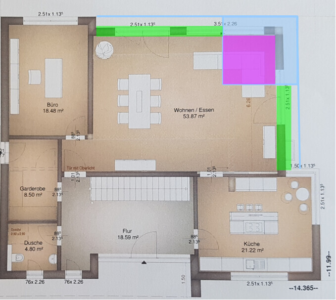

Secondly, this would mostly eliminate the need for supporting beams entirely, and firstly, you wouldn’t lose any floor space: what would be lost under the laundry drying balcony would be regained to the right through the outward shift of the exterior wall* under the upper floor’s area again. Overall, the total floor area would remain neutral. At least the corner window wouldn’t suffer any loss anymore due to the bay window projection being only half as wide, possibly sacrificing the entire bay, but you were already considering that.
I also thought about the saved effort regarding the supporting beams. That would solve a whole lot with one move.
However, I can’t quite understand how no floor space would be lost, with what’s lost under the laundry drying balcony coming back through the exterior wall shift on the right. I don’t understand that at all. Sorry.
11ant26 Aug 2017 21:35
R.Hotzenplotz schrieb:
However, I just can’t understand how you don’t lose any floor area that would be beneath the laundry drying balcony and then supposedly recovered on the right side by shifting the exterior wall. I don’t understand that at all.
Large floor plan of a house: kitchen, living area, office, hallway, cloakroom, and shower with furniture.
blue: line of the upper floor wall layout, laundry drying balcony
pink: floor area loss in the living room if the wall layout below and above is the same and the terrace is under the balcony
green: floor area gain from the same adjustment
Result: roughly neutral overall.
