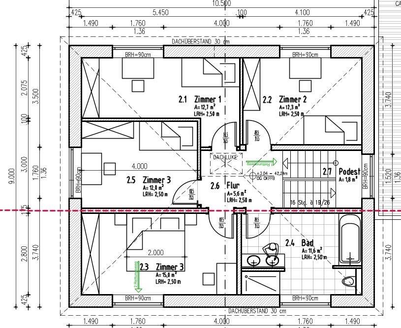

after going through a few more rounds and working hard on the floor plan, we would like to present our latest design.
We are quite happy with the layout and proportions, but we still have some issues with the windows. We definitely need to make some adjustments there.
At this point, we would really appreciate any further feedback! Is there anything else you notice or would like to point out?
Thanks again!
Floor plan: open ground floor, living/dining, kitchen, hallway, guest room, bathroom, utility room.
Floor plan of the upper floor with rooms 1–3, corridor, bathroom, and landing (dimensions).
K a t j a22 May 2024 06:23
Who did you work with? I don’t see any positive progress – quite the opposite. What are these pipe shafts supposed to be? It’s outrageous if that was done by a professional.

L
leschaf
22 May 2024 09:18
I don’t think it’s very good either. In the office/guest room downstairs, there’s no space to place a wardrobe or something similar. Also, only one person can really sleep there, right? How does it work with the grandparents (a larger bed doesn’t really fit, and at the back in front of the window you could only get in from the front because the room is so narrow)? The kitchen probably has too little storage for five people, and there’s no space for storage anywhere in the entire living/dining area without blocking walkways. The same goes for the utility room because of the large window. By the way, with a family of five, a drying rack with laundry that can’t go in the dryer will likely block the path from the secondary entrance 90% of the time.
If you only have overnight guests 2-3 times a year, I would consider, depending on the location of the house, either investing in a good sofa bed or asking the grandparents to stay at a hotel overnight (we did the same in our last apartment, with a hotel practically next door). Then both desks can fit into a better-shaped office (I find it more pleasant atmospherically to have background noise from others instead of working in the bedroom), and you can save some width upstairs in the bedroom. This is also possible in the bathroom, where there’s at least one wasted meter in the middle.
