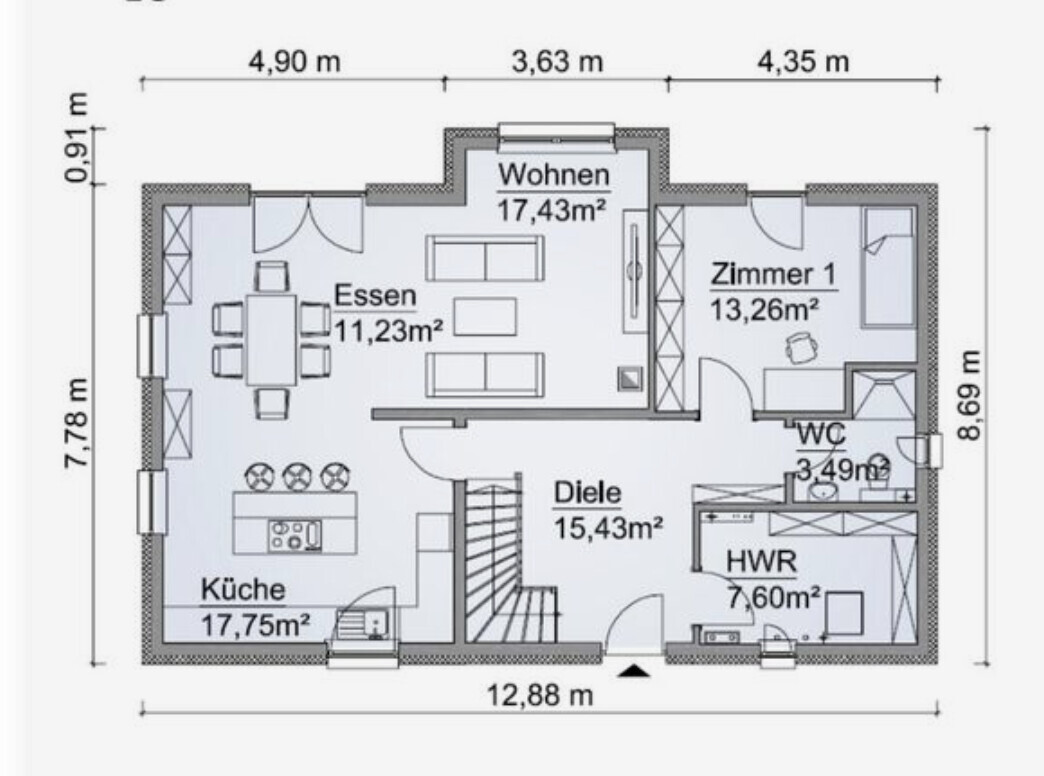

Bertram100 schrieb:
I can’t give an example, I’m not able to plan.Just copy it from the internet? I don’t think stairs require less space in other countries.
Schorsch_baut7 Jun 2024 08:14Oh yes, they are really quite steep. I have worked in Utrecht and Amsterdam, and I was really wary of the stairs in the houses there. If they were two degrees steeper and 1cm (0.4 inches) shorter, they would have been ladders.
haydee schrieb:
@ypg and with a crutch, laundry basket, or baking tray, it gets really tight. My parents have been cursing their only 75 cm (30 inch) door for almost 40 years.Yes, I wouldn’t go into any storage room carrying a laundry basket or baking tray either. For example, this is why I would curse kitchen pass-throughs leading to the pantry if they were through cabinets.Schorsch_baut schrieb:
Oh yes, but it’s really tight. I have worked in Utrecht and Amsterdam, and I dreaded the stairs in those houses. If they were two degrees steeper and one centimeter (0.4 inch) shorter, they would have been ladders.Yes, extremely space-saving designs don’t hold up well today. That’s why builders try to give stairs in new homes a little more than the minimum required dimensions. There’s no need to take old houses in London, Amsterdam, or other dense city centers as examples when better alternatives exist.S
Schorsch_baut7 Jun 2024 11:02There is a lot to learn from old houses when it comes to space management. Nowadays, we often see attempts to fit floor plans from the low-interest-rate period into significantly smaller layouts without wanting to make any compromises.

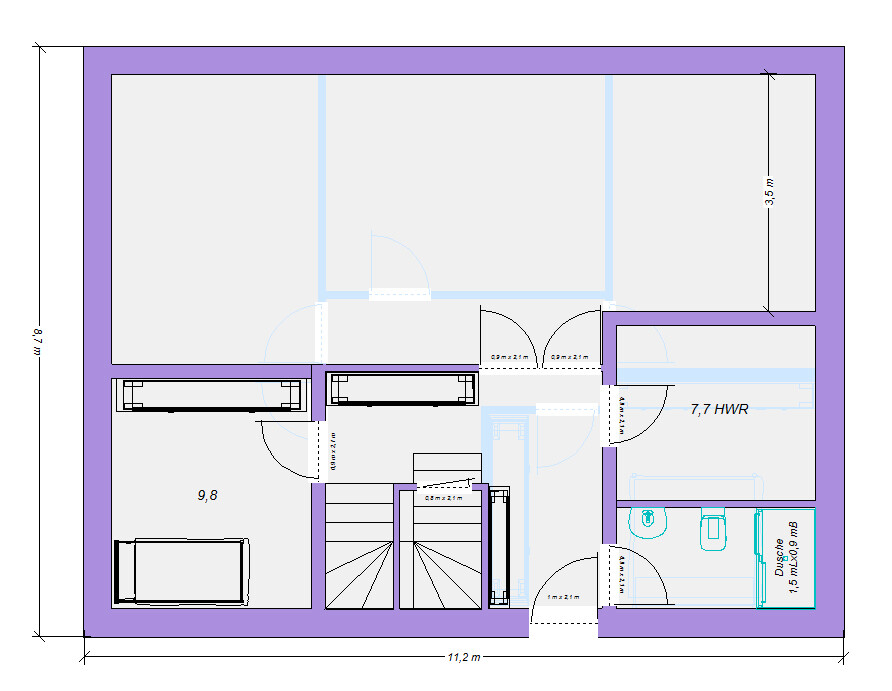

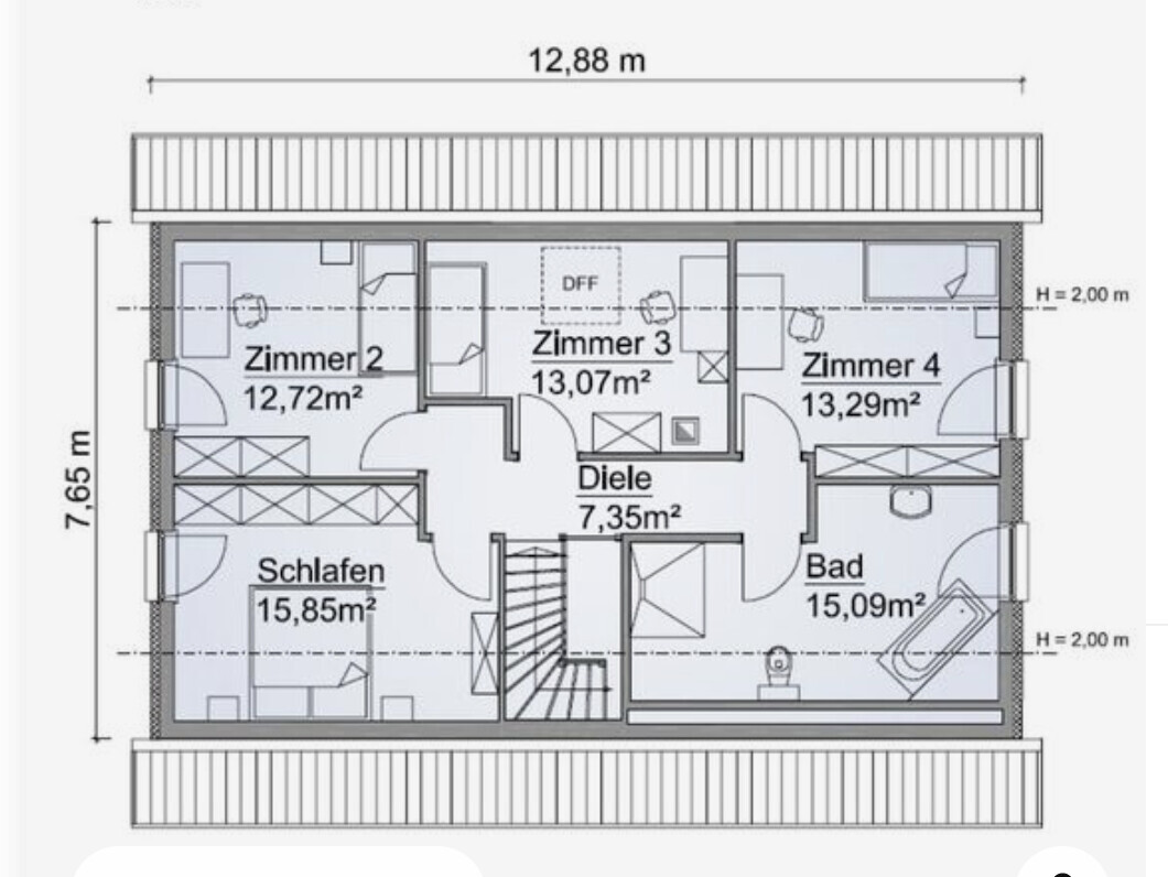

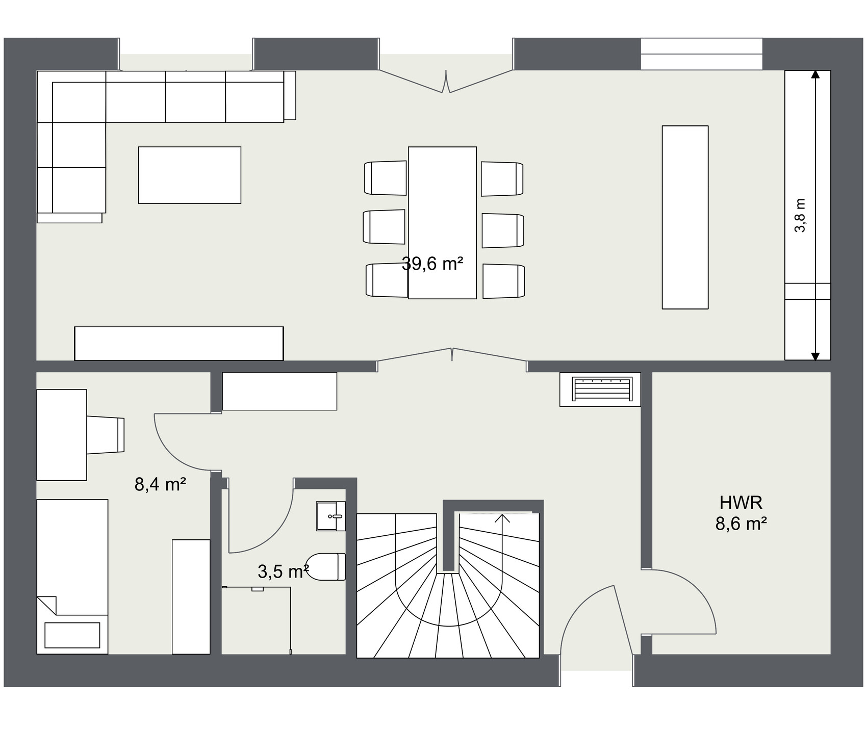

Schorsch_baut7 Jun 2024 11:04K a t j a schrieb:
I can’t really imagine how this is supposed to look.
150 sqm (1,615 sq ft) with 4 bedrooms, a guest room/office, guest bathroom with shower, and a large utility room, plus 2 home office spaces – honestly, I’m surprised you don’t also have a pantry and a sauna on your wish list. Will that 8 sqm (86 sq ft) kitchen really be enough for you in the long run? And the bedroom closet – can you even stand in front of it and open it properly?
So I took the basic idea and organized it a bit. Even though I went with a depth of 8.7 m (28.5 ft), only a 50 cm (20 inch) wardrobe fits. The utility room at 7.7 sqm (83 sq ft) will probably seem too small to you, but I think the 3 m (9.8 ft) kitchen is even worse. I really wonder: Does this still make sense or would it be better to drop it?
Thanks first of all for taking the time to draw up a draft. That wouldn’t be bad. I always thought it made sense to plan the bathroom upstairs above the utility room?
Regarding the overlap of the toilet and staircase, here is a quick, incomplete sketch. The staircase stays in the same place, so no need to redesign the upper floor.
As for the other objections: Of course, we’re trying to fit everything into as little square meters as possible, but only the necessary rooms. I don’t think having a room for each child plus an office is excessive. Construction costs are high, but does that mean you should give up entirely? What’s the alternative? Nowadays, it’s hard to find an apartment that size, and there’s hardly any price difference.
