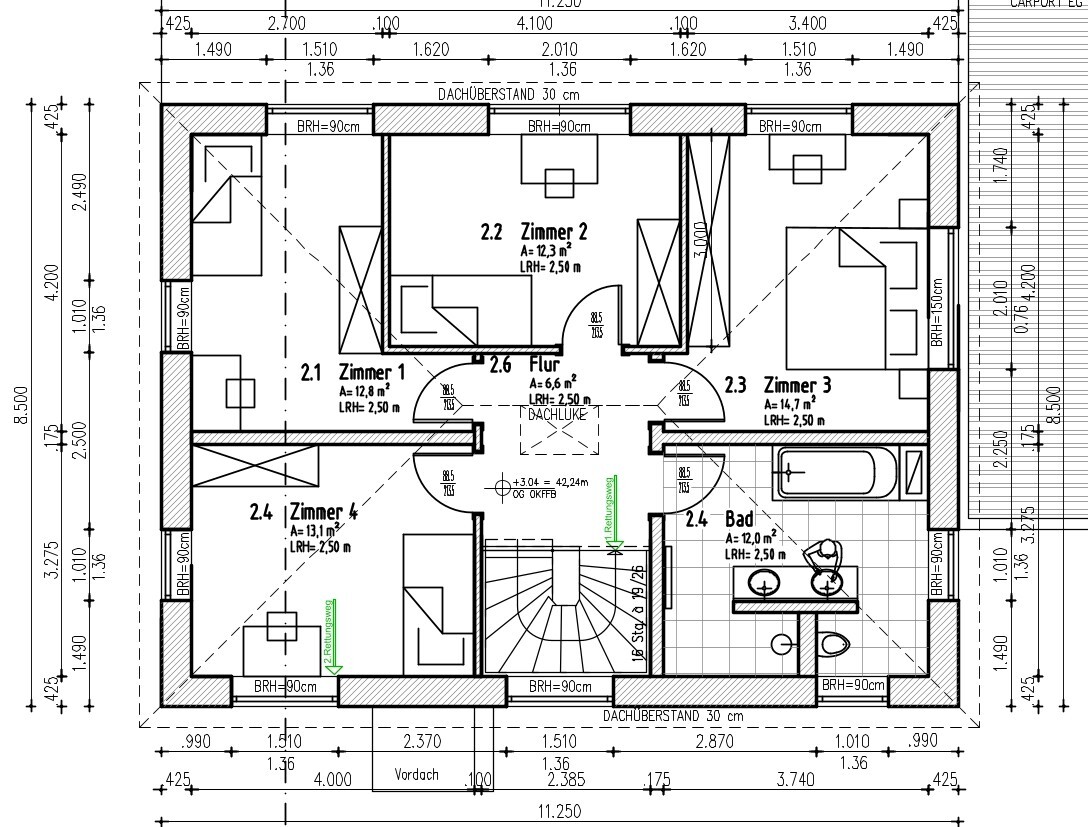

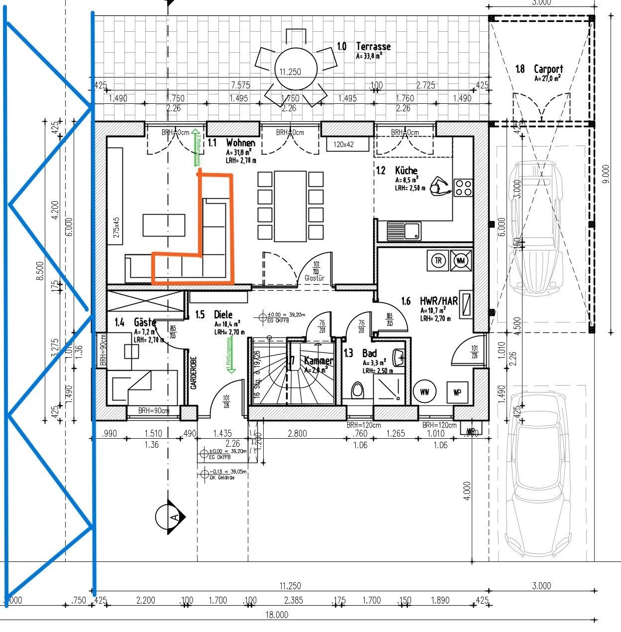

Hello dear community,
we are a family of five (2 adults, 3 children) currently planning to build a house. It is quite challenging to find a floor plan with 4 bedrooms plus an office/guest room while keeping the overall size affordable. We have already tested several layouts and would appreciate your feedback and comments. Our current plan is a compromise between construction costs and size. So our main focus is to get the most out of the available space. Of course, having more space would be better, but unfortunately, we are limited to about 160 square meters (1,722 square feet). We would like to use this floor plan to obtain comparable offers from home builders.
Thank you in advance!

Origin of the plans: self-designed based on several examples and inspirations from the internet. The windows are still placeholders.
We are unsure about the bay window. We have planned it to gain some extra space for the dining table, especially when guests come, as we can easily have 10 people. Additionally, it helps to fit in the 3rd children’s bedroom better. The question is how the cost of a bay window compares to simply increasing the overall floor area. Maybe someone here has experience with this. Also, if other arrangements might exist that use the space more efficiently.

Ground Floor
Upper Floor

Schorsch_baut22 May 2024 12:06I don't like the kitchen. With the L-shape and the window layout, you end up facing walls at all the work surfaces.
I wanted to provide an update here. We have made progress with the planning and have adjusted the ratio of the floor area. Overall, we are quite satisfied with fitting everything into a relatively small space of 145m2 (1560 sq ft). The guest room is rather small but should be sufficient for our needs. We are still undecided about the kitchen. As currently planned, the storage space is not enough, so we are considering alternative layouts for this.
What does the blue zigzag line on the left side of the plan represent?Sorry, I forgot to mention. It is meant to indicate the driveway to the property in the background.
Bertram10031 May 2024 08:07JKL_2024 schrieb:
