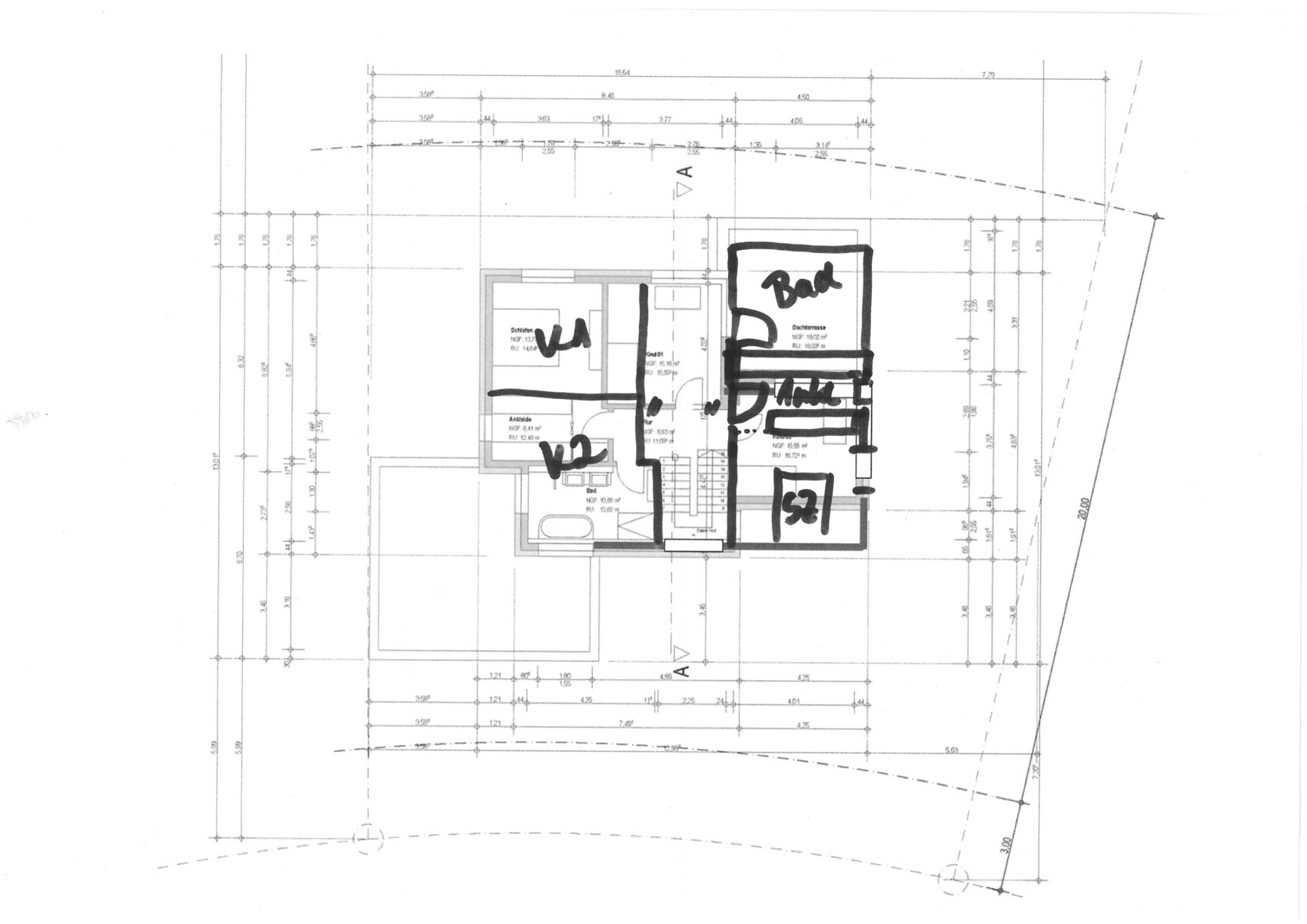

Rough sketch based on Romeo’s layout:
Var. 1:
I like this layout best, but the downside is that all the plumbing would need to be installed separately.

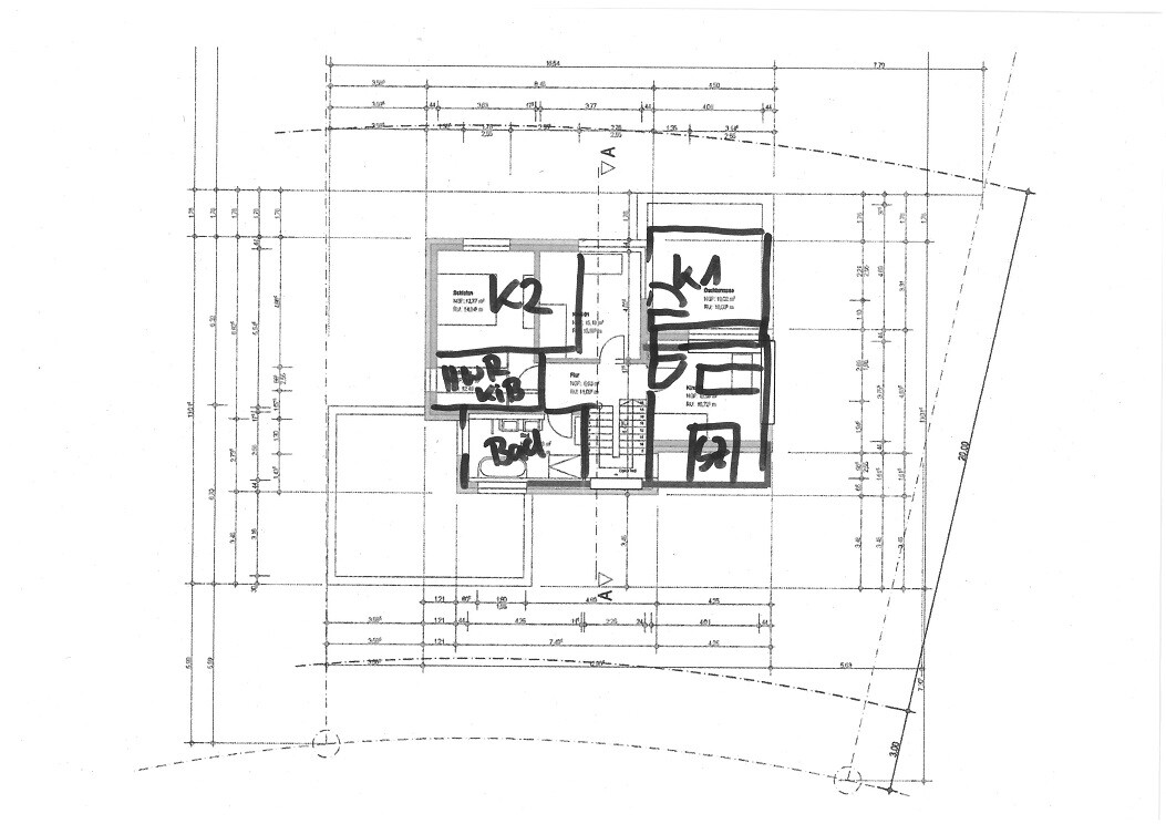

Var. 2:
Here, the children’s bedrooms are quite equal in terms of location and size. The bathroom could remain as is; a utility room/children’s bathroom could be added, or you could have a very large family bathroom and possibly even a sauna. Personally, I would prefer a utility room with a washing machine and dryer.
Advantage of both variations: the hallway receives natural daylight.
Var. 1:
Var. 2:

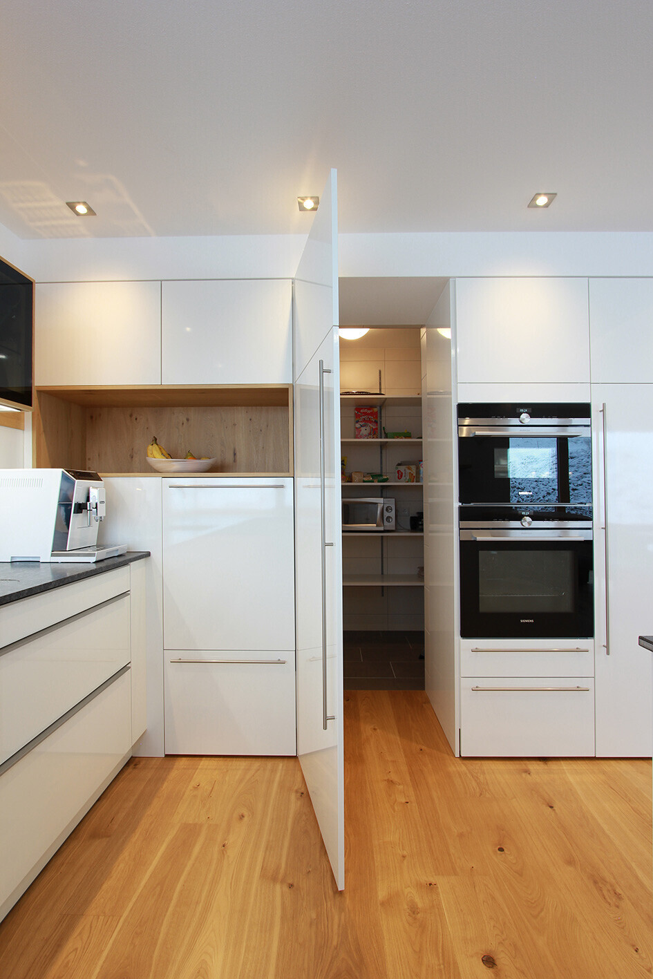

The pantry is not large, that’s correct. We once saw an example of a pantry integrated into the kitchen, visually incorporated into the full-height cabinets. Here is a photo:
We would actually like to realize something similar in our kitchen. We do have a “large” pantry with sufficient storage space in the basement (which is not a topic here).
