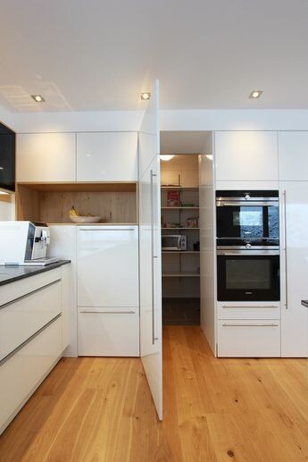

The niche on the ground floor is actually meant to be a small cloakroom.
I kind of suspected the issue with the stairs. I also believe that a half-turned staircase would use the space better?
The pantry is 1 meter deep (about 3 feet 3 inches), so with 30cm (12 inches) deep shelving on both sides, there would be a 40cm (16 inches) aisle. Yes, that’s narrow, but the idea was to maximize storage space and minimize wasted space. A freezer is not really planned to go in there yet.
If kitchen cabinets are placed on the wall with the pantry access and the entry is through a cabinet, the problem of the inward-opening door size disappears. (Example image attached.)
Opening the pantry to the utility room is actually a good idea. The reason for separating it so far was just to have more walls to place things.
On the other hand, you can also bring groceries directly from the garage to the storage area and then into the kitchen.
Yes, I also find the layout in the utility room rather unfavorable, but the access from the garage is undisputed. And one wall of the utility room must face the front, otherwise an additional 1,000 euros in water connection costs would arise.

Have you ever tried moving water crates or using a step stool in such a tight pantry space?
