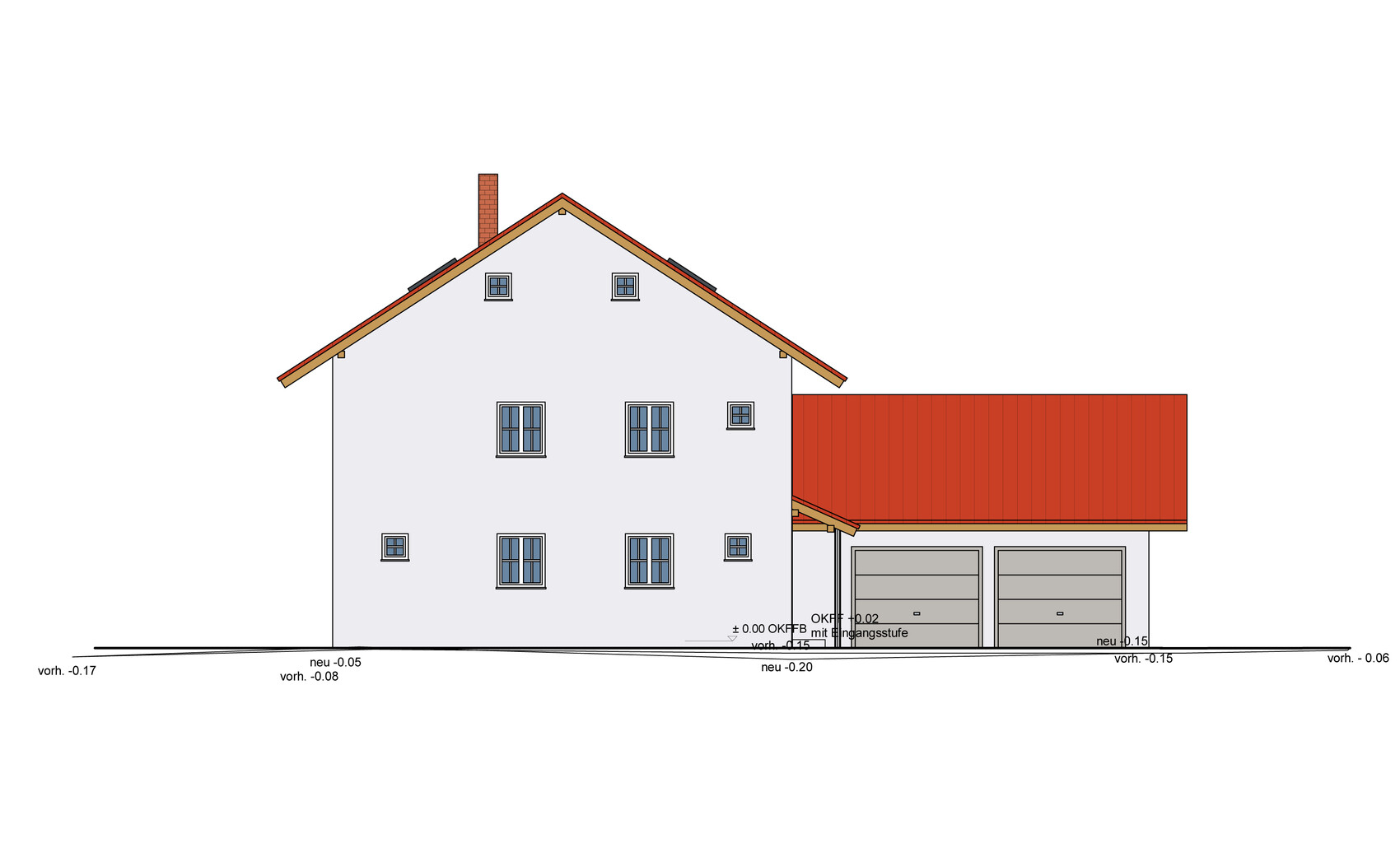

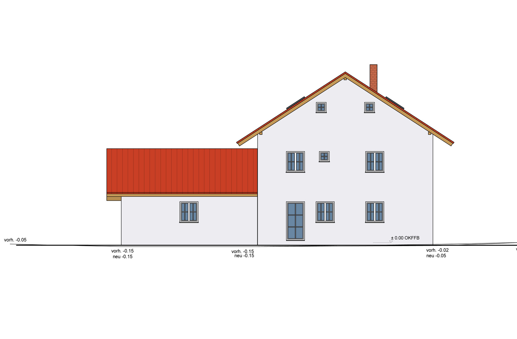

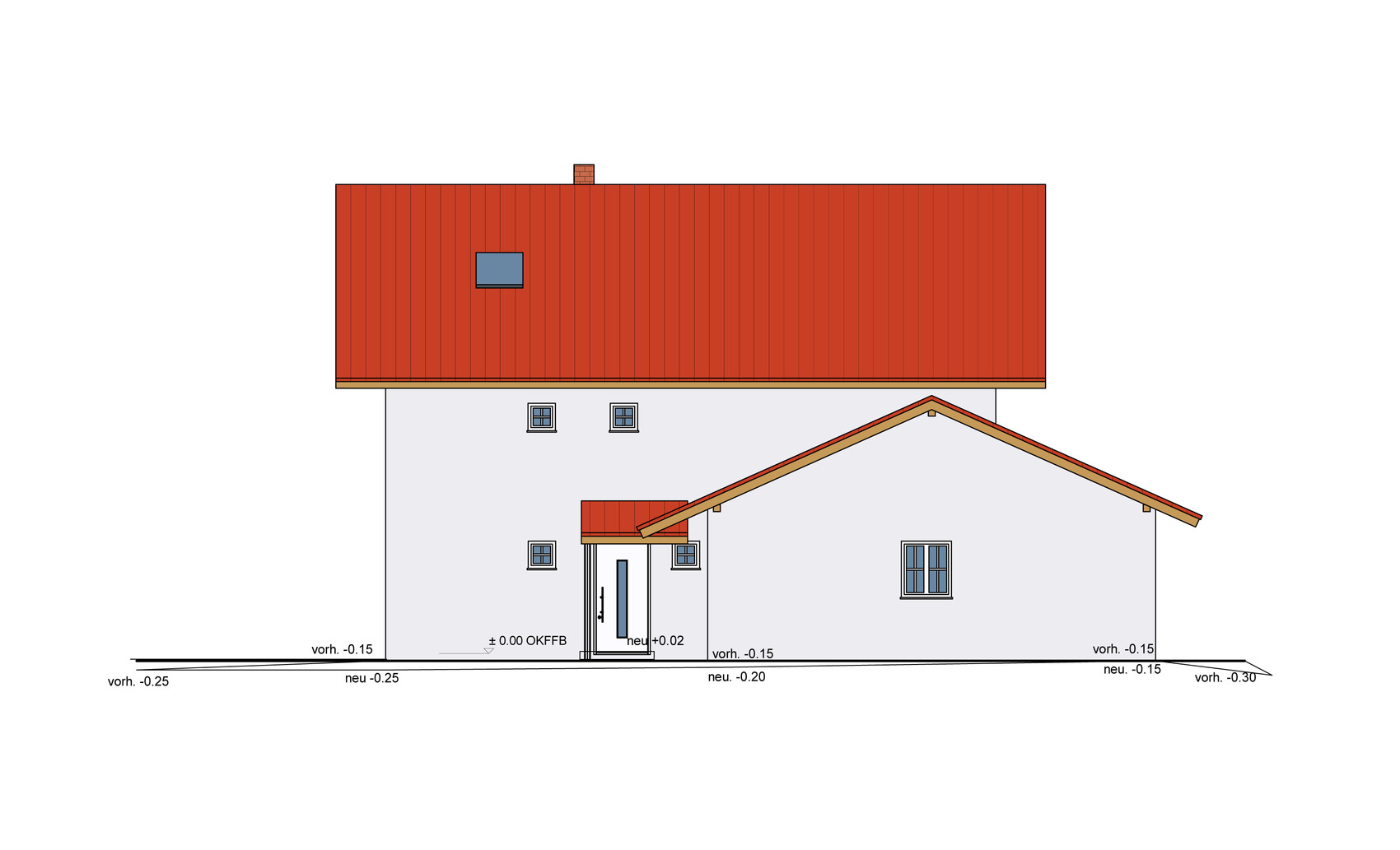

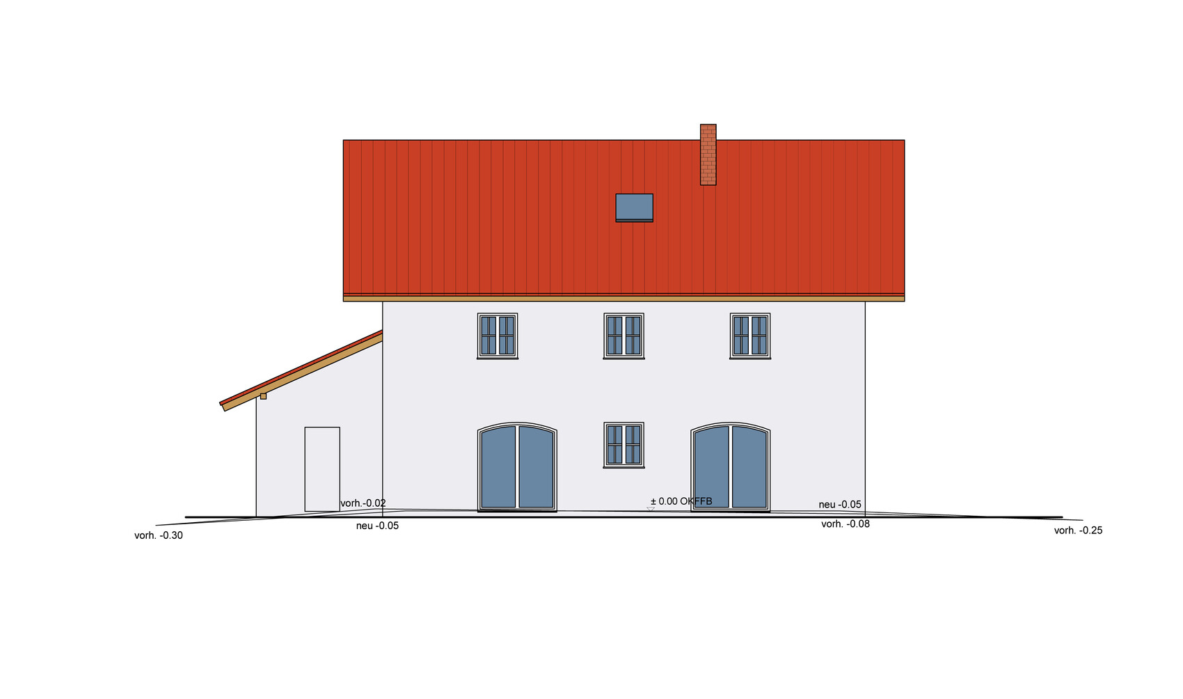

Phew – first of all, thank you very much for your opinions.
I overlooked the draft for the upper floor; it really is quite small. I’m uploading it here again.
In our opinion, the entrance to the shower and toilet is not that tight. The doors in our current house are not wider than 73cm (29 inches) in some rooms, including the toilet.
Is the bedroom better now? It is certainly more spacious. We probably just got carried away with the idea of a "walk-in" closet.
Regarding the small windows: on the north side of the house, there is a fairly busy ring road. That’s why we have small windows here. In our opinion, they fit quite well with the desired building style because the reveals there will be plastered at a steep angle.
The dining area is deliberately not placed in front of a large window. A residential street runs along the east side, and personally, I find it uncomfortable to sit with your back to a large window. A small window lets in light, and there should be enough sunlight on the south side.
The open space between the dining area and the sofa is currently just a play area for our kids. Between the two terrace doors there is a sideboard, and opposite that is the fireplace. Here’s another photo of that. Above the hearth seating area, there is an old window planned that looks into the hallway; this will mainly serve a decorative purpose but will also provide light. The doors in the kitchen and laundry room will have frosted glass panels. I don’t think darkness in the hallway will be a problem.
We are aware, and it is intentional, that everyone passes through the kitchen to get to the living room. We are not the kind of people who constantly have a mess in the kitchen. This is perfectly fine for us.
